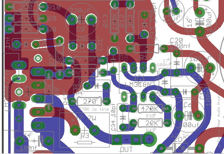

BTW I think the problem lies in the PCB layout, Mauro original one was different and none of his graph shown that glitch, if I remember correctly.

This, IMHO, points to the PCB layout again...
See the attached magnification of TP board, the V+ trace overlaps LM3886 output trace so there is a capacitive coupling (I hope the term is correct) between them.
It's for that reason that in the Fremen Edition I've differently routed V+ trace.
Also, OUT connector is very close to the compensation network so, possibly, the higher capacitance of the alternate compensation helps somewhat...
