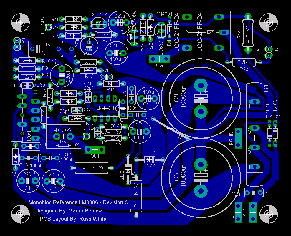

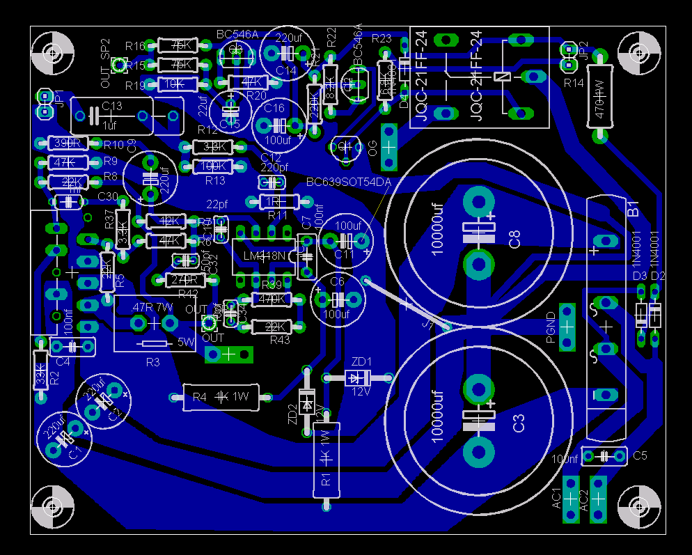

This ought to keep you and CarlosFM happy Ed. 🙂
I added bypass caps from rails to GND for both opamps. I hope Mauro approves. 🙂

bg40403 said:Could we have pads on the PSU legs for a small (5mm space) poly bypass cap?

Sorry to have been away and not respond. I'm at the local (though 200 miles from home) library and sufferin' with sticky mouse buttons. Click heels and say: "There's no place like home, there's no place like home, there's...
Russ, your latest revision fills the bill. (C17 & C18) Audio Express included in a recent issue (May, 2005) an article on the benefits of proper selection of caps in a power supply. A group of three different caps for filtering provided superior results. An addenda to that article is here:
http://www.audioxpress.com/magsdirx/ax/addenda/505StamlerTables.pdf
Also, my question about the location of the LM3886 seems to have been addressed...so that alteration of the board or heatsink is not required.

You are saying you would like pads for smaller C3/C8? That would have to result in a pretty significant circuit alteration (what are thinking like 1500uf?) I would think, but hey, I have no objection to seeing how it looks. Wouldn't 7.5mm be reasonable?

Thank you Ed, One cannot help but remember. 🙂
So I suppose you like C19 and C20 as well?

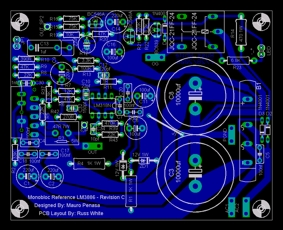

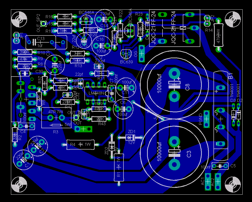

One more chance to get your input in 🙂
I have not heard any feedback except from Ed on the last layout, so it must not be too bad. 🙂
I spent an hour or two this morning tidying things up, and increasing the size of some pads, and moving a couple of caps around.
Here is how the layout looks right now.
Russ,
I think you should etch a couple of those and see how they sound!
Looks great. Good to watch the evolution of this board!
What does Mauro think?
M.
M.
Good to go!
I've been saving the different iteations and this is the best one.
Any problems with someone else making a copy?
I can do it from the posts through photoshop. Or you can be absolutely generous and post it as a PDF.
