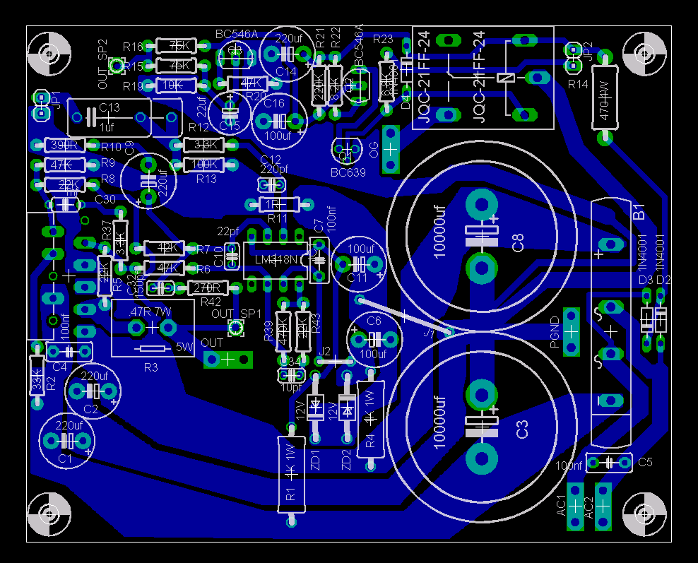

Quick comments in no particular order (I am supposed to be helping test a Beat release...)
-Can you move the trace (R1-ZD1-C11) a little to the left, then twist C6 clockwise and align it with C11. You might have a little more room for R4 and J3 pads that way.
-Keep in mind that insulated Fastons are fairly wide, and will probably bump into the components near them, specifically C3 and C8, B1, and the relay.
-Looks like you are planning on using a vertical (radial) cement power resistor(?). I think it would be a good use of space if you are looking for a small board.
-Probably a little late to change, but you could use the Panasonic mini metal film resistors. Not very expensive and very small. Could give you some more flexibility in layout.

1) OK, sounds good.
2) Yes, valid concern, but I measured and they should be OK.
3) Yes, I have some of those, and I thought they fit well.
4) Hmmm, hadn't considered it, since I already have all the metal film reistors I need in the standard size... I think it may be best left that way to keep it more flexible, since you can always use a smaller leaded part in a bigger space, but its harder to do the opposite.

Shift C1 & C2 down and to the right. They could also be brought into symmetry (forgive my analysis).
This provides "working" room for R2 & C4.
Following in the path of Brian about C6; R39, R43 & C34 can be shifted left, providing more room for traces (with a longer J3).
Have you limited the area on the heatsink side of the LM3886 for heatsink mounting?

Ok Bg,
Did you see my last post? I shifted the things around C6 to the left a bit, and as it is now there is plenty of clearnace between everything, but I will work on it some more tomorrow.
As far as C1 and C2 I will see what I can do there, there is only so much I can do based on where I need to run the power traces.
You are saying you would like pads for smaller C3/C8? That would have to result in a pretty significant circuit alteration (what are thinking like 1500uf?) I would think, but hey, I have no objection to seeing how it looks. Wouldn't 7.5mm be reasonable?

Not sure what you mean here. I have it so the LM3886 will sit flush against the heatsink when the pcb is touching the heatsink. There is no "extra" PCB behind the LM3886 like the REV A boards have. I would be glad to add it if you think it's a cool feature. It does make the board very stable on the heatsink when you place in a slot.
