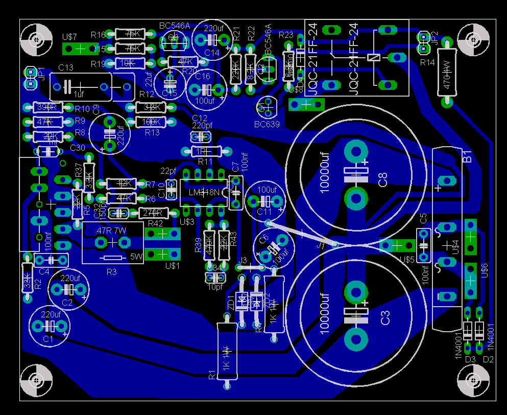

Carlos,
I built my amp from a PCB I had made, and I am selling those as a group buy. No I am not selling PCBs from my layout. I will not do so until the prototype is thoroughly tested.
I am selling Mauro's "Revision A" layout which many have bought already.
As for my layout I see no compelling reason to do a double sided layout with Mauro's design. I want it to appeal to those who want to buy board, as well as those who want to etch it themselves.

Got all my parts, time to finish matching them up, and start soldering. I use a LCR meter to match everything to 0.5% or better. The 0.1% listed for the 22K and 47K resistirs is tough, going to go with some old Holcos in the attic. My usual AB carbon comps drift too much for this level of matching.
One area of matching that is often missed is the zeners. They vary a lot. For this circuit, all four 12 volt should be matched up to 0.1 volts or so.

Good quality relays are expensive. You should check that all contacts are silver or gold plated.
Carbon comps shouldn't be used in audio, even if some valve die-hards still say so. Drifting is certainly a problem when you need 0.1%. Best thing is to start with 1% metal-films and fine select them to 0.1%. What kind of wire terminals they have is also a question to look after, as newer Holcos now have steel terminals.
What I don't understand is what zeners are you talking about. If you mean to power the LM318s, what you need are good quality regulators, at least 7X12. I prefer LM3x7s, but the x12s should do if you use proper capacitors at the output. Using zeners to regulate would be a serious compromise, IMHO.

Carlos,
I agree with you about the resistors, but on the supply for the LM318 you are missing the point. He is building Mauro's circuit, which calls for the Zener, and it what the PCB he has is designed for, beside the rail voltage is close to the maximum for the regulators you mention.
I brought up the idea of using regulators and Mauro quickly reminded me of that fact.

Sorry, but that is a point I very, very strongly disagree with Mauro then.
Zeners are poor in every respect for supplies: noise, regulation, reliability, etc. Not even the worst regulator will be as bad as the best zener.
A good supply is essential to a small signal, and the better the supply the better your audio will be.
If the problem is the high rail voltage, then use a regulator that will take it or lower it with a transistor controlled by a zener. But using a zener direct in such a sophisticated circuit is a very poor solution, as I see it.

Carlos,
I very much respect your opinion, and I must ask you forgive my ignorance as I cannot argue the point.
I have my own ideas of course, but I also know one fact for sure. The Revision A amp Mauro has designed is simply stunning in sound quality and noise floor.
I see no fault in the zener approach, and Maruo indicated that calculations he used were based on the effects of the RCZ net on the opamps. So I would not be too quick to discount its worth.
In any case, the point is the same, it is what the schematic is designed for, and what the PCB he has implements, and it is very good. 😀

Then that is probably an area that may provide further improvements to the sound.
It should be interesting to try one of your assemblies with a regulator instead of the zener.
BTW: what's important on a regulator is the difference between input voltage and output voltage. In a 3X7 that difference is about 37v, and nothing will happen as long as you put a protection zener in the control leg and/or between input and output, which will protect the regulator and not be in the regulation path. 7X12 are the same.
In Mauro's amp he uses +/-12v for the LM318, and +/- 35v for the LM3886. The 23v difference would make the regulator dissipate about 100mW, which is close to nothing. The LM318 can also use +/- 15v supplies, but I don't think that might bring any benefits.

Well, maybe this project deserves being looked at from a different point of view.
Maybe there's a fine balance that Mauro got to by tuning different approaches.
And maybe this power method he used, even if not what we are used to, IS part of that balance.
As in my case I plan to try this project, I will provide space for both powering methods and see where it gets me.

Hi Carlos,
I look for to explain in simple way my choices of PS.
But you recommends always to analyse in very detailed way this circuit, and to read all the comments of the thread , to understand the dynamicses of operation.
I usually build the circuits (by other ) in way extremely "believer" and eventually only "after" appraise the merits and the defects. Suggestion of don't "study ameliorations" before have a total follow-up of the circuit.
Sincerely is an little annoyed of has to it justify mine select, simply because as says Russ, if so sound much well ( and costs less ) because change?
However I answers you:
Ihave not data that a group (expensive and bulky ) formed by 7812+protections is more effective in this circuit. I am instead sure that a active component introduces problems to resolve.
If you observes well all the circuit is "different" from the commune think of the forums. For example the cap among v+ and v- on LM3886 and LM318 is a choice ignored by all in spite of is the only well-curb ( and demonstrable ) technique of follow-up of the PS troubles for a opamp ( would be enough know the structure of a opamp!).
Because 12V and not 15V ( or 18V )? LM318 is not a line preamp, but it is the heart of the circuit. The output voltage of LM318 is proportional to the load current. In conditions of clipping, all this systematizes becomes unstable, because the general gain margin is extremely high. LM318 stretch to compensate the LM3886 clipping going into clipping to his time. With 12V I limit the swing of exit to +-11V about, that correspond to about 11A, that corresponds to the internal limit of LM3886. If I increase the swing increase the instability to the clipping. The PS to zener, if LM318 has an anomalous absorption on account of oscillations or clipping, reduces the voltage ( on account of the upsurge of current on the res.) and it maintains the chip in safety zone.
This circuit has a few of "elementary" and all the components have a "conventional" and "non conventional" role. If I want take an oath GC I buy the kit from BrianGT !
Excuse me for the outlet, Carlos, not it's your fault, but have had to write much ( too ) times the reasons of my elementary technical choices .
I would be able challenges to the commentators: build an circuit with this compares quality/cost if succeed!
Notices technique: I would not go at once on the rev3 without try the revA or his variations...

I think I almost have it ready to etch.
Ok, as some of you know I have been working on a monobloc "REV C" layout to prototype. Well I think I am close to having something to etch.
Could some of you please look it over to see if there any poblems. I am not interested in design/circuit changes, just problems with the layout.
Thanks!
Russ
Thanks!
Russ
