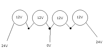

I have some 12V, 150VA toroidals, and I think that connecting them in series of 2 will give me 24V, 300VA. Am I right?
You would need 4 of them, all wired in series.
Unless they are all identical transformers, this may cause issues.
