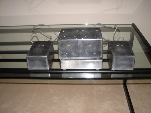

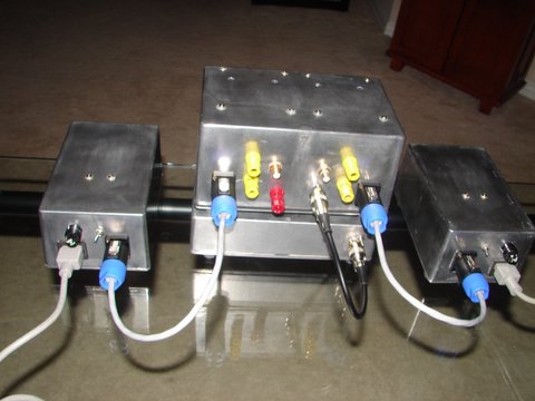

New one in operation
I read the glowing reports in the Absolute Sound of the Emitter II. Looking at it, it had to be the four chassis implimentation that gives it the reported great sound.
So to build my own, for 25,600.00 less money here is my version. The idea is the same. One chassis for active circuitry, two seperate output power supplies, a battery supply for the input stages.
I was able to save the 25,600.00 by purchasing my boards from TP!
