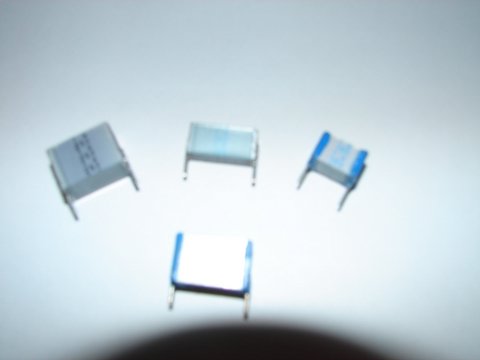

How about 1 ufd Seimens or Epcos
Brian,
A better part than the 1 ufd Wima is the stacked film and foil made by Siemens/Epcos. These are small also.
The middle one is a naked 1 ufd 100v. These are not very expensive. The going price on the lower one, a 2.2 ufd 100volt is 2.00. Inflation.
George
George -
What's the pin spacing on those? And who carries them?
I have had very good experiences with the Solens, and have a ready supply of them, which was why I was thinking in that direction.
PS: The issue with the Wima is that it's polyester, not that it's Wima. Just though I should point that out. Most prefer Polypropolene in this position.
Surplus
These are local pick ups. I think at least a couple hundred are laying in the bins.
I used to use the roll type caps also. These stacked film and foil seem better than any metalized film cap no matter what the dielectric.
I did not measure pin spacing, it drops right in the middle position of the new monoblock boards.
George

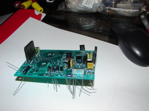

more pictures
People always like to see pictures of the finished product so here it is. The amp has been built to match my Kookaburra preamp shown here, and once again thanks to Tony D for selling me his parts.
It was hard to get a good picture of the front, but it is black anodized brushed aluminum, and the LED is purple. The XF is a Plitron 400VA, and don't ask how long it took to machine the corners of the heatsinks, because you don't want to know. Enjoy!
