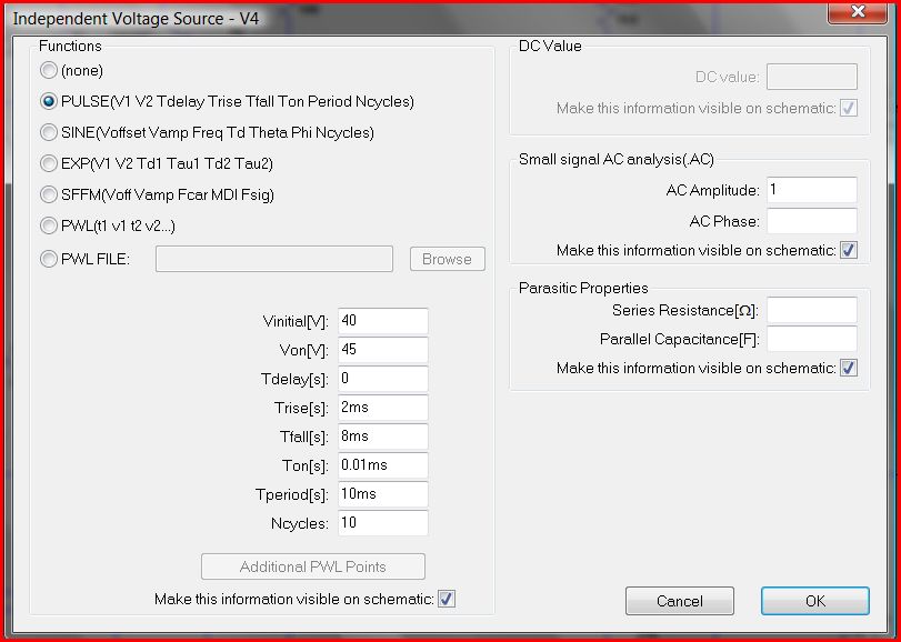

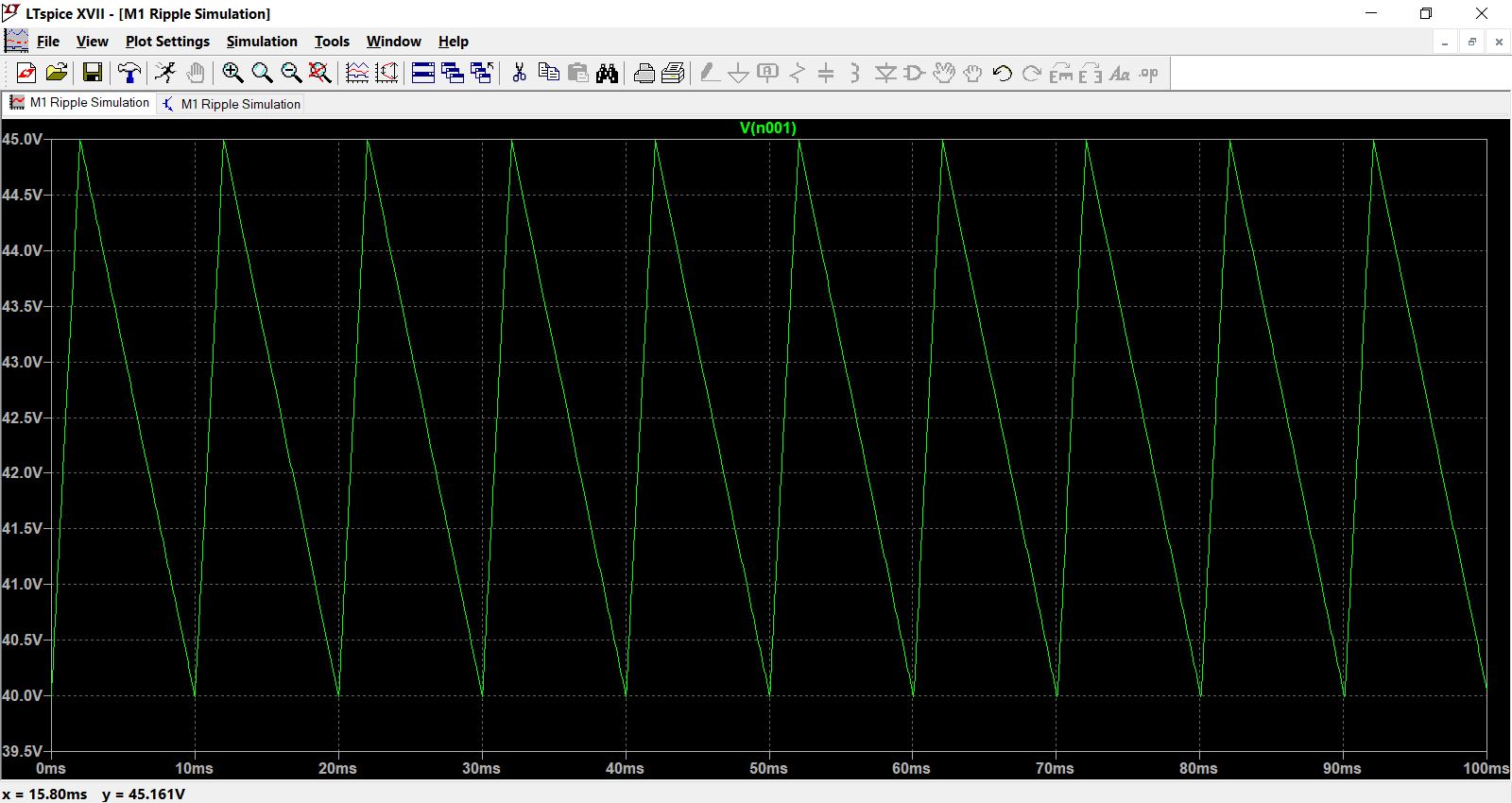

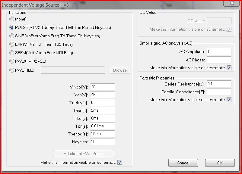

Simulating power supplies can be done a couple of ways. One method is to set each rail up as a voltage source that appears like ripple. The three images show the settings for a - and + 45 rail of fixed ripple. This can be useful for evaluating power supply rejection.
A second method is to add an AC voltage source and bridge rectifier to the simulation. Here I have used just 1000uF reservoir caps to highlight the ripple.

One thing to note, the ripple simulation is now exclusively a 'transient' type meaning that DC analysis (the .op command) does not work. This is because there is no fixed DC rails powering the circuit, they are derived just like the real thing from an AC source.
If you right click the two voltage sources feeding the bridge you will see how they are set up. Note the 180 degree phase shift for one of them. Here is the sim file. If you are using LTXVII then the 30 amp rectifiers may not be included in the model library... just pick something else that is.

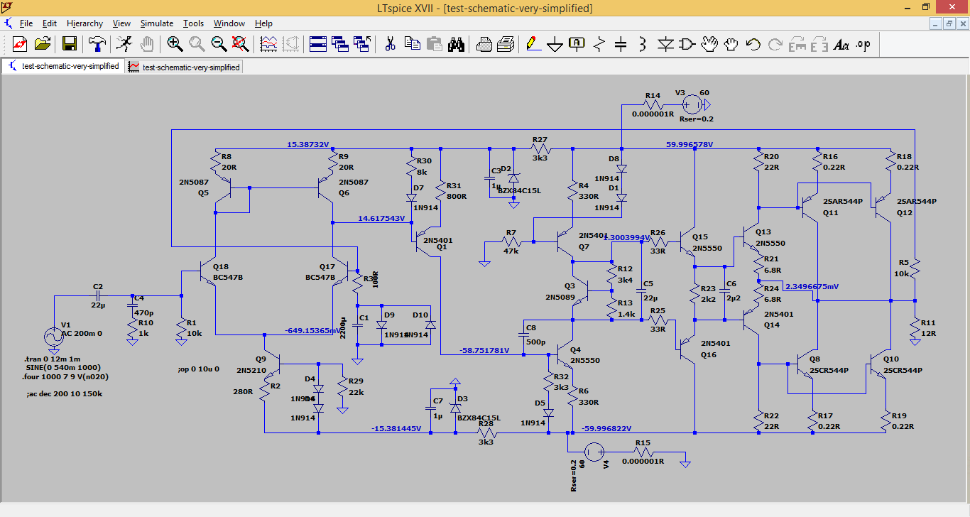

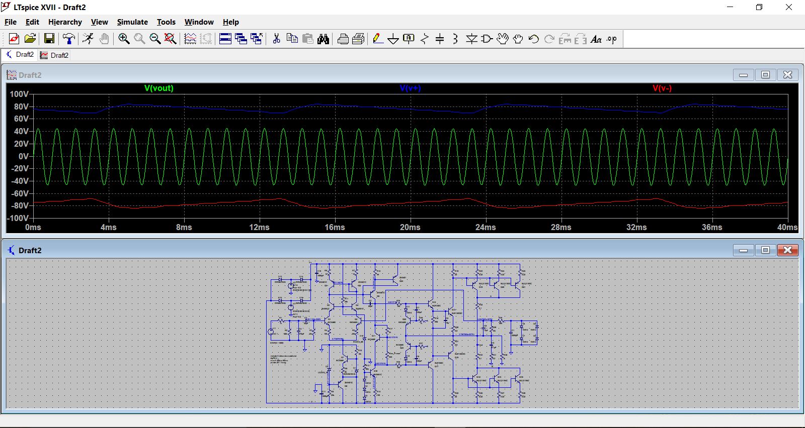

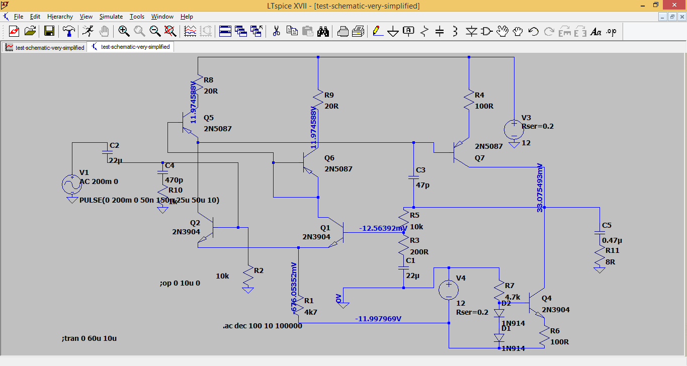

I am using LTspice to simulate a simple amplifier which I am designing for learning purposes. Feedback and suggestions are welcome and appreciated.
These are the screenshots from LTSpice.

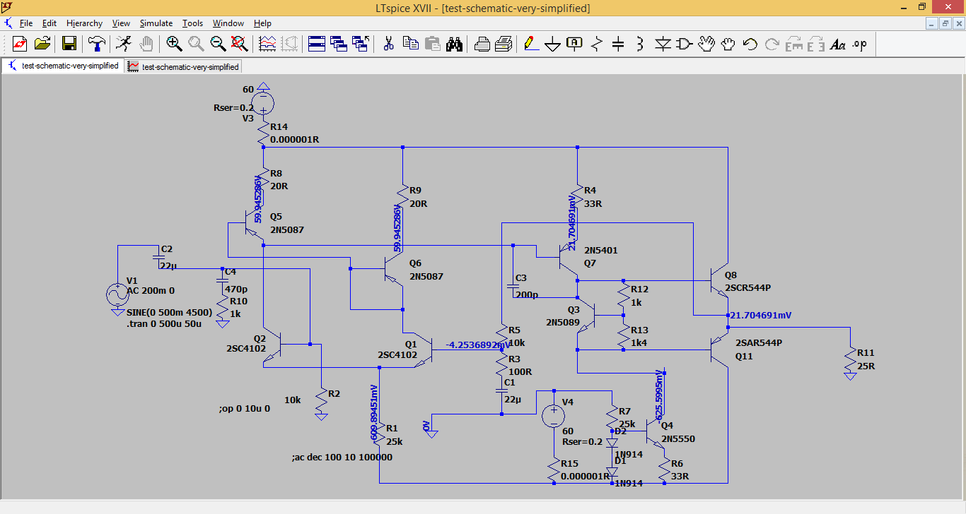

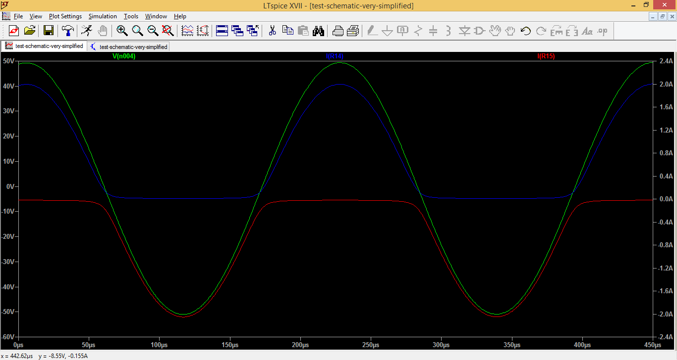

These are my results after increasing key resistors for the circuit to use +/- 60V DC. The simulation amplifier has been added an output stage that drives directly from the VAS. I know driving a large output stage directly from the VAS is rather naive, but there is nothing wrong in simulating an amplifier like that if it helps undestanding of key concepts.
The blue and red plots are currents from the power supplies. The blue plot is the output voltage developed across the output load resistance of 25 Ohms. The simulation frequency is 4500Hz. The thing that is exciting me is the 'nice' looking sine wave, which suggests distortion should be low, but how do I tell LTspice analyse for distortion?
The next step will adding more workhorses in the output to drive a proper 8 Ohm load and a driver stage.

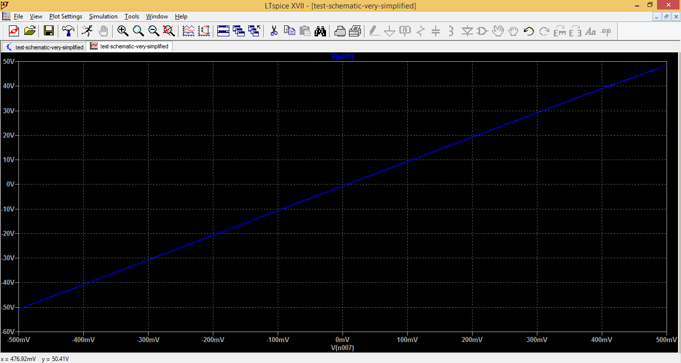

Here are two attachments with one showing output voltage VS input voltage and the other is the edited circuit with more power transistors.
The output VS input chart shows some hysteresis, that is, distortion as this is a deptarture from the theoretical line form. As can be seen, the distortion figure should be very low.

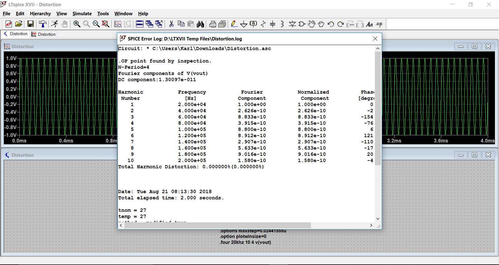

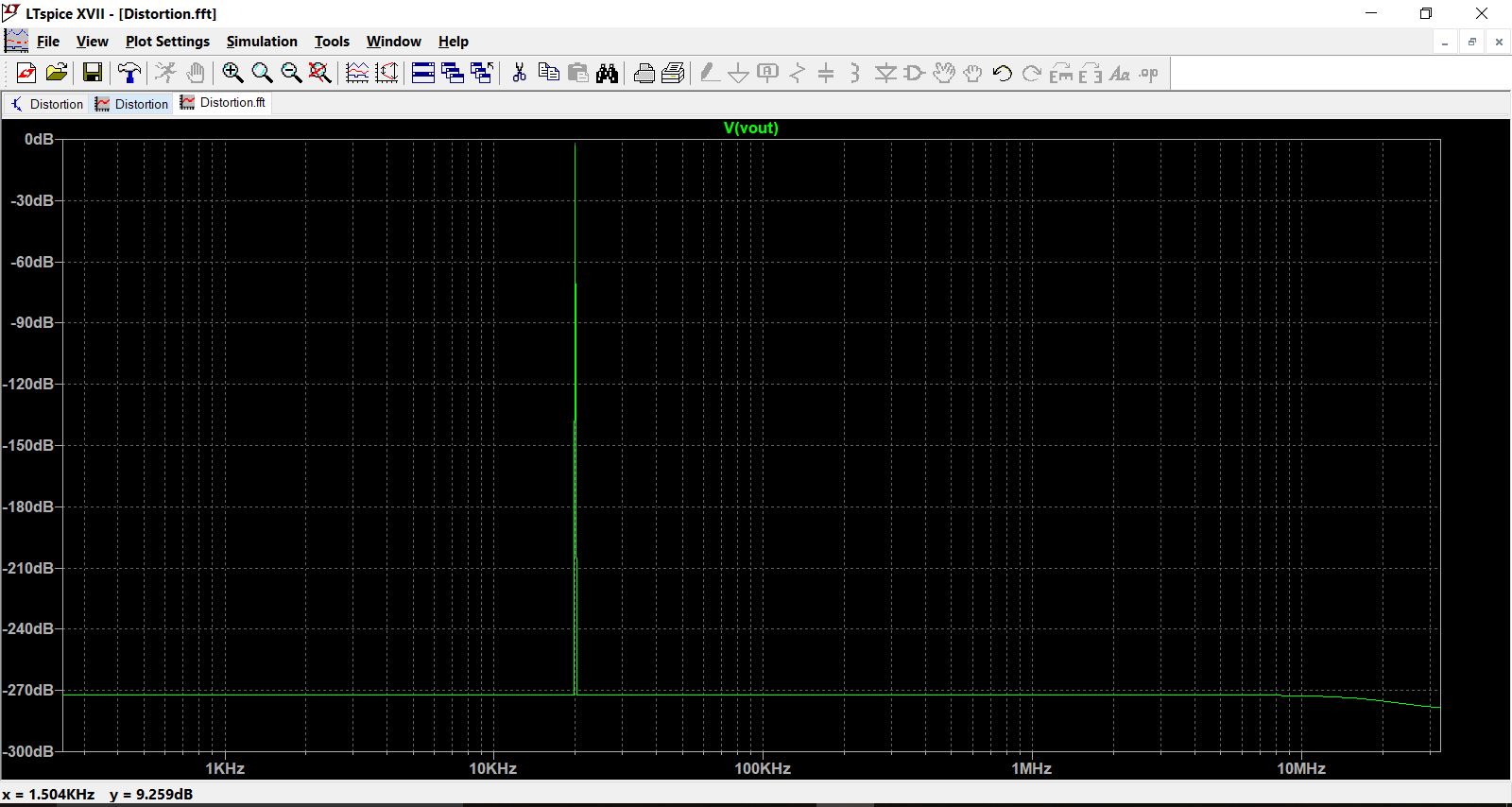

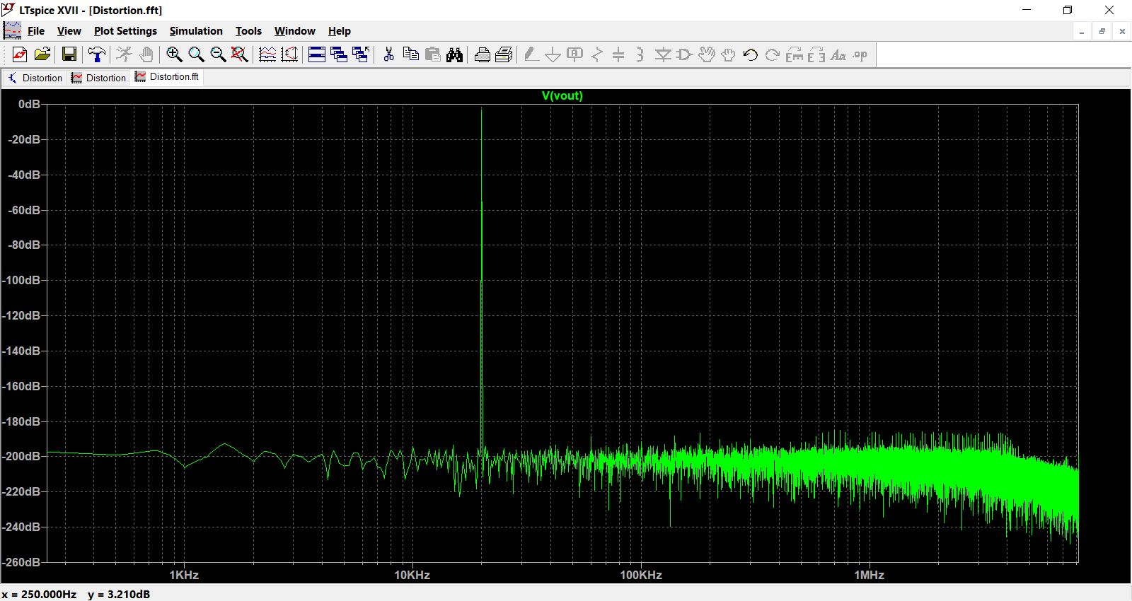

Have a look at this, a 20kHz voltage source and resistor (resistor isn't even needed actually).
We have added the commands to calculate distortion, and added the plotwinsize=0 to turn off compression.
Now I'll add a timestep. The simulation is set to run for 4ms and the FFT sample is at the default of 262144. Dividing 4ms by 262144 gives us 0.0000000152587890625 seconds. Now we'll paste that into the timestep window and run the simulation.
Finally another trick up our sleeve. We can add the command .options nundgt=7 which gives double precision to the calculation of variables. Again we run the sim. This is as good as it gets. The fundamental and nothing else. Distortion is 0.000000000000...…

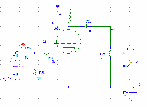

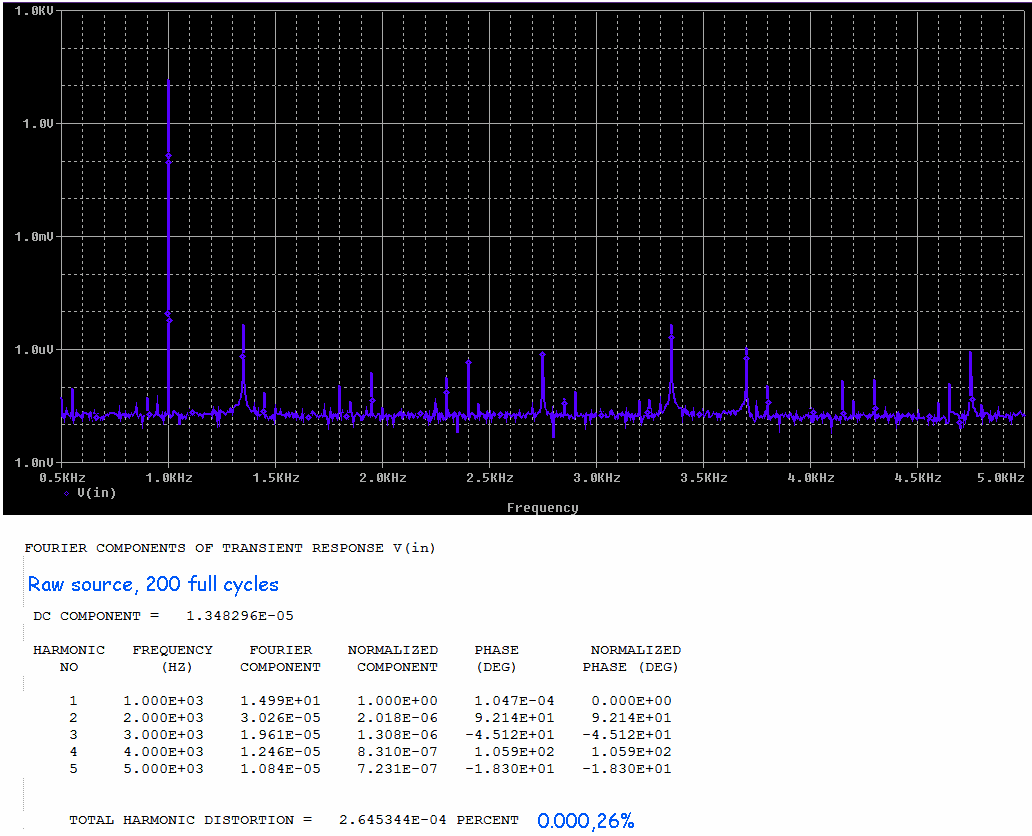

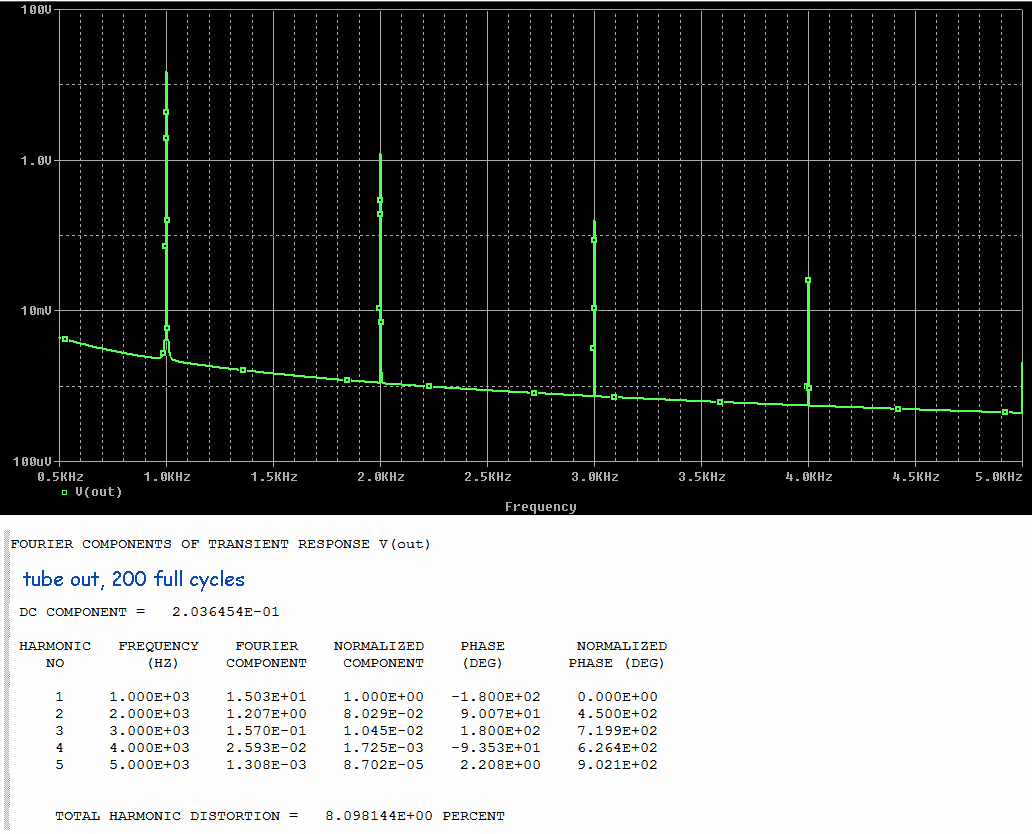

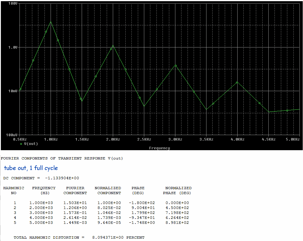

Here is a perhaps rude example. A vacuum bottle with a large drive and heavy load. Without SPICE I would expect 5%-15% THD (depending on drive level).
When I simulate over one cycle, I get a zig-zag plot and a plausible 8.1% THD.
The 1KHz 2KHz 3KHz 4KHz 5KHz peaks look plausible; the troughs between look to be sketched-in with a matchbook.
I increase the run to 200 cycles. The in-between, which perhaps should be zero, are now way-low and in fact are numeric "noise". (You see the same coarse/fine curves with spectrum analysis on audio signals; same Fourier formulas.) The total still computes to 8.1%.
As in analog THD measurement, we can't get cleaner than out sine source. What is SPICE giving me??
Not 700% but zero point three-oh something.

To visually see distortion I plotted the input versus the output. For a non distorting amplifier, this should be a straight line passing through the Cartesian origin (x, y) = (0, 0). LTspice produced a neat straight line as described implying the distortion was very very low.
