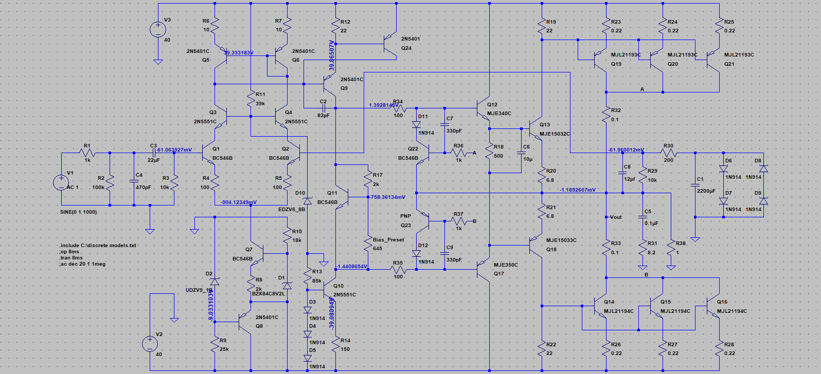

Here is the simulation file in case you want to have a play. I changed a few things to get a reasonable performance as there were severe performance limitations when squarewave testing.
You will need to rename the text file of models and add it to the simulation in place of the one I used.
Good luck 🙂

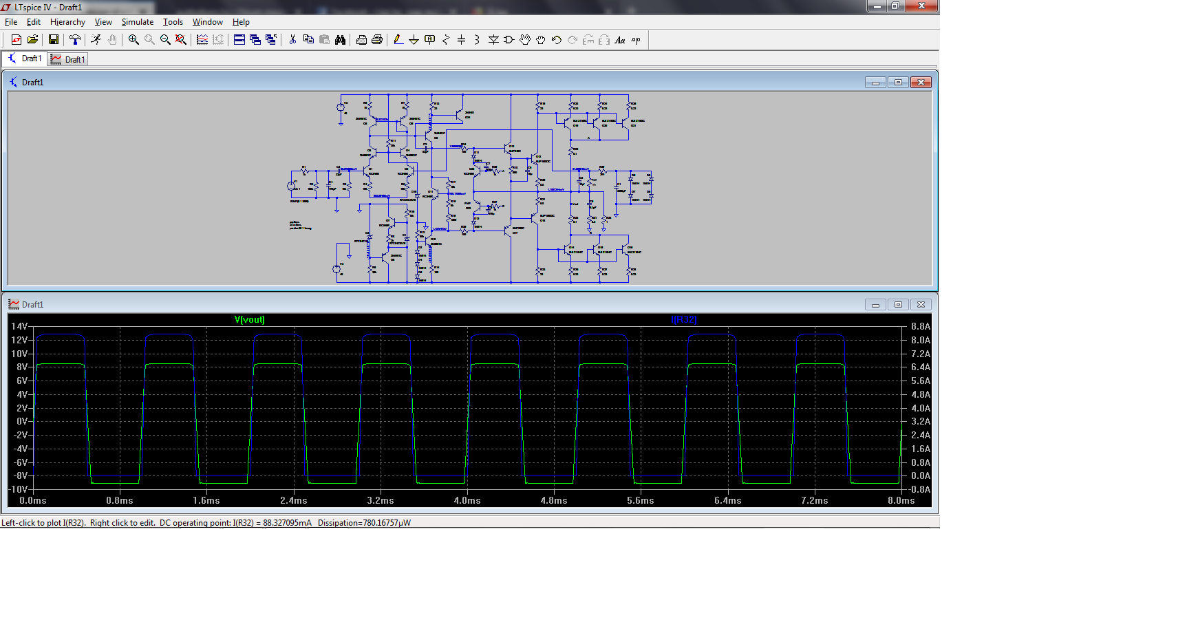

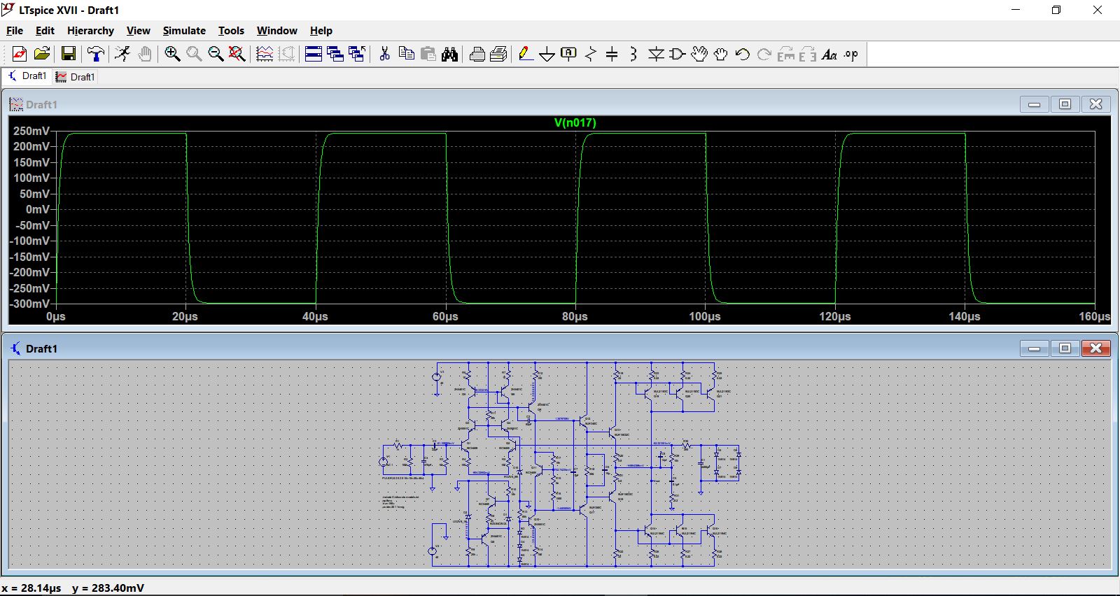

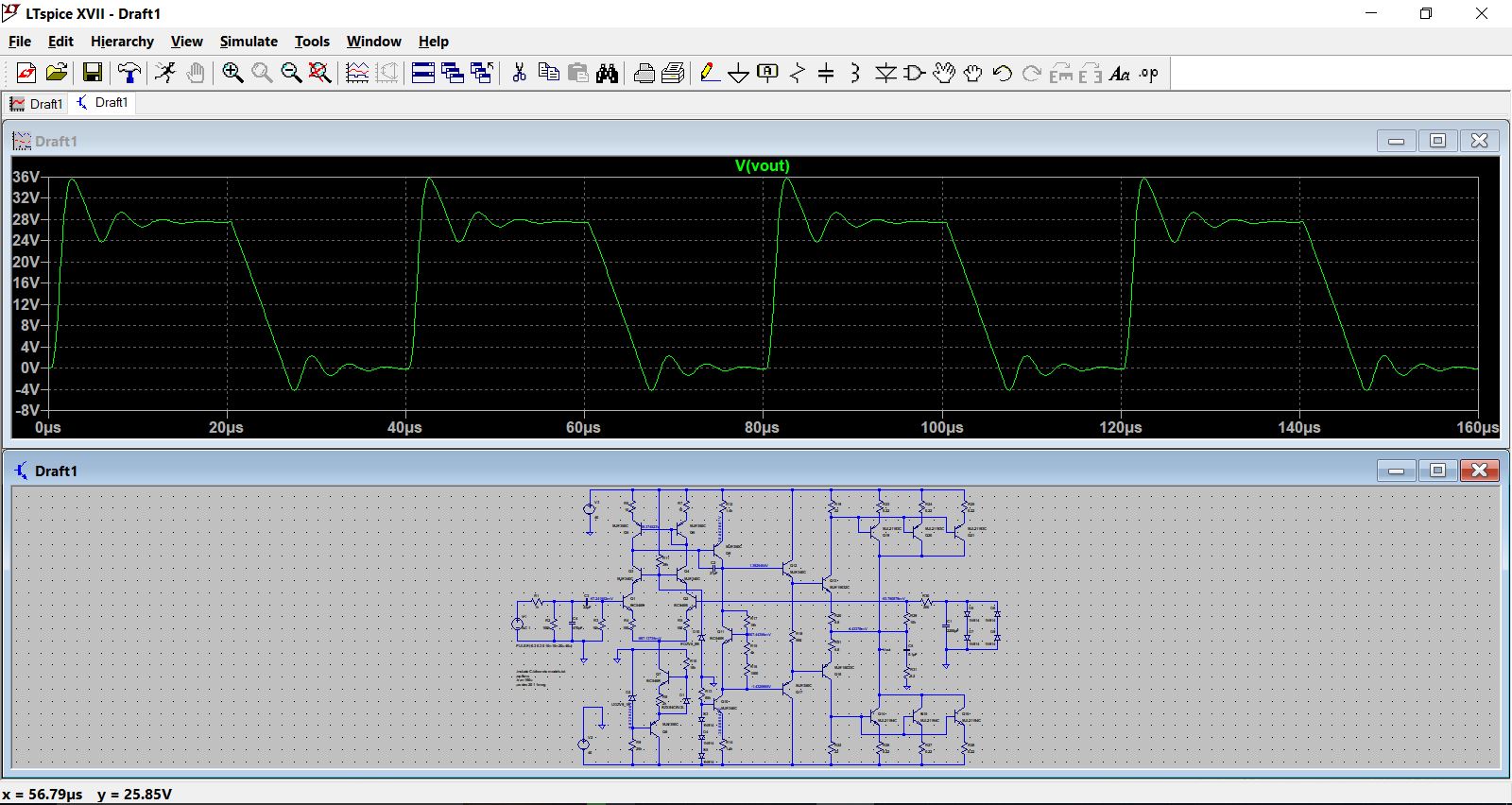

I succeeded to load the schematic in LTSpice and to run a simulation but I only got a list of voltages and currents. I couldn't find how to produce graphs. Nevertheless, this is the teething problem stage of using complex software for the first time.
Finally, I got the square wave plot.
From the previous simulation, we found that the frequency response extends well into ultrasonic frequencies to several hundred kilohertz. The square wave distortion suggests some harmonics were not amplified, or better, that the bandwidth is not wide enough. For an audio amplifier this cannot be what is causing the distortion of the square wave. I think, it is a poor dV/dt, slew rate. So, I must redesign the VAS with aim of improving the slew rate. The Miller Capacitance is too low to be the cause. I am tempted to think, the MJE340 and MJE350 are the cause. Hm, if I use a cascode to prevent both Base-Collector junction capacitances from experiencing voltage changes, I might get a better dV/dt (slew rate).
One itching question is: is a square waveform with T = 40 micro-seconds of the right frequency? Such a period belongs to a frequency of 25kHz. So, with 'our' huge bandwidth, that should be space enough for up to the 16th harmonic (assuming a bandwidth of 400kHz). Sixteen harmonics give rise to a better approximation for the square wave. So, I conclude it must be the slew rate that is degrading performance.

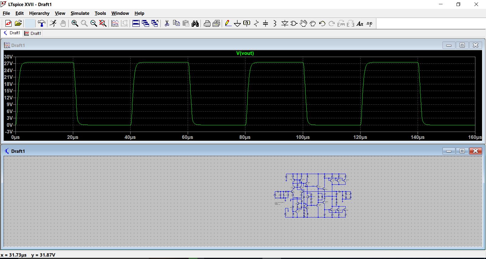

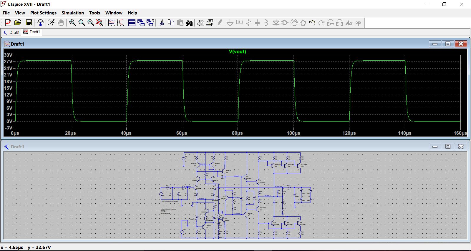

The sim file I attached has the front MJE devices replaced with smaller and faster ones.
As well as looking at the output voltage, also look at the input voltage across the filter. That has the (wanted) effect of reducing slew rate. I also added a small cap across the feedback resistor to introduce a small amount of phase lead compensation.
If we go all out and remove the above caps we appear to get a better square wave response but I would caution against trying to squeeze the last bit of rise time this way as it will be at the expense of stability.

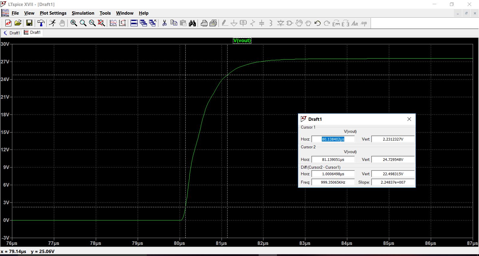

So here is the slew rate under these conditions. I've also added an 8 ohm resistive load.
So over 1uS the amp slews at approximately 22v/us which is pretty decent in practice.
The last image is with the input filter cap back in place and looking at the voltage across this cap (the input to the amplifier.

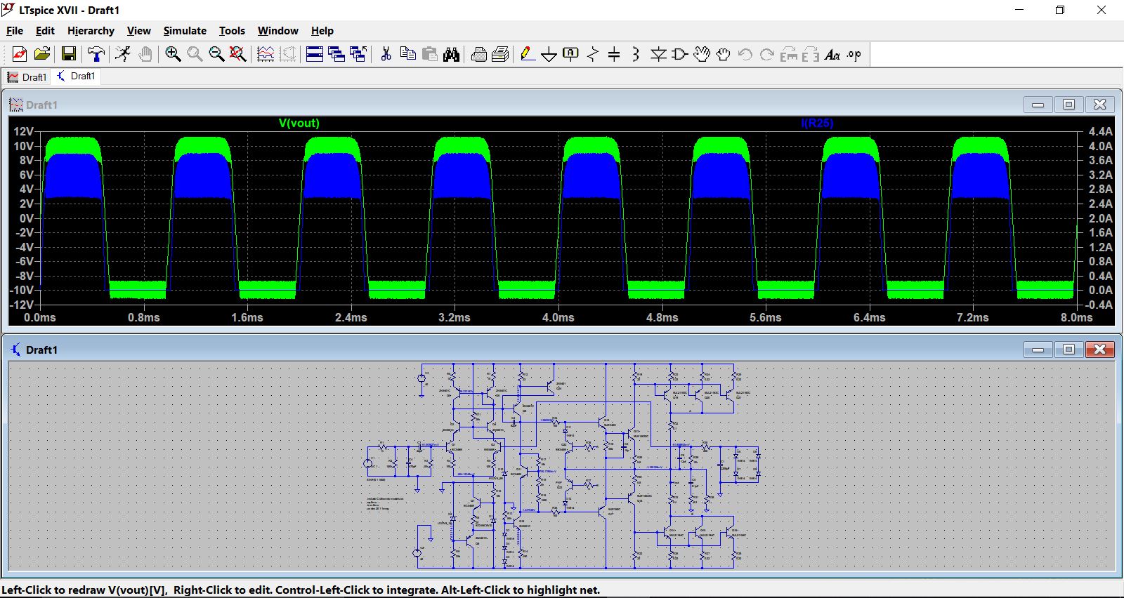

I hopefully implemented output current limiting with two transistors which divert current away from the output transistors' bases as drive current increases.

In your arrangement the limiter transistor will pass a massive current when it is activated.
Have a look at this which acts on the pre driver transistors. The VAS stage also has a limiter added which is essential to prevent this stage trying to supply lots of current when the protection activates. Not only can the current limit be more precisely defined, it can also be modified by adding a divider network to the protection transistor bases. You could also go further and partially bias these transistors by a resistor to each supply. That allows for the circuit to more closely follow a safe operating curve SOAR) whereby the protection also follows the supply voltage. If the rails are raised the limiting occurs at a lower current.

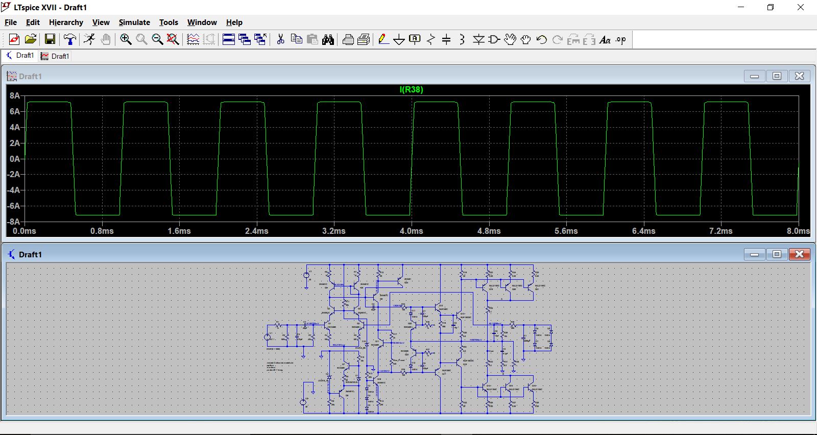

This shows what happens when a 1 ohm load is applied at full output. The voltage swing is limited (in green) and the output transistor current for one of the devices is shown (in blue).

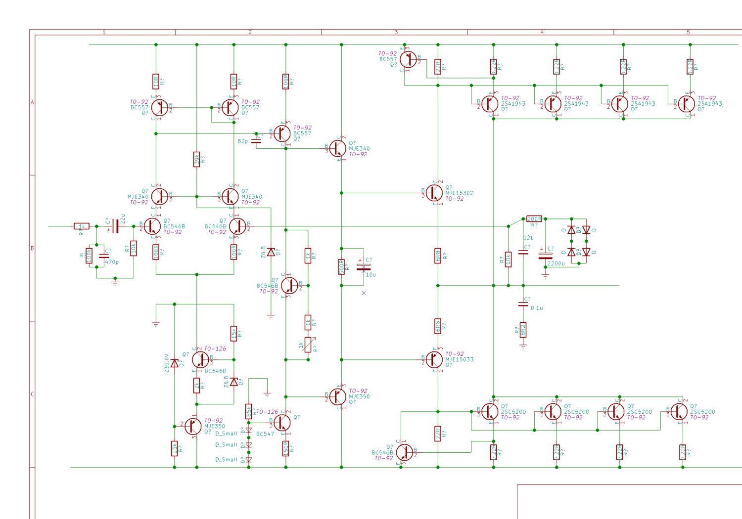

- My attempts at a design of a 3 stage amplifier
