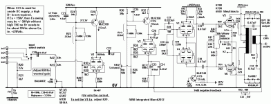

i followed your recomendation with the wiring and i took a pic of the trace on amp output with input grounded, set to 10mV,5uS (and the signalgen switched off.)
maybe the blurry lines on my previous posts are leading in the wrong direction.
I also need to explain the sound i am chasing.
its an audible noise produced by the output tube of the amp, i called it squeeging before. Possibly this is the wrong term for it, sorry about my english here.
its more like a whistle produced by the tube even if only a resistive load is connected. it varies with the frequency i feed from 8khz to 17khz, and it varies with the volume setting. since it is also audible when i feed the signal directly into the driver stage i am thinking now its either produced in the driver or output stage of the amp.

Your scope shot looks pretty decent. The last bit of trace blur may be from local FM radio transmitters. You can investigate by reducing the time scale.
On my 400 MHz scope I get about 20 mVpp of 91.7 MHz from a local transmitter. Hence, I tend to have the 20 MHz bandwidth limiter enabled when I perform low-level measurements.

remove R56-R61 and the 1n4007's out of the output circuit.
i tried this before, didn't change anything.
i also removed C31.
still the same problem.
i looked at the powersupply circuit again and simplified the heater circuit.
i doesnt change the sound i am hearing though😡
all the schematics are attached so everyone can see it as built.

Are the powersupply-caps connected close to the respective amplifierstages or are they somewhere miles away?
Did you try to damp possible ringing of the powersupplies pii-filter, or even better substitute the choke with a resistor?

Looking at the earliest schematic in this post, is a SEPARATE R10 resistor used for each grid or did you tie the grids together and use a single R10?
If not, please use a SEPARATE R10 resistor for each grid and tell me if this solves it.
