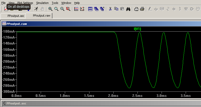

Speaking of simulations... I ran a sim of a KT88 push-pull stage. I set it up following the datasheet operating points that you posted (Post 47). I used Norman Koren's KT88 model and a modified version of a Plitron ultra-linear output transformer that he has in his library as well. The OPT model was modified to provide 4 kOhm plate-to-plate primary load with 8 ohm on the secondary. The UL taps are at 40 %. I have included a parasitic resistance (not plotted on the schematic, but included with the inductors L1 through L4) of 1 kOhm total from plate to plate distributed according to the turns ratio between the different windings.
RESULTS:
At the datasheet operating point, I get 50.9 mA per anode (datasheet: 50 mA).
The peak supply current is 288 mA (datasheet: 280 mA).
Peak power delivered to 8 ohm speaker load: 70.8 W (datasheet: 70 W).
RMS power delivered to 8 ohm speaker load: Approx 40 W.
Above at 1 kHz sine input.
See attached for details. I have attached the LTspice simulation file (.asc) for those interested in reproducing my results. I have also attached the KT88 model I'm using (rename KT88.txt to KT88.lib - DIYAudio did not like the .lib extension).

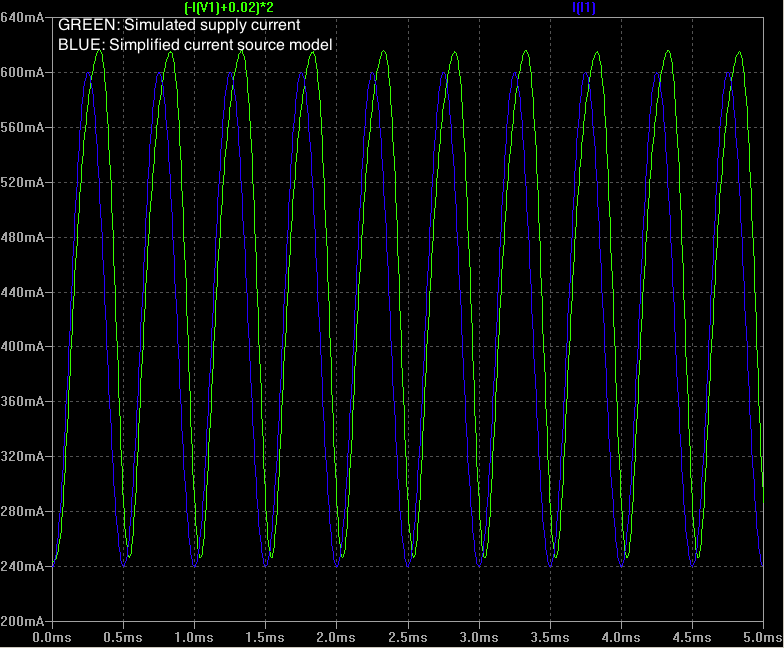

Now, have a look at the plot of the supply current. It certainly is not a step function. In fact, it is quite similar to the ideal DC+sine I used in my power supply sim back in Post #57 with the supply current plotted in Post #59. Note that the supply current plot attached to this post is for one channel and does not include the 20 mA per channel of static current drawn by the input stage and phase splitter.
The last plot shows the simulated supply current (green) vs the ideal current source model (blue). For the simulation, I added 20 mA constant (input stage, phase splitter) and multiplied by 2 (two channels). The blue curve was generated using the same ideal source as I used for Posts #57 and #59 except I changed the frequency to 2 kHz and adjusted the phase by 90 degrees to make the curves line up.
We actually both missed the fact that a P-P output stage draws current at 2x the input signal frequency (DUH!)
Now, the two currents aren't exactly line-on-line. But pretty damn close. The discrepancies are caused by output stage distortion (doesn't draw a perfect sine wave current) and a slight difference in operating point versus the datasheet values.
Would you agree that the DC+sine signal I used in my original sim is a reasonable first order approximation of the actual supply current drawn by the amplifier?

No. This is the fundamental misunderstanding that is leading you to believe that the average supply current is the same at all times.
DC + sine means that the current rises from the idle value during one half-cycle of the signal, and then declines below the idle value during the second half-cycle. Net result: average current is the same as the idle value.
What really happens is easily shown by modifying your sim to show the current in idle phase as well as the active mode. See attached. The Current rises in the first half-cycle, just like your sinus model, but in the second half-cycle, it also rises! Here is the vital difference that you are missing. The current waveform is like a full-wave rectified sinusoidal draw, NOT a raw sinusoid.
This waveform gives rise to an increase in average supply current. This has to be the case with class AB, or no power could be delivered to the load.
The full-wave rectified waveform also explains why you get double the signal frequency is the supply current. No, I did not miss this - it is what I meant by the 2 PP-halves signal current contributing "additively" to the supply current.
Ignoring the differences in magnitude, the PSUD2 shot that I posted in the first instance is intended to illustrate the effect of an increase in average supply current. Do not be distracted by the step change shown. It does not matter if the rise time is 3 minutes. The effect I am demonstrating is the sag in supply voltage due to increase in average supply current.
If you're quick to learn, here is the problem to grasp! It is worked out numerically in exquisite detail, in the page-reference of Langford-Smith I noted earlier.
Perhaps I failed to communicate that I was running a worst-case simulation. I.e. supply voltage at max power output. I don't see much point in running a simulation at idle if we're trying to identify issues that arrise when the amplifier is delivering high output power.
Yeah... The B+ voltage droops as you draw more current. That should be no surprise to anybody. You're pulling charge out of the reservoir cap at a faster rate and dropping more voltage across the transformer secondary DCR and other series resistors. This would happen with any un-regulated supply. That's why I built my high voltage regulators in the first place.
I still believe your simulation in Post #47 uses the incorrect value for the average current drawn during max output power. The correct value should be 420 mA based on the values you list in that post.
I tweaked my DC+sine model to match the amp simulation a bit more closely. I'm running 445 mA DC + 205 mA sine as the simulation of the amp current draw under max output power conditions. This includes the power delivered via the output transformer to the 8 ohm speaker load. I also added a model that simulates the average current draw.
The average current model will predict the average B+ voltage under load. It will not predict the ripple voltage. The DC+sine model will predict the ripple voltage.
The sims really speak for themselves. Can we get back to helping yurgs fix his amp now?

The simulation results speak pretty clearly for themselves, I think...
For each channel, supply current rises from 120mA to 300mA. For 2 channels the current is obviously 240mA to 600mA. What could be simpler?
Correct. The current rises from 240 mA to 600 mA as the instantaneous voltage of input signal goes from zero to its peak value. The current goes back down to 240 mA when the input signal's instantaneous voltage goes back to zero. This is clearly modeled by my simulations and you can go back and look at the plots to convince yourself of this.
I realise that you have never actually designed a PP amplifier, and therefore will not know what to expect,
I think anybody who has read my posts on this thread should be able to conclude by now that I have a pretty good grasp of the fundamentals here. That's in part what simulations give a circuit designer.
My simulations above reproduce all the parameters in the datasheet blurb to within a few percent of the datasheet values. The DC operating point is dead on. I have full confidence that the models I use are correct and accurate. I have full confidence in the simulation.
In the simulation plots I show the simulated curves as well as my modelled curves for the current draw. It's easy for everybody to perform a visual comparison of the curves. I have full confidence in my models and believe they will produce reasonably accurate results.
If you don't believe in the simulations, I suggest that you build the circuit, measure the supply current, and report back with the results.
but you are surely not interpreting the data sheet values as instantaneous, rather than dc values? Nothing so basic? Do I have to do a Data Sheet 101 as well as the PP PSU 101?
