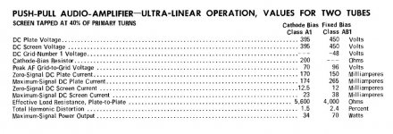

As per KT88 data sheet, we use:
Va(0) = 453V
Ia+g2(0) = 2x 50mA
Ia+g2(max sig)= 2x 140mA
RL A-A = 4K
bias = -59V
Vg1 (ac)(crest)=114V (ie peak to peak)
Pout = 70W
Textbook UL conditions are used, so a load line can be imposed on the UL curves given in the data sheet.
Construct the load line in the usual way. For PP, we analyse a single valve's curve. Each PP half drives half the voltage, so the impedance presented to a single valve is 4K/(N^2) = 4K/4 = 1K. We draw the load line from the bias point (453V, 50mA), and take a 1K gradient to the point where Vg1 = -2V: i.e.: (-59 + 114/2)V.
Read off the peak currents: Ia = 360mA peak, Ig2 = 36mA peak.
Therefore,
Ia+Ig2 peak = 396mA
I(av) = I peak / (2^0.5) = 280mA
The B+ capacitor carries out the peak-to-average conversion: that is exactly what it is there for. Therefore, the dc supply current becomes the data-sheet value of 280mA dc.
I agree.
So why does my simulation line up so well with the datasheet values? Happy coincidence? Did I somehow get off by exactly sqrt(2)?
How does a capacitor average current? Given that the reservoir cap is constantly recharged, I can see how it would average the B+ voltage, but not the current...
The inductance of the OPT primary winding, on the other hand would do a fine job of averaging the current. Naturally, this would lead to a change in the waveform shape from the full-wave rectified waveform you described earlier to something with a lower di/dt.

While we have the UL load line to hand, may as well examine the effect of the apparent mismatch. As you say, connecting 8R to the secondary of an OT intended to go from 5K to 3.85R - will present over 10K to the Anodes.
This load reduces the peak anode current to 200mA or so, and the dc Ia+g2 drops to about 155mA per channel.
This could well explain why Yurgs is seeing only a small drop in the dc supply, when clipping takes place.

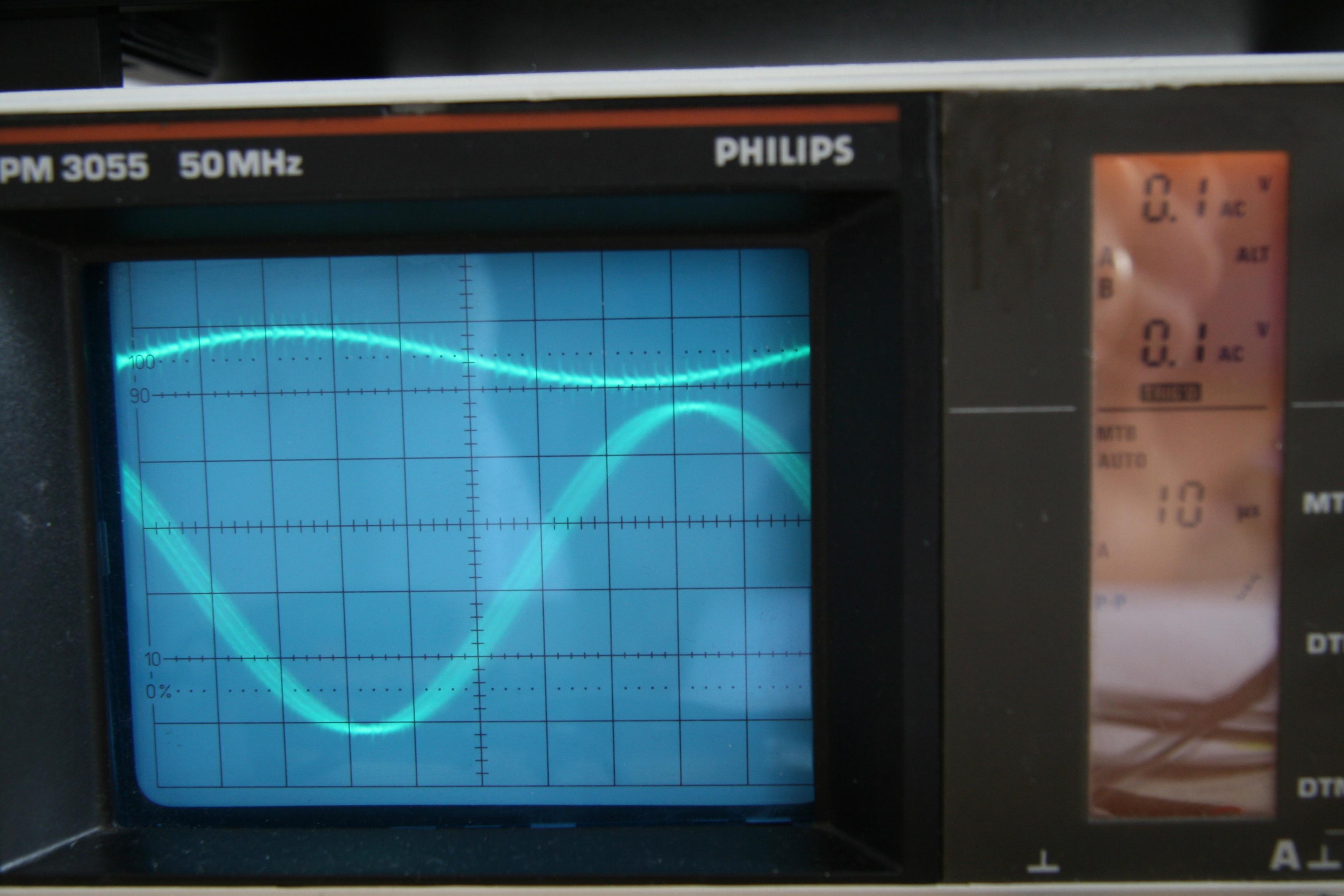

1. i changed the load to 4r, with no change in the squeeging.
2. i took out the ccs on v1 and v2, and used resistive anode-loads and i replaced the 5814 with e12AU7,
so the circuit is basically as it was designed originally, the problems stayed the same though.
3. i checked the source,
the cleanest source i have is a pc with a soundcard 192khz
pic 7496 shows two traces of 10kHz, top=source, bottom= ampoutput at 1W
pic 7497 shows the same @ Timebase 10uS
the spikes on the top trace must be the 192kHz, and the botom trace shows the "swinging" of the trace, i hope the photo shows it a bit.
4. i disconnected the driver at c26, and measured with the oscilloscope, and it looks like the trace doesn't change
pic 7499 shows two traces of 10kHz, top=source, bottom= V2 -output
pic 7500 is the same at a timebase of 2uS
there are still the lines "bluring" the trace on the output of v2. (the problem must be caused in V1/V2, the sound of the squeeging disapears though, it's made audible by the output tubes, )
