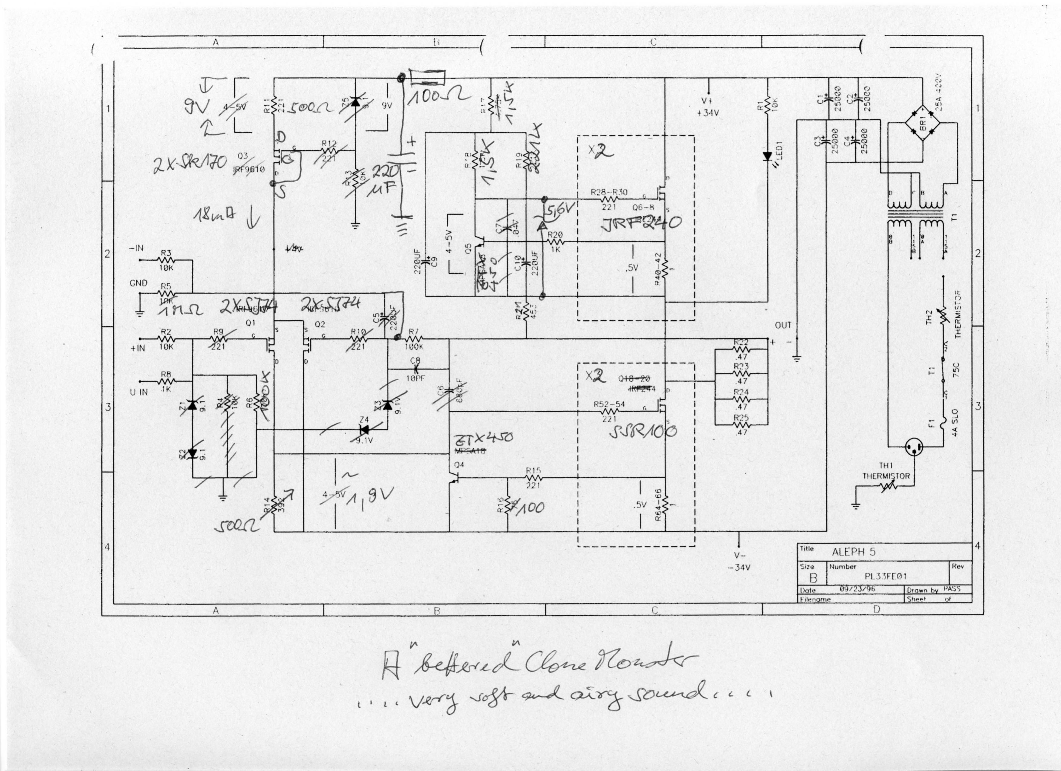

gate current - pretty much predictable - counting on Jfet input/transfer capacitances ; small bjt is already small ..... why choking him also with smaller voltage![]()
Actually I was talking about DC current. Looking into datasheet it seems the gate absorbs probably couple of mA with no AC signal present. Generg can check this by measuring voltage drop across gate resistor R52. What is more peculiar, it seems input impedance of the SS device is negative at low Vgs which could affect stability.

Generg - look at picture No.12 on this page : Long Tailed Pair Zen, A W Newby, Jan 2007
NB that arrangement of source/drain resistors in post #85 is different in another important/tricky/interesting way - with usual Aleph arrangement of output sense resistors, loudspeaker's back EMF is included in modulation of Aleph CCS

tnx to pointing to that thread ...... seems that I already forgot more than I know now
in any case - it looks that picture in post #85 is latest iteration/result of Allen's work

The results are embarrassing,
With the J-fet inputstage the SemiS sound better than the IRF in the signalpath and the aleph current sound mix with the IRF is not so pleasant to my ears, so better no aleph feedback.
But with the original IRF9610 input stage and the IRF output stage it's another world of sound, more earthbound, more dynamic, sharper, a little bit more dirty in sound.
Of course not the resolution, the airiness of the J-FETs ..... It seems difficult to get both.
Is it possible the j-fet input stage I used has no good point to work, because I loose 17V over the 1k resistor leading to the SK170, from the positiv 24V ?
that's irrelevant
that 1K resistor is just saving your CCS from excessive dissipation ;

My main question is the Aleph CCS still working after all modifications?, Should I readjust it? In which direction to keep the high power with 4 Ohm.
Are at high power levels both, the SemiR100 and the IRF working together, so I get a sound mix?
You want to adjust it for best measurement and/or best
sound. Ideally the Aleph IRF240's will not contribute
much to the sound on their own, but of course no situation
is ideal. I can tell you that they measure a little
differently than other FETs in the same spot.

Unfortunately I do not understand the meaning of the quotation above....
The IRF240 measure a bit differently than.....? Semisouth?
