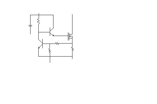

Emitter Follower... Raise the EC of the Regulator Xistor a Vbe or so...
somrthing like this...

@flg: I understand the new xistor, thanks to your painting, only the collector of the EF goes to a cap, did you mean the bootstrap cap? This cap must be also connected to the connection of the two resistors coming from the upper rail to the collector of the ZTX.

Zen Mod, so, what do you think of the EF raising the Vce of the Reg xistor about a Vbe for the Aleph circuit? Will it solve the low VCE/gain problem for a total SS output mod? Maybe it needs Iq resistors or? To work good/Fast? I will try it when I get there???
well thought , but needs actual test confirmation
maybe nice thing implementing follower there , but will it work more depends of type of lower bjt than anything else ....
say that BC546 will work OK , but BC550 will be starved ......
in any case - collector of upper bjt must be connected to bootstrap point , where any residual positive PSU garbage is already well attenuated
Actually 1.2V (expected Vgs) seems enough for proper BJT operation in my opinion. What should be checked is the gate current. When MOSFET is used the gate current is practically inexistent. It is not the case with enhancement type power JFET, tough I can’t tell what would gate current look like with full output voltage swing. EF helps anyway, just consider where to connect its collector (I guess V+).

.... EF helps anyway, just consider where to connect its collector (I guess V+).
Actually 1.2V (expected Vgs) seems enough for proper BJT operation in my opinion. What should be checked is the gate current. When MOSFET is used the gate current is practically inexistent. It is not the case with enhancement type power JFET, tough I can’t tell what would gate current look like with full output voltage swing.......
even if that voltage seems too low to me , it's worth investigating/testing ;
but - I'll not test it - just because to me is relevant enough Papa's claim that J2-like output stage is more suited for SS Jfets than Aleph CCS .
when you need bigger amp - make bigger , don't try to squeeze more from small one :rofl:
gate current - pretty much predictable - counting on Jfet input/transfer capacitances ; small bjt is already small ..... why choking him also with smaller voltage :devily:
