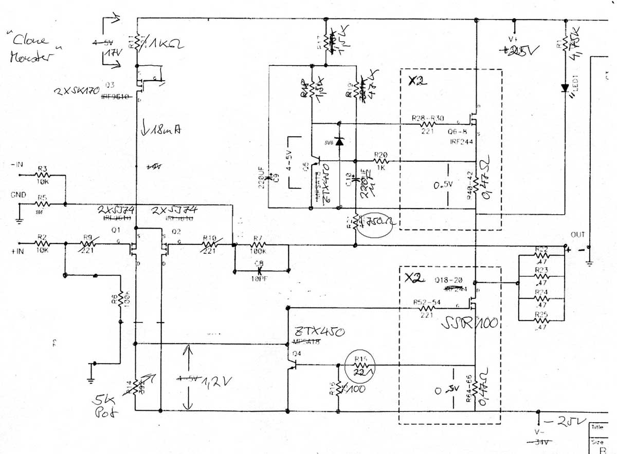

it would be very kind if you would post comments if my clonemonster is O:K or K:O 🙂
I build up an Aleph 3 because the Aleph current source is so adjusted that he delivers 60W into 4 Ohm speakers and even 60W in 2 Ohms.
This is very favorable for me because my Thiel speakers have 3,7 Ohm and only 87db.
I changed the unbalanced input to a balanced by using the values of aleph 5.
10k resistors in the input and to ground and 100k feedback resistor.
I changed now the ZVP3310 and IRF9610 CCS against two pairs of J74 for the input (matched) and a current source with two 2SK170 giving 16 mA. (J2 is greeting), made roughly in the way the frontstage of BA-2 works.
I changed the lower (negative side) IRF against Semisouth R100.
I adjusted the offset current and the Vgs with a pot like Nelson advised for Aleph J thread to 1,2V.
My main question is the Aleph CCS still working after all modifications?, Should I readjust it? In which direction to keep the high power with 4 Ohm.
Are at high power levels both, the SemiR100 and the IRF working together, so I get a sound mix?

looking at ser. man. of Aleph 3 :
important points for 4/2 ohms operation are values of R122 in conjunction with R109 & R110 , adjusting value of output stage current begrenzung ;
higher value of R109 means higher max current stage will deliver
also - value of R14 adjusts AC gain of Aleph CCS ; easiest way to achieve best AC gain for blending Jfet and mosfet part of output will be observing clipping ( symmetry) with dummy load on output , not without .

output current is dependent of two things -
1.set value of current clamp in neg leg ( that's small bjt in lower side , which role is to strangle gate of adjacent output when current through source resistor is approaching set value
2. pretty much dependable of >1< - AC gain of Aleph CCS ...... but there you must think of both voltage and current gain
for start - you can alter already mentioned values - R109 to be precise , but I can't tell you more without seeing actual schematic of your output stage ; meaning on value of Jfet source resistor(s) , type of mosfets in Aleph CCS etc
with a little shame the circuit 😱 .... only hand corrected, I could not manage photoshop sufficiently......

l:🙂🙂 thanks Bill,
I omitted the Zener already and 500 Ohm is the value Aleph 5 has installed. I will try different values.
Highs and medium area are good, bass is less than with pure A3, maybe Mos-Fet bloom is away, I´ll build in a supplementary special produced for generg Bloom-Fet :::::::::::😀😀😀😀😀😎
