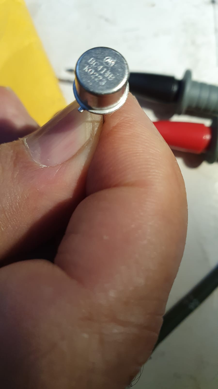

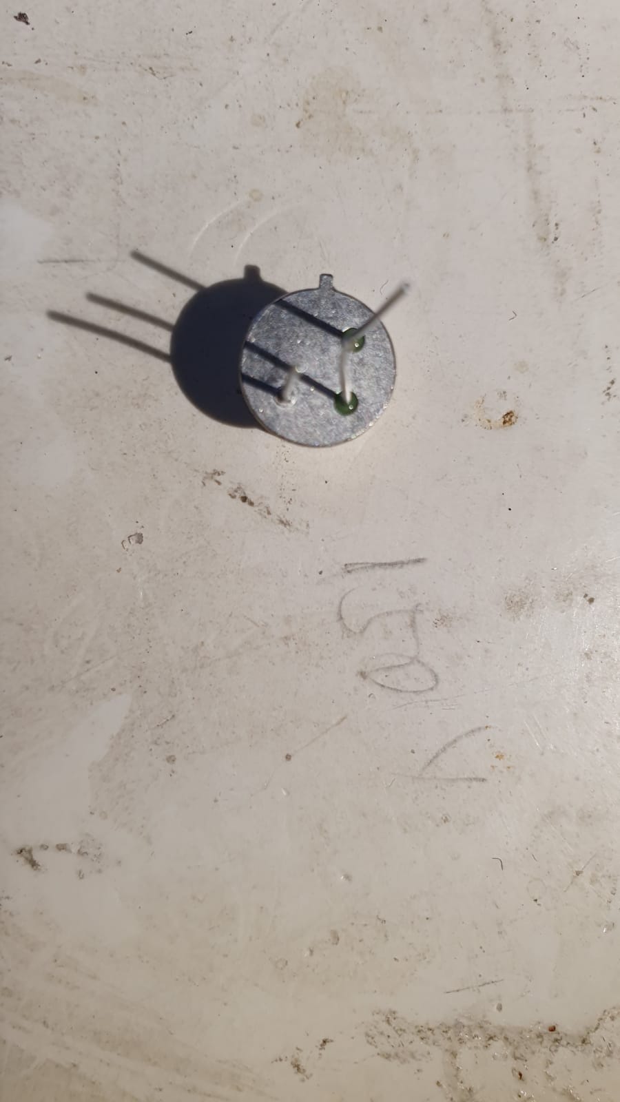

I have just received the replacement transistors for my Accuphase 100 audio bords. They come from Singapore and are strange shape for a BC 414B....I have never seen such size and metal cans for a BC414. There is someone familiar with this? Are they real BC414?

This is surely no "original" BC 414, but a transistor
of this type was not part of the T100 tuner anyway.

I recognise them that casing is an early design used in the UK for collector current BJT,s of around 100ma/200ma like the BC107/8/9 and BC186/7 early BJT,s .
Those Singapore guys blew it as far checking the changeover from steel case to plastic design in later designs --BC414 in that type of case is complete fraud as far as "genuine " is concerned.

The matter is the tipe of can, normat BC are TO18 and this one is TO39.
Usualy BC metalix can are TO18 but this one is TO39I recognise them that casing is an early design used in the UK for collector current BJT,s of around 100ma/200ma like the BC107/8/9 and BC186/7 early BJT,s .
Yes you are right but BC414 suppose to have TO18 can eventualy.Considering the case size these might be BC141 - but never I saw that kind of marking.
The BC414 is a X10 type shape or TO92 which is purely plastic .
Ic=100ma
P TOT=300mWF.
It is not standard design to put it in a metal case as LATER /QUALITY design manufacturing improved the actual die of the BJT no longer requiring like the early BJT,s to be encased in metal .
In the BC 400 range heavy current BJT,s used a TO126 , sometimes a TO106 or TO39 if you look at the later BC500/BC600/BC700 you will find even those with a 1 amp current =Ic dont use a metal casing down to progress in BJT design.

Reading back I see that this is a working tuner, but OP wants to change
transistors for unknown reasons, replacing old japanese metal cans with
European plastic types of different pinout.
BC414 by the way is no "modern component" (post 40) but was mainly
sold in the seventies.

This is not the case. The R channel audio board was not functioning and the problem was Q6. After replacing Q5 and Q6 with BC414 the tuner was back to work but I'd like to restor the original fashion. Unfortunately I did not found original components till now. (2SC1416 and 2SA776)
I am really interested to restor the original T 100 with original components.

There are no more new or used 2SC1416 or 2SA776 on the market, irrespective of price.
The closest (active) replacement is probably KSC1845 / KSA992.
If you prefer Toshiba, then maybe 2SA1145 / 2SC2705 is still obtainable.
