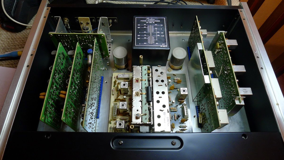

There are no more new or used 2SC1416 or 2SA776 on the market, irrespective of price.
The closest (active) replacement is probably KSC1845 / KSA992.
If you prefer Toshiba, then maybe 2SA1145 / 2SC2705 is still obtainable.
Patrick
There is some reason not to use BC550 / BC560 or BC414 / BC416?
It was " RSHXL Shenzhen Rongsheng Trading Co., Ltd. Store" from ALIEXPRES. The parcel arrived from SINGAPORE. I had already claimed for this and ALIEXPRES accepted immediately. They will refund me. It is a pity to wait 3 months and receive fakes. I shall use BC550B and BC560B as I have lots of this on my shelf. I suppose Q1/Q2 and Q5/Q6 has to be match as well as probably Q8/Q9
