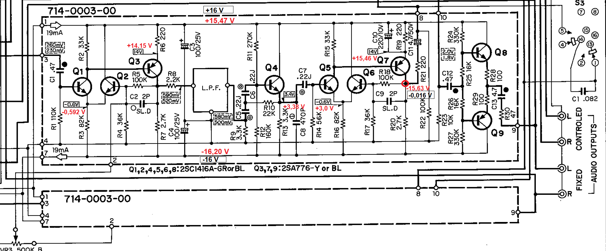

This afternoon, I've started checking for the absence of output on the Right channel. The bad news is that the right channel amplifier is not working. Let say the good news is the buffer is ok but the rest of the amplifier does not work. Also, the good news is that the decoder works as signal left and right is present until the input of the amplifier boards.
As the position in place is quite difficult to manage for measuring tensions or injecting signal and tracing it. I had to stop and think about making an adaptor for the connector and keep the board out of the chassis somehow.
To tell you the truce, I don't know where to start and where to do the measurements.
I also checked visually the board and the soldering points and seams to be ok from this point of view.
Any help, any idea?
Today I checked visually the board and the soldering points and seams to be ok from this point of view.
Then I have measured the static voltages according to the service manual and the results are as follows:
U+=+15,47V instead of +16V
U-=-16,2V instead of -16V
Emitor Q1 = -0,592V instead of -0,6V
Emitor Q3 = +14,15 instead of +14V
Emitor Q4 = +3,38V instead of +3,4V
Emitor Q5/Q6 = +3V instead of -0,6V
Emitor Q7 = +15,5V instead od +14V
Collector Q7 = -15,63V instead of -0,016V measured on the Left board which is working.
I suppose Q5/Q6/Q7 are gone, but why?. This is the effect but where can be the cause?
I have unsoldered Q5/Q6?Q7 (2SC1746/2SC1746/2SA856)
I had measured the junction b-c/b-e and values are about 0,720-0,760 V
I checked all adjacent components, the resistors, as well as capacitors values, are OK.
Unfortunately, there is impossible to find the original transistors so I shall try the European equivalents BC 416 and BC 414. I hope they are ok.
Anny idea from an experimented guy?

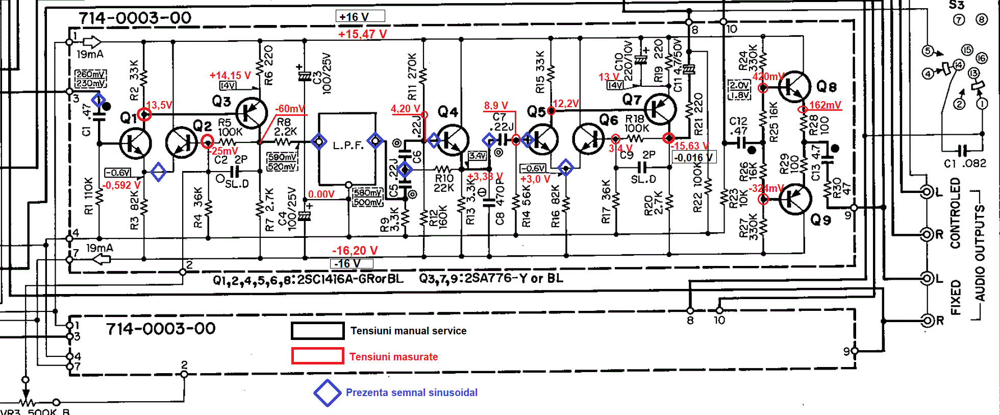

I managed to make time with the measurements, I attach the results obtained on the defective board.
I completed all the static measurements with the points mentioned by colleagues (bases and others)
I disconnected C1 and introduced 1Khz sinusoidal signal and watched as far as the signal appears, respectively in the emitters Q5 and Q6 but it does not go further. I disconnected the C10 and nothing happened, I replaced the Q7 with a BC416 and nothing happened.
I've been able to get this far.
I had just replaced the Q5 & Q6 with a well-matched (407beta) pair of BC414B. Immediately the audio module was awake to life and the static measurements went similar to the other channel module. The sound was not so bad, but I admit that placebo phenomena can cure.
