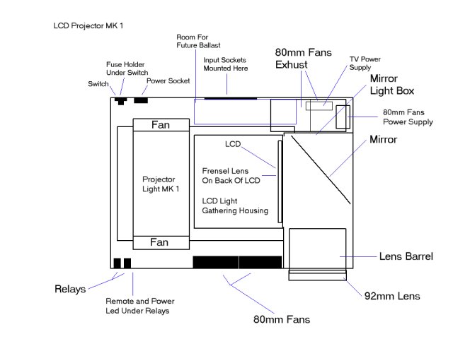

The best bulb to use for light output and heat wise on these small lcds u guys are using is a cdm-t, they are small and whack out 13500lumens, they also have a higher colour temp of 4200k, most last 6000hrs, but if u get the GE brand of the cdm-t they last for 12000hrs, a 250w hqi behind one of these lcd's, oh my now u are in brightness heaven.

Heya Ryan, its a metal halide, forget the halogen, they are crap, i used to use them myself, and after moving to the metal halide, i wouldnt go back even if you paid me to.
This place here sells them in the UK.
http://www.internationallamps.co.uk/new_web/Html/Discharge/Discharge75.html
Give them a ring, the number is at the bottom.
btw, its the bulb at the top of the list.

no offece but i refuse to goto MH because it will cost like £100+ just for 1 lamp and ballast
Na they arent that much lol 16pounds for the lamp, 2 pounds for the socket and i think 14pounds for the ballast, the ballast might have been 25 but im sure it was 14. Not bad for a bright lamp thats cold, bright, eficient and has a whiter colour temp, trust me, its worth it, and will be cheaper then buying bulbs that last 1khrs all of the time. The cdm-t also has a built in uv filter so it saves damage to the lcd.

yeah, that's why I've posted my results (and started this thread!), I know MH are much more efficient and durable then Halo,but I found the way of dichroic, and I'm really happy! 'cause who wants to build a small setup without spending too much money could try this out, and find the right infos in this thread in the future!😀
So lets go on experimenting dichroic-halo way!😎

heya Disa, yeah my first was halogen, it performed realy well, the colour was out though and the lcd ran hot, so i sold it lol, made a good profit and started my new one with metal halide, either way im tempted to get a small lcd again like a 5inch just too fool around with lol, they realy arent that bad for tv and for $60 u cant go wrong having a second big screen tv that has a inbuilt tunner.

You can see my first projector in here:
http://www.diyaudio.com/forums/showthread.php?s=&threadid=4240&perpage=15&pagenumber=93
Miles out dated now by my standards lol was built over a year ago and used a halogen.

ok I found a very nice lamp locally, but Disa' s 60000 cd lamp is doubling this 🙂
Rated volts 12 V
Rated wattage in Watts 75 W
Beam angle in degrees 8 °
Luminous intensity in candela 30000 cd
30000 cd = not 30000 lumen I know but it could be close.
