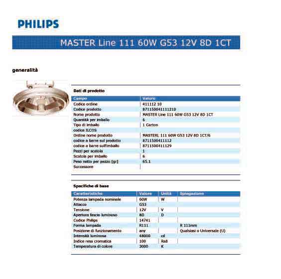

MATHIAS: No, really, it's 16.000LM 50w 12volts, these datas are issued by the manufacturer (philips). Follow the link I've posted before, you will find a lot of dichroic lamps. going from 1500Lm to 16.000, al 45-50 Watts..It depends also from the light beam, a 50w with 36°beam it's closer to 1500 lm, the 8° is 16.000LM!
I'm currently using a 8000LM, and you can see the results in te pics I've posted!
HOUSEMACHINE: I can't find here the 100W Osram dichroic, but I know Altec (If a remember) is using a 250W 12volts with very high lumens!
The one I've just ordered is a Philips 50w 16.000 LM, 8°beam, 3000hours life, 3200k color temp

disa81 said:MATHIAS: No, really, it's 16.000LM 50w 12volts, these datas are issued by the manufacturer (philips). Follow the link I've posted before, you will find a lot of dichroic lamps. going from 1500Lm to 16.000, al 45-50 Watts..It depends also from the light beam, a 50w with 36°beam it's closer to 1500 lm, the 8° is 16.000LM!
i check more well.........he has reason, it's a 16000 cd, not lm.
Its tricky, really it is. When a bulb makes a preformed beam as its output its rated in cd. When speaking of the FILIMENT itself your talking raw lumens. So any refrence to beam size vs. brightness percieved is cd. Candles. Which is what candle is by definition. Perception of overall brightness in said area. Lumens is totally diff. And EVEN LUMENS is rated diff. by each manufacturers scale. As it after all isnt even a "true" rating. One co's 5,000 lumen bulb CAN apear dimmer then anothers 4,000 lumen one. depends on "their" own lumenosity scale. The real problem? You cant have a given when refrencing brightness. It will apear different to each person. And their lies the problem. If co. A claims said watt bulb of said type ='s 5,000 lumens and its based on their scale, who's to say diff? Its just a general idea of the brightness to expect, its not really dead on. Having said that. You can be sure the ENH is much, much, much brighter then the EXT> I have them all so Ive seen it first hand. Its indiscribable, how much brighter the ENH is. But after all, the bulbs are made the same. The same sixe filiment pratically. And thus at higher watts and same type it MUST be that much brighter. And since halo's are "more" efficient at higher watts its lumens per watt ratio increases. Most noticable in dichrotics after 100watts.

PS: I've searched a little bit more on lights, and I found out the 50w I bought it's a 16.000 CD isdued by Philips..But I found aalso this light, a R111 60w with 48.000CD.. Is that good? I can't fgure out how to know if it's bright enough with CD instaed of LM!
I enclose the image with details
be careful ryan!

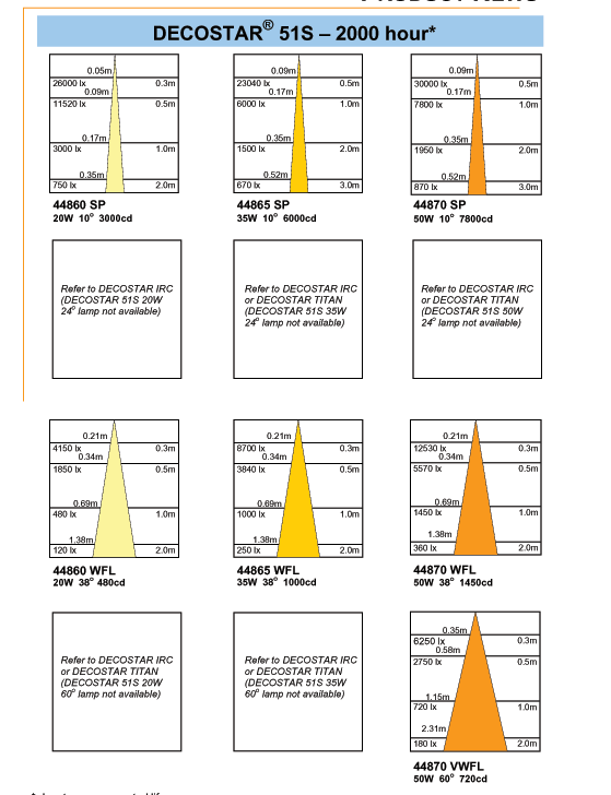

Guys I' m waiting your results / pictures. I hope you could get good results. BTW, I bought Osram Decostar 51S for $1.5 and its lumen ratio is 1450 cd.
http://osram.com.au/pdf/114bdecostarlamps.pdf
A guy is selling a box of these lamps on E-bay UK , I think Ryan could take these for cheap 😀

ummm.......1450cd i think thats a bit low, i'm no expert by any means but i'm running 2x 4750cd as i said, lets us know how it goes.

Same here with you Ryan, I don't know about lumen thingy and physics but we' re trying for a cheap solution
Actually 1450 lm will probably drop to ~500-700 lm after passing the lcd screen but effective thing is distance on lumen ratio.
In the PDF file ( @ last post..) there is some schematics. ( bottom of the page )
Lumen ratio is related with distance, so my lamp will give nothing lol from 2.0 meter distance
I think you could get max 800 lumens with one ~8-10 deg. 4750cd lamp. And after passing lcd screen it will be half, so 400 lumens IMO. ( from 3 meter dist.)
However, with 16.000 cd lamp you could get 1700 lumens pure light. After passing lcd screen it will be 800-1000 lumens , so it would be OK 🙂)
IF you can find 48.000 cd lamp, it will be real killer lol, so I think it will produce some f.king 6000 lumens 😱 , after transition it will be 3000 or more lumens... Very interesting lol 🙂 we all need some confirmation from a prof hahahaaaaha...
