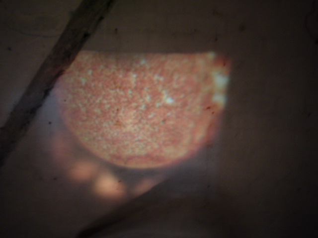

I have another problem, Mathias maybe you can help me!
With that bright lamp I have a washed-out bright spot right in the middle of the image..maybe it's because of the beam (8°)? But before triyng 24v the problem was very limited..
Maybe I have to move the fresnels a little bit from the light? What do you think?

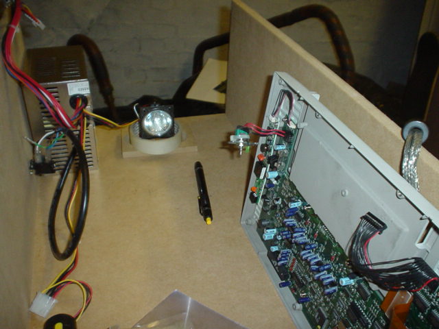

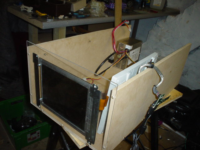

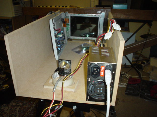

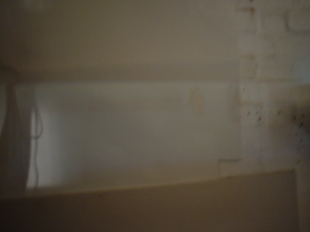

well due to not having fresnals and only 1 lamp at the moment i cant give you a decent screen shot but heres one where you can just make out the winamp icon on the task bar at 1028x768, being infront of it i can tell you it looks better here, i've mpunted the lcd backwards tho so text is dificult to read, but it does look good, no more screen door than on the lilliputs, and less than my old one, i worked out if you could see it all it would be 152" and my old one was 45" will pretty bad screen door.

Housemachine: Well, the better distance to look at it is 4 meters.. from such a distance you can barely see the screendoor effect!

hay disa, i'm using a pc power supply, i dunno how different it is to the....well whatever your using, but u can see from my resualts thats just testing and i'm back to 1 lamp because the otherones cement stuff broke when i droped it, i gotta take it back and get it replaced, i should be getting my two fresnals on saturday, so i will post resualts then, you probly can run your lcd on the comp psu depending on what voltage and ampage it needs, i think it can be 1.8v either way and the amps it doesnt matter if there over but under may cause damage, i may hunt out a 24v adaptor and try it, i think i have an 18v priner one, that should be good.
