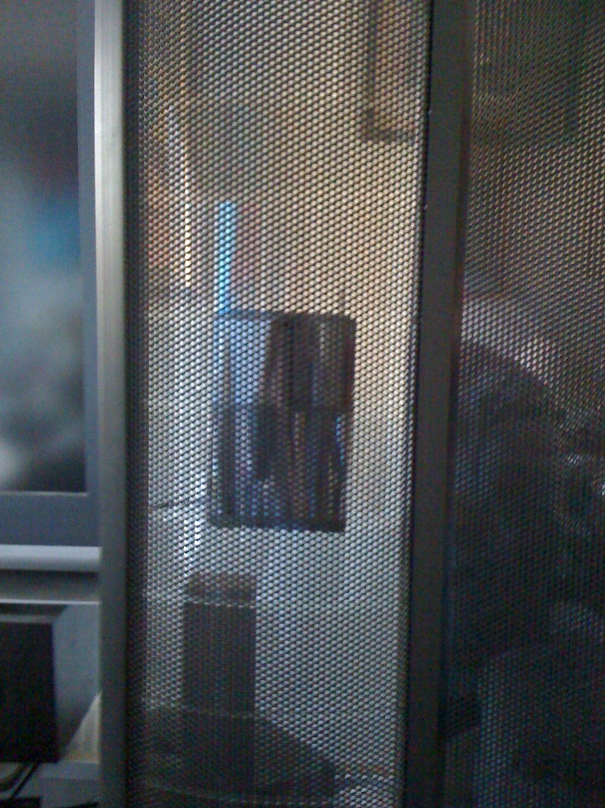

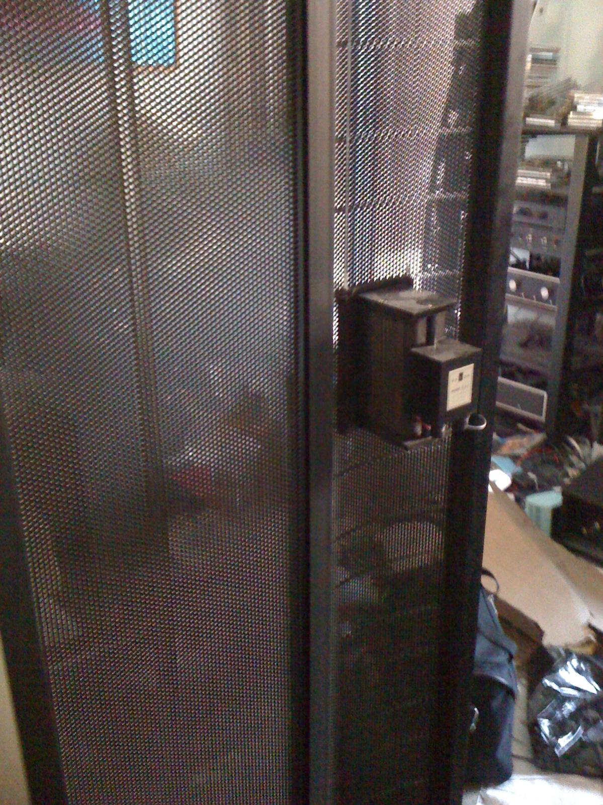

Beautiful work, Roger!
After you've finished tweaking, I'll be anxious to hear your impressions-- especially in comparison to your hybrid speakers.
Charlie
Charlie
I do'nt think any one was fooled, but the surface is NOT polished paint - It's 3mm black Plexi! 😀
Roger
Roger

Congradulations on your fine work! You might have connsidered varying the ESL segment sizes ML does to spread the resonances around.
I have the ML CLX and had upgraded the Solen crossover caps to MIT RTX and PPFXS film and foils. This improved the resolution. I also mounted a Raven R 2 Ribbon on 30 lb fishing line suspended from a custom made semicicular metal plate from the top. This greatly improved high frequency detail despite the tweeter having to play through the speaker. The Teflon cap and aircore foil inductor crossover are mounted in the speaker base and the 22 guage silver wires run inside the outer frame of the CLX (which can be removed with a hex key). The tweeter leads are brought out at tweeter height making the addition lack visible means of support and no permanent mounting damage to the speaker.
The bass transformer in the CLX is an EI core about a 5 inche cube in size, the high frequency transformer is a torroid. Have you seen the Plitron ESL tranformers? There are planar power film resistors in series with the LF transformer which can be switched in and out to adjust the LF level.
The crossover is a air core choke in series with the LF transformer. The high frequency crossover I haven't plotted out in detail yet, but is a multipole with a notch filter
Hello ticknpop,
Thanks for posting the pics for your CLX panels 🙂
Any chance you could post some pics of the transformers and crossover you described?
Thank you!
The segmentation is actualy not the same for the cells, but the variation is not as big as the MLs and I try to keep the number off cells to a minimum!
I understand the theory off spreading the reconance off the panel by different segmentation, but I do not like the nolinearity off the membrane that this causes.
My spacers are mainly there to help stability, and if I could I would only have vertical spacers as i belive this would allow the membrane to move as linear as possible!
Roger
After experimenting quite alot with different transformers, I think I found a solution!
Thanks to Tom Danley for the tip to try a spark-trafo for oilburners!
Today I went to my prefered scrapyard and bougt some trafos from old burners! 🙂
It seems to work very well. The DC resistance off the to primarys in paralell is abt. 13 Ohm (6.5 in //). I can now krank the volume to full with no noticable distorsion, and things start to realy rattle when I play Yello! 😀
Roger
Roger
WOW! That is great.
I always wondered myself if something like that would work good.
I have 3 or 4 neon tranfromers but none of them are a matched pair.
However, I did use one to modulate a candle flame once making a very clean sounding micro flame speaker using my signal generator.
At the time I didn't have an amplifier to test it further and see how loud I could get it.
Good Show! jer
P.S. Ilike the way the transformer has "intermittent service " printed on it (he,he,he).
Good Show! jer
Hi Roger,
That's a nice find. Congratulations!
Do you plan to use these for your bass panel or treble panel or both?
Do you happen to know their turn ratio?
Wachara C.
Wachara C.
I have no clue what the turn ratio is!
There is a "hatch" on the botton off the transformer.
I drilled one open hoping it to would be possible to adjust the primary turns a bit, but the whole inside off the transformer is filled with some sort off black plastic!
I will only use them for the bass panel as they are only usable up to 150Hz!
The good thing being - if the impedance is acceptable, I do not need any filtering beside the transformer for the bass! 🙂
Roger
Roger
Hi Roger,
The number of turn on the primary must be quite high, because you measure 13 ohm across it. With that high turn, I am sure that you can get a lot of bass. 🙂 However, the highs might be a bit subdued. They should be very good for your bass panels though. Congratulations!
Wachara C.
Wachara C.
