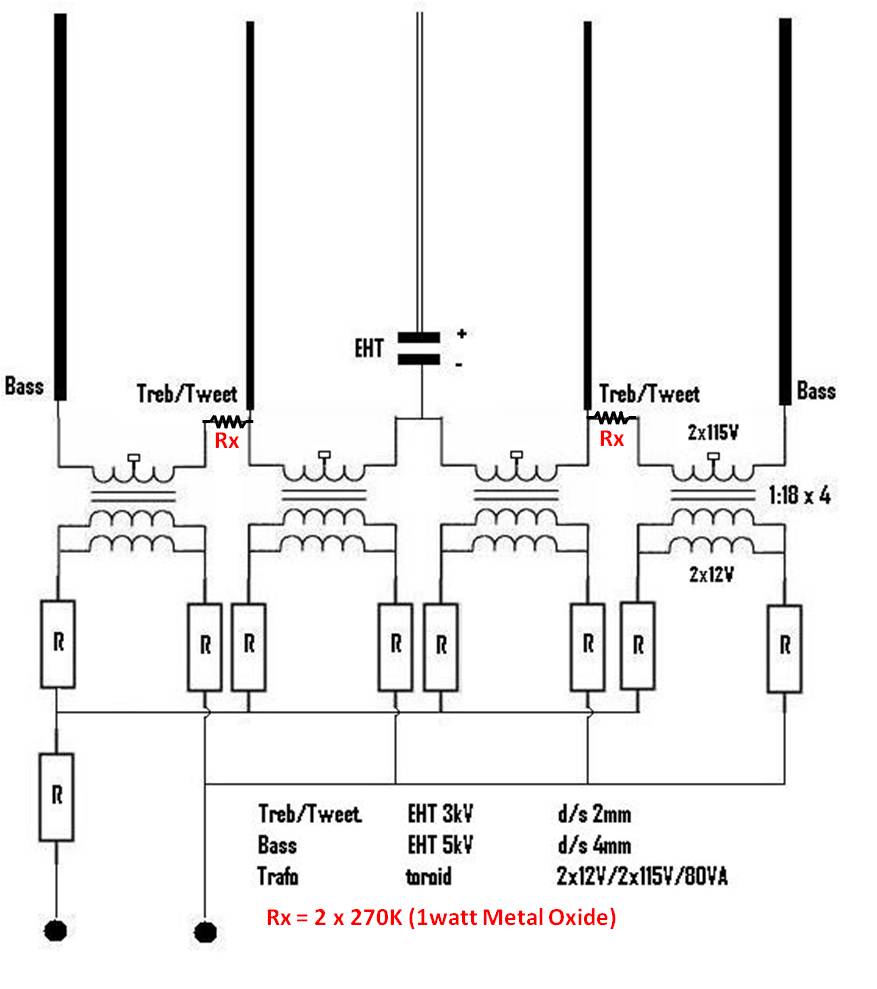

It made a huge difference in bass and SPL capability when I changed my trafo setup!
Now using 4 pcs. 2x12V/2x115V in paralell/series, 0.33 Ohm equalising resistor on each primary winding and 1.5Ohm in series wing the "total" primary winding.
This is just a start, and values are sure to change when I measure impedance and start to experiment with the filters!

With a panel of that size measurements at 1m distance will still be in the near field. I would suggest taking measurements at 2m - 3m or what ever your listening distance will be. You will find that the curves will slope downward at the low end as you move the microphone further from the panel. You will notice this also when listening to music, as you move away from the panel the bass will sound reduced in level. You will probably want to compensate for this in the crossover so the mid-bass response (100Hz-300Hz) sounds at proper level relative to the rest of the output.
The easiest way to crossover two separate panels is with an electronic crossover and then drive each panel with a separate amplifier. This avoids a lot of complications in the crossover design and will allow you to easily match the output of the bass and treble panels by changing the gain of the amplifiers.

I am not familiar with Tombstone, will have to check it out.
If you would like to try passive filtering, the first and easiest step is to LP the bass panels.
Based on the panel dimensions you have posted I would estimate the capacitance of your bass panels with D/S=4mm to by about 500pF.
So, for starters, try adding about 1Mohm resistance in series with the bass panel.
I would recommend splitting up the total resistance into four 270Kohm resistors to spread the required voltage drop and power dissipation. I generally use 1Watt Metal Oxide resistors for this purpose.
Placing the resistors symmetrically between the inner set of transformers driving the treble panel and the outer transformers also isolates the inter-winding capacitive load of the outer transformers from loading down the inner transformers. This will reduce the capacitive load the amplifier has to drive at high frequencies.
Measuring the bass panel with these resistors in place should show a roll off in frequencies above about 300Hz.

Thank you for the input - very helpfull!
I was thinking off filtering the bass panel with as resistor but would have put the resistor on the output side off the transformer - will try your sugestion when I get home today!
Any sugestion on how to make a smart passive HP-/notch- filter to help tame the resonance at 45Hz?
