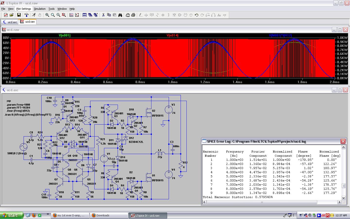

You might want to take a look at this ...
Simulated with 1Khz input at 2V amplitude
+/- 74 Vdc
0.5% THD
450W RMS
650 Khz switching freq
Of course these are simulated results, but taking in consideration that LT spice is a reliable tool you could reach those results using a 2 layer pcb design.
Best Regards,
Savu Silviu
