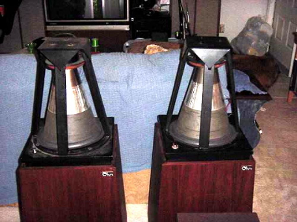

I have attached a picture of a full range pair of Walsh speakers for you to look at, so that my comments make more sense.

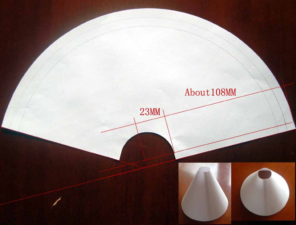

Sorry, I forgot you use translation software. I want teaching in paper making. I want to make 100mm tall Walsh cone from light rigid paper. I have no skill, no knowledge. Can you teach by pictures?
If teaching is not a good idea, can you make 100mm tall Walsh cones? Can they fit on your current voice coil and magnet motor, with flexible connection but not top piece? Open cone, empty. I can assemble voice coil with cone into magnet here. I have made many speakers from parts but have not made cones. You can make a small business out of this Walsh tweeter idea.
I like your ideas and want to know enough to make my ideas real. Please think how you can teach with pictures, and a few words. I can show how to apply EnABL to help with small details not corrected by your paper with damping. I do not need to know about secret damping material.
Bud
Bud
Bud, perhaps it would be helpful to show a photo of you painting on the design with a pen, and emphasize that this helps the sound. And that it's paint not ink.

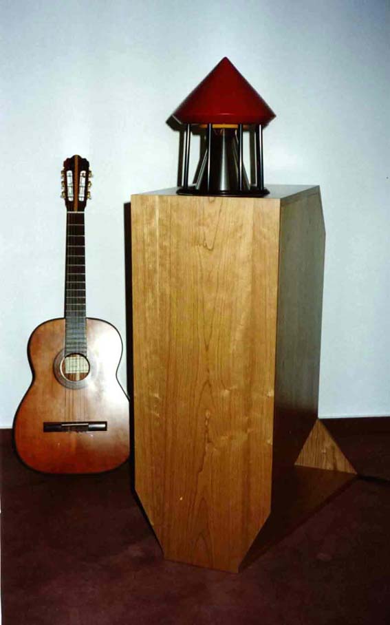

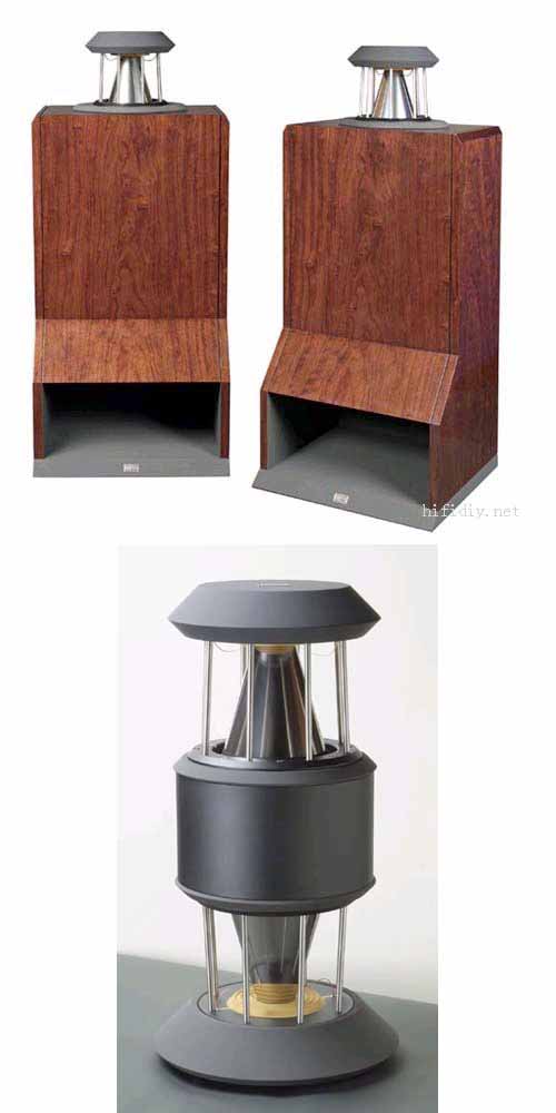

how do the unicorn mkII sounds.
I am the constructor of the unicorn I
I named it LURE.
http://www.hm-moreart.de/21.htm
I named it LURE.

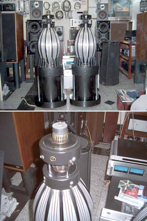

Hello hm : you are the constructor of the unicorn I?!! that's cool !
Salutes to you . i never sound it ,Expensive, i will build it.
for this speaker i think music Localization maybe is a problem.

Are you aware that this speaker is completely different from traditional cone speakers? With this speaker, the object is not to try to make the cone pistonic. The principle is to have bending waves travel from voice coil to rim, and while doing it radiate sound. So, in this case the material and its bending modulus are the important characteristics, not weight and stiffness.
The principle is similar to teh Wash concept. Most people are not aware that the Wash (and DDD) principle is completely different from traditional cone principles; there is a whole thread on Wash rebuilt somewhere here where that issue is ignored or unknown.

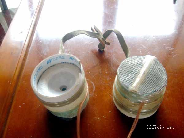

hello janneman : i only can understand half what you said, no problem, i have powerful Creativity, i don't like copy or follow,everything i do is a creation, and i will try to overtake.
i build this earphone,looks very Ugly, it's just a Simple version,but do you know what inside?a powerful Aluminum belt driver,this earphone sounds so good,even overtake BEYERDYNAMIC DT931.
i create it.
i create it.
