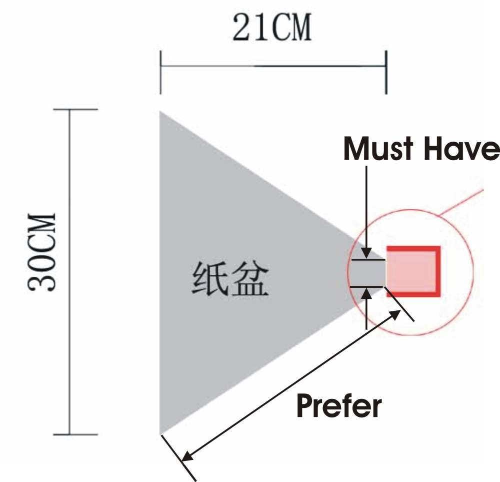

Close. I will mark up your diagram for dimensions preferred and one more I must have. This will take a small amount of time.
Would you trade expert information on paper technology? I do not want to make your cone, I have other ideas and other projects but paper is only made in factory in USA, or by hobby people for celebration cards. Speaker cone makers are very secretive and do not want to have my expert ability in trade.

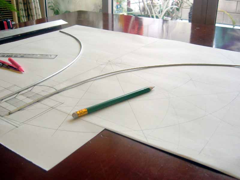

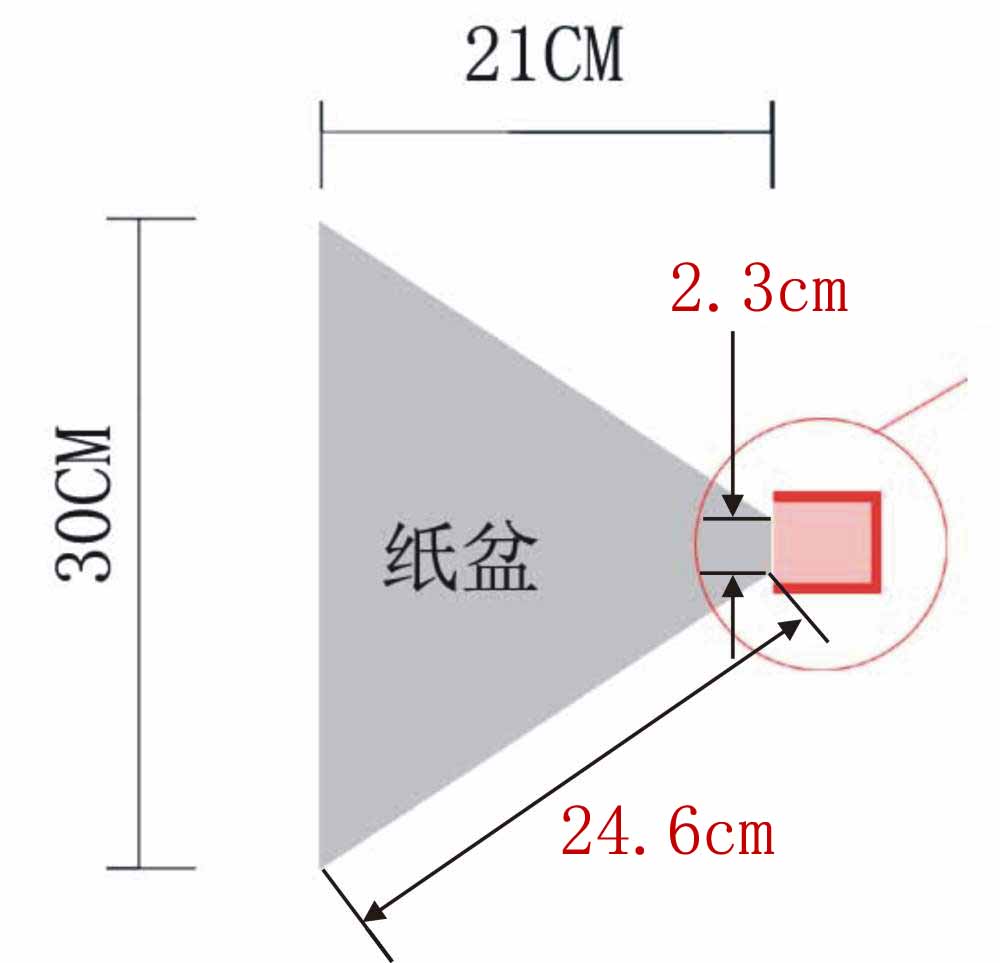

Much more interesting to me. I prefer to make conventional cone without ribs, but with light weight paper, made by hand.
I have a conic section completed to your dimensions. Do you have a program that will read Auto Cad DWG or DXF file format? If not I will send a full size JPG to you via email tomorrow. It will take some time to convert and do a good job.

I will put it into jpeg format tomorrow. Will your email address from here be best or do you want to send me a direct email and I will send direct back to you?
The pattern is called EnABL here in the USA, just so you know. I am not worried about 20 k Hz as the pattern will allow cone to produce this frequency and down to below piston point also.
Maybe steps will be needed. I would need to experiment, but do not have the skill. Can you transfer enough knowledge with pictures and simple explanations? It would be better if we could work together but the pacific ocean does not get smaller.

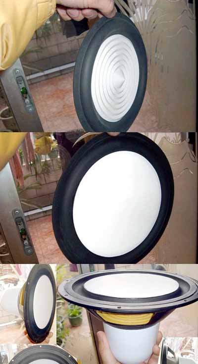

Interesting and serious 😎 with your chinese paper art, it looks like you can do almost anything you like
http://www.diyaudio.com/forums/attachment.php?s=&postid=1172326&stamp=1175318306
Very inventive but I am also kind of a conservative guy.... look at the shape of a violin, havent been changed fore hundreds of years and cant be improved
I would like to see a small membrane made with integrated surround, to be used as mid/tweeter - made with your paper artwork
Or the "ringradiator" like you show in the picture, could be interesting in a small version.... without the surround

chinese: so light and big cone ....Impressive. I hope i will see moro of your creation in the future.

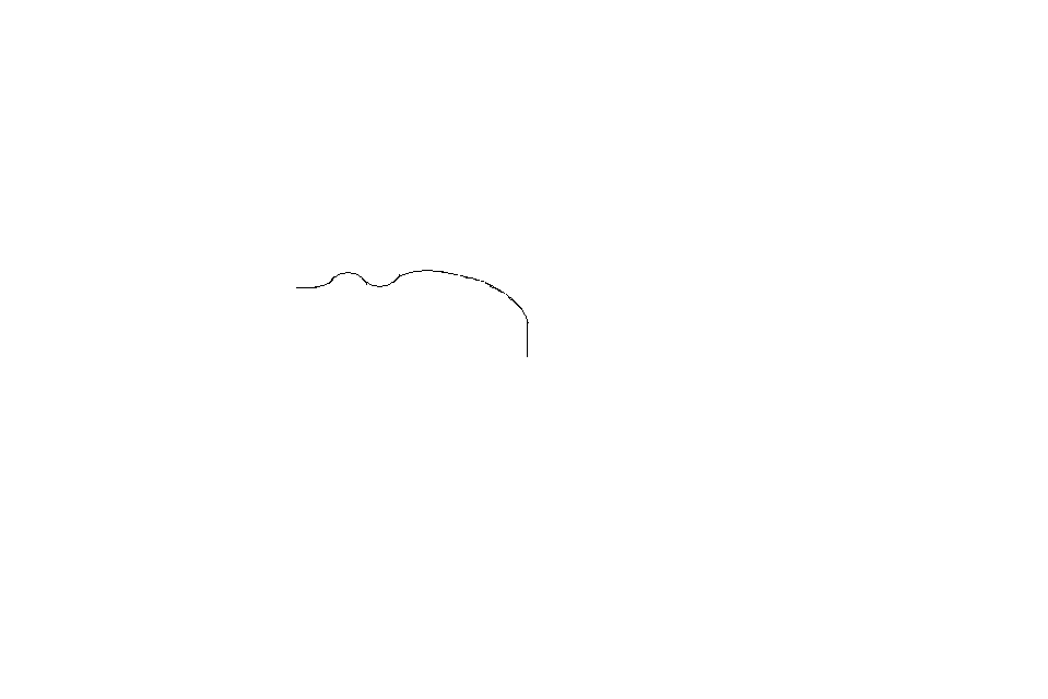

the steps is very Important,when it work in High frequency i hope only the first inside cone working,when in low frequency the whole cone working, it is my design Mentality and it seems working well.
i can do almost any size of full ranger unit what i want. i also done an Earphone before,it's a small full ranger speaker.
