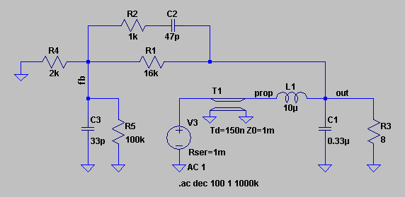

B,
I can't confirm your values right now, but mine are very usable.
Yours are way different. In fact I think they are just wrong in as much as I can tell, but there your chips. I didn't re-run my simulation, and values were a bit off for things, but I'm confident they will not smoke for what that's worth. I believe it runs steady state at ~600kHz.
I see your lead network not kicking in until about 200k, which is just too high, you will have at best very little negative feedback compared to what I gave you. It also does depend on supply voltage and I was using 24V.
You might try simulating distortion. small step times. and a 2^n number of cycles. That will fill you in on the amount of distortion, but unless your simulating dead time its going to be very optimistic. An AC analysis is the best way to determine feedback values. Just keep in mind these are not ideal comparators and if you have to much NF the signal at the comparator input will be so small that the prop delay will increase.
If you understand the UCD and distortion you will find that propagation delay is of only minor issue. It will not have a linear affect on the switching frequency, so its well worth it otherwise you'll have far less negative feedback and in fact, the hysteresis may even cause you to have a lower switching frequency.
Its dead time that causes distortion at the root, and NF that reduces this. the UCD rocks at this if implemented correctly, the NF that is, it does nothing for dead time.
An op amp in the volume control will do nothing for hysteresis. Also, if your single ended, you really need to rid yourself of coupling caps. If you've got coupling caps in there and you think it sounds good, take them out and it will be better to much better depending on how much your spending. That means split supplies, and often bridging is just a better way to deal with it. If you don't want to use a comparator, that's fine, but you'll need to use a good sounding fast op amp like the LM4562. At a gain of 10 that's got 5.6Mhz bandwidth approximately, and will be dead stable. But don't kid yourself, op amps have prop delay. (5.6Mhz*6.28)^-1 is an estimate. ~30nS or so. Put it all(op amp, comparator...) in the simulation, its trivial with switchercad.
Also, bridge or no, use a diff amp type network around the UCD. Go to Hypex's web site and you'll see what I'm talking about.
In fact, adding the dual op amp they use is a great idea, but that will be in addition to the comparator or 10x gain amp used to reduce hysteresis. If your not going to reduce or eleminate the hysteresis, the hysteresis will likely reduce the NF such that much of the UCD benifit will be lost, and also I think you'll get all the nasty disadvantages of the prefilter feedback in clipping, that is in band switching noise right at clipping that the UCD is far more tolerant of.

Hi Mike.
Attached is the circuit I was using in switchercad to simulate the switching frequency. If it is incorrect would you mind telling me how to fix it? As I said, it is a simulation that analogspiceman came up with a year or two ago. I just entered it into switchercad and changed the part values.
analogspiceman also came up with something to simulate distortion. I may try to get something similar working if you think it will help analysis.

I'm working towards the instrumentation configuration using the class d stage as the differential amp.
I thought hysteresis could just be lumped into the propagation delay figure. Guess I need to do some more reading!
I couldn't find any of that info in the datasheet and had emailed MPS inquiring about the dead time a year ago but got no response. I was just wondering how you managed to get that information.
So all in all, it sounds like you have a working prototype built using the MP7720 in a UCD configuration. How does it sound?

BWRX said:Hi Mike.
Attached is the circuit I was using in switchercad to simulate the switching frequency. If it is incorrect would you mind telling me how to fix it? As I said, it is a simulation that analogspiceman came up with a year or two ago. I just entered it into switchercad and changed the part values./
Can't spend the time now, maybe later, sorry.
It is insightful.
I thought UCD is a phase shift topology? Doesn't that make propagation delay a very large issue, especially around the frequencies I'd like the amp to be switching at? The propagation delay is the major factor in determining the upper limit on the possible switching frequency, is it not?
Maximizing switching frequency is not the goal, but maximizing negative feedback IMO. 20mV of hysteresis is going to limit the amount of NF you can get seriously.
Since these amps are working off of 12V rails they obviously don't need a lot of gain. A 10x gain stage in front of the amp would mean you'd want the class d portion around unity gain...
This stage of 10x gain doesn't increase the system gain, just reduces the affect of the hysteresis. It is IN the FB loop. We need a picture I'm afraid. L8R.
Yes, in calculating the swithing frequency, but it really causes a hit in potential NF.I thought hysteresis could just be lumped into the propagation delay figure. Guess I need to do some more reading!
