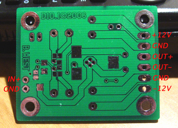

Any ripple on the supply lines is not from the supply but from the amp's output stage. Class d requires careful attention to layout of the power traces, filtering, and decoupling. There is already adequate filtering on the PCB in the form of a CLC network, and it's not the first time I've used it in my designs either
Yes, it's not terribly easy for the camera, but it's definitely doable.FastEddy said:I have a couple of Navy surplus Tektronics my self, and getting a decent display from those old tube type 'scopes can be a bear for the camera.
In the low frequency photos the camera's shutter speed is very slow so it can capture the scope tracing the entire waveform. That "noise" isn't actually noise. It is the switching residual that gets through the output filter. You will see that with any PWM class d amp.FastEddy said:But I thought I recognized some noise in the trace pictures. ... Posts # 171 (sq. wave), # 172 (10 Hz sine wave) & # 173 (20K sine wave) in particular would make me suspect that a whole lot of noise, besides just the PS, is getting through to the amp.
The power supply is more than adequate, there is plenty of filtering, and the PCB layout (especially with respect to decoupling the supply rails) is pretty good.FastEddy said:This also indicates that the amp chip is passing more than just low freq audio information plus power supply ripple ... indicating that the power supply ripple is only a part of the problem noise.
I would suggest some form of additional filtering on the power supply rails like two inductors and matching caps on both +Vcc and -Vdd (ground).

That just means that the 180mohm output fets on the chip are dissipating a lot of heat at maximum output. This is definitely to be expected especially since they are in a rather small SO8 package - not very efficient heat transfer to the air.
I would have used wirewound inductors instead of ferrite chip inductors for power supply filtering but that would really make these modules a lot larger. My main design criteria was to make the PCB as compact as possible without compromising the layout.
FastEddy said:" ... I almost burned my finger touching the chip doing the low frequency tests into 4ohms ..." This also indicates that the amp chip is passing more than just low freq audio information plus power supply ripple ... indicating that the power supply ripple is only a part of the problem noise.

180mohm FETs conducting about 2Arms will dissipate about 0.7W a piece. That's 1.4W for both output FETs that has to be dissipated by the SO8 package at max power (15W) into 4 ohms. That's a lot of heat, and is more than enough to make the case hot enough to burn your finger. Assuming not much other dissipation is going on that's about 90% efficient, which is really quite good. Even more amazing is that the chip didn't go into thermal protection!
That's the exact filter scheme used on these modules. Although the ferrite chip inductors I use are intended to reduce the higher frequency garbage from getting into or out of the amp through the supply rails. Grounding is a whole nother story, but inductors should not be used between power and signal grounds.
Yes you do want it removed. The problem is that lowering the cutoff frequency of the output filter lowers the frequency at which peaking occurs, can bring the phase shift down into the audbile range, and requires physically larger components. It's a trade off and a filter with a higher cutoff will have more residual at the output and a little more noise.FastEddy said:Yes, but don't you want that switching residual removed from the amp output?? One would think that removing all the EMF / transients / etc from the PS would help.
I go by that rule too, but there's only so much you can do to heatsink an SO8 package... The higher amplitude of the switching residual is being wasted as heat in the output impedance, not in the output FETs. It's the output filter that determines how much it gets attenuated.FastEddy said:I go by the old rule: If it burns the flesh, its too hot ... and anything other than the audio signal that consistantly gets through the output stage of any amp is a waste of power ... the power being radiated as heat.

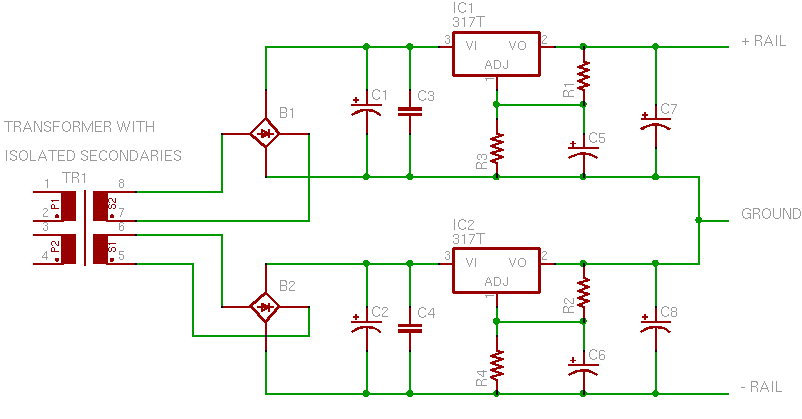

Also, attached is a schematic of how you can get regulated +/- supplies with two three terminal positive voltage regulators. It's simple and works quite well. I've been using a setup like this from the beginning. Please note that you need to use a transformer with electrically isolated secondaries for this to work. You can not use this schematic on a transformer with a center tapped secondary.
