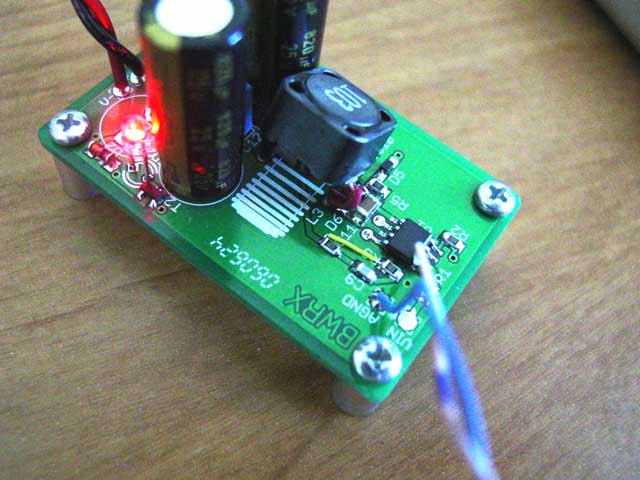

Well, the operation was a success. The MP7720 with post filter feedback works as expected. The parts I used were the closest ones that were on hand. This is a noninverting configuration.
Ri=2k, Rf=20k, Rfl=1.02k, Cfl=220p
Supply rails are regulated +/-12V.
These values result in a switching waveform with a period of about 1.75us, which means the idle switching frequency is about 571kHz. The switching looks just as clean as it did with the MPS recommended circuit on my trusty 10MHz Tek T922.
I only have one channel but it sounds pretty decent out of a Radio Shack 1197 Now to mod the other board and give the stereo pair a listen.

Congrates!
Can't wait to hear what you think in stereo.

The stereo "UcD" pair has been running for a couple days now and sounds very nice. Early impressions are that transients (drums, strings, etc.) are better but the high end seems a bit recessed. This is in comparison to both the MPS circuit and a pair of instrumentation LM3875 amps I've been using.
Noises at turn on are the same but turn off produces a brief squeal with the UcD config. This can be remedied with a different enable circuit. I have this set to disable the chip more quickly on my newer modules but not on the old ones I've turned into mini UcDs.
I need to wind some toroids and replace the surface mount ones currently being using (I was feeling lazy). They had to be tilted so the centerlines of the cores were perpendicular to minimize interaction and noise. That magnetic shieldiing only works so well...
Currently, both modules are configured for a gain of 3 (non-inverting with Rf=4k, Ri=2k). The phase lead components have not changed (R=1k, C=220p) and the switching frequency has only gone down very slightly. The op amp buffer out front has a gain of 2 and drives the non-inverting pin of the MP7720 directly.
I honestly didn't see the switching frequency vary a whole lot with hysteretic feedback and different loads (4 and 8 ohm).
