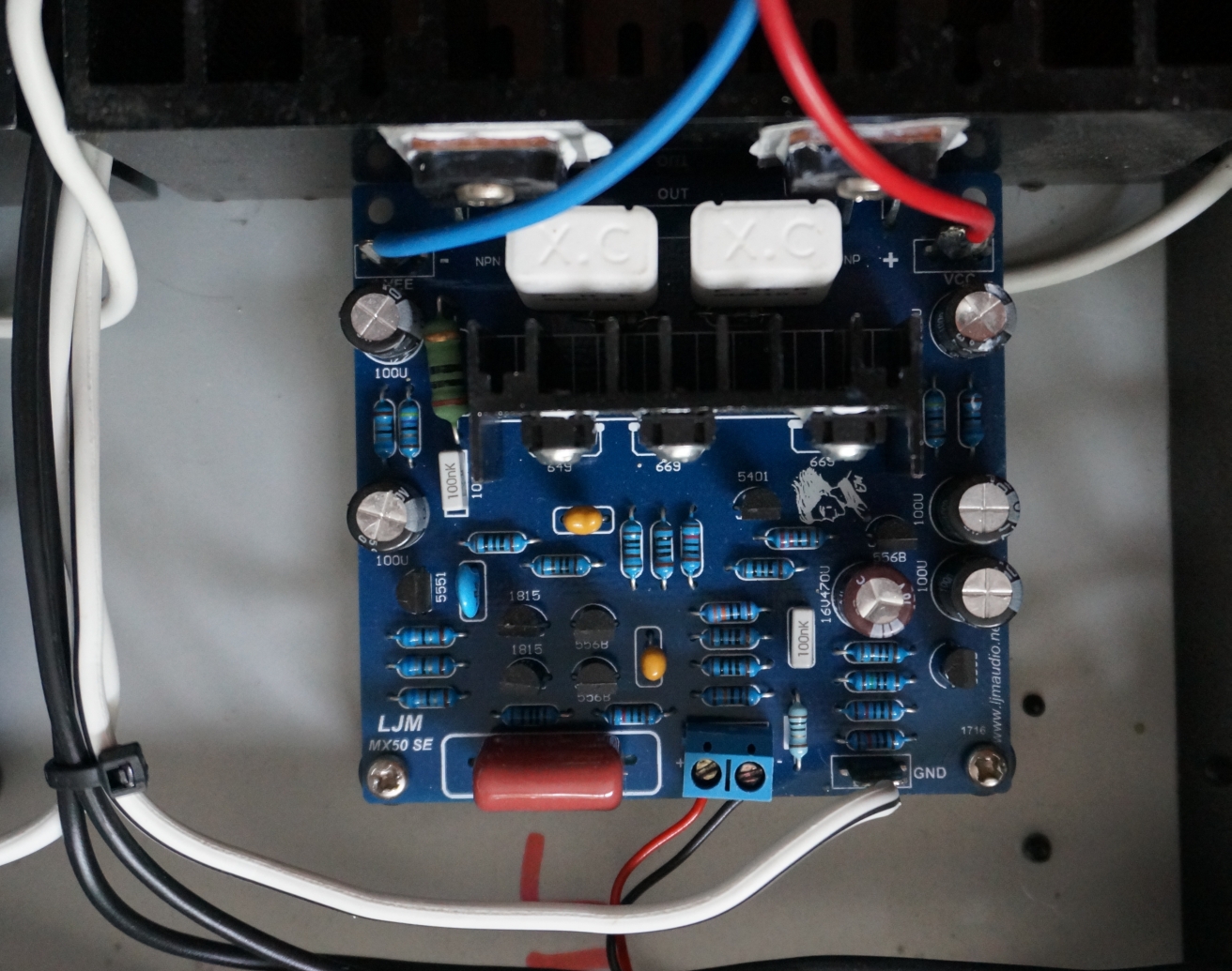

Here is a photo of the amp with one Vellemann replaced with a MX50SE, the other MX50SE waiting on top.

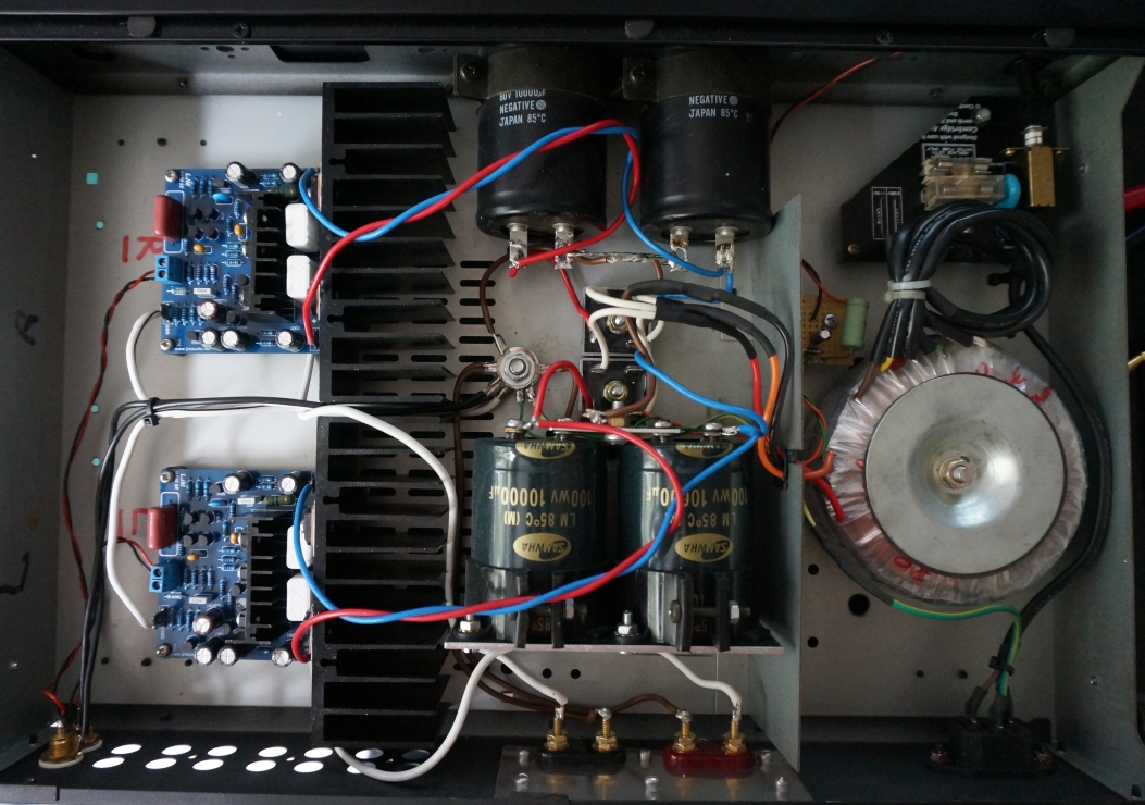

How the heatsinks ars cooled, I don't see any ventilation openings under them?
The 669 you replaced may have had lower gain compared to your original - or it's a fake transistor but in this case works better than the real thing.

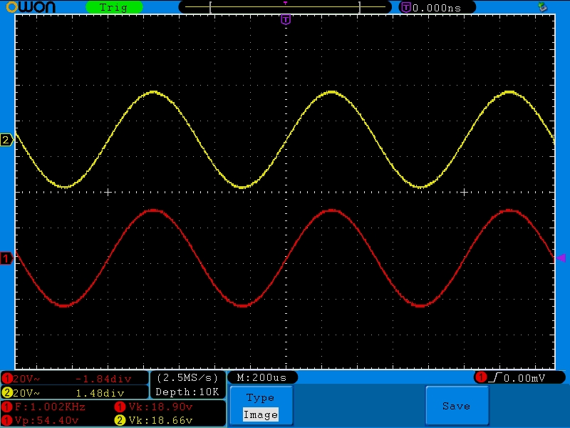

Regarding distortion - I don't think mine is that bad - I'll measure it later today and report back.

Now that the bias issue is sorted, it seems like the natural convection is sufficient, there is space under the heatsink and the top of the enclosure is perforated. If it turns out to run hot when used for extended periods, I can make openings in the base of the enclosure. This amp is mainly intended to be used for bench work (I build loudspeakers). My music amp is an old Accuphase 🙂

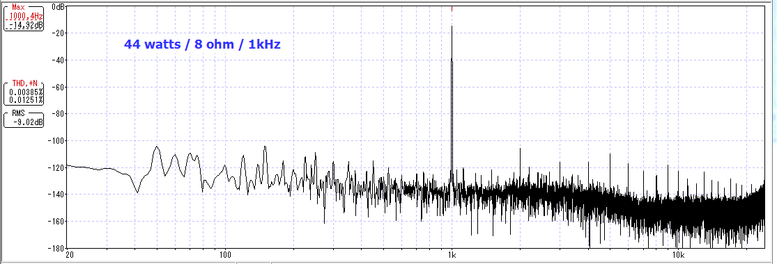

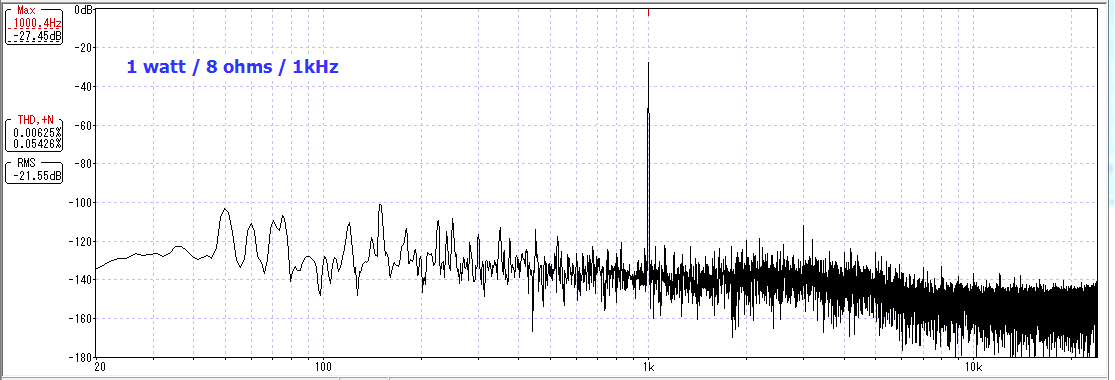

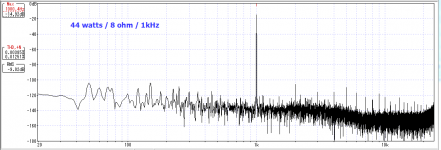

The THD on my MX50 is 0.0062% @1w / 1kHz and 0.0038% @ 44w / 1kHz
Mine is running 38-0-38 DC rails.

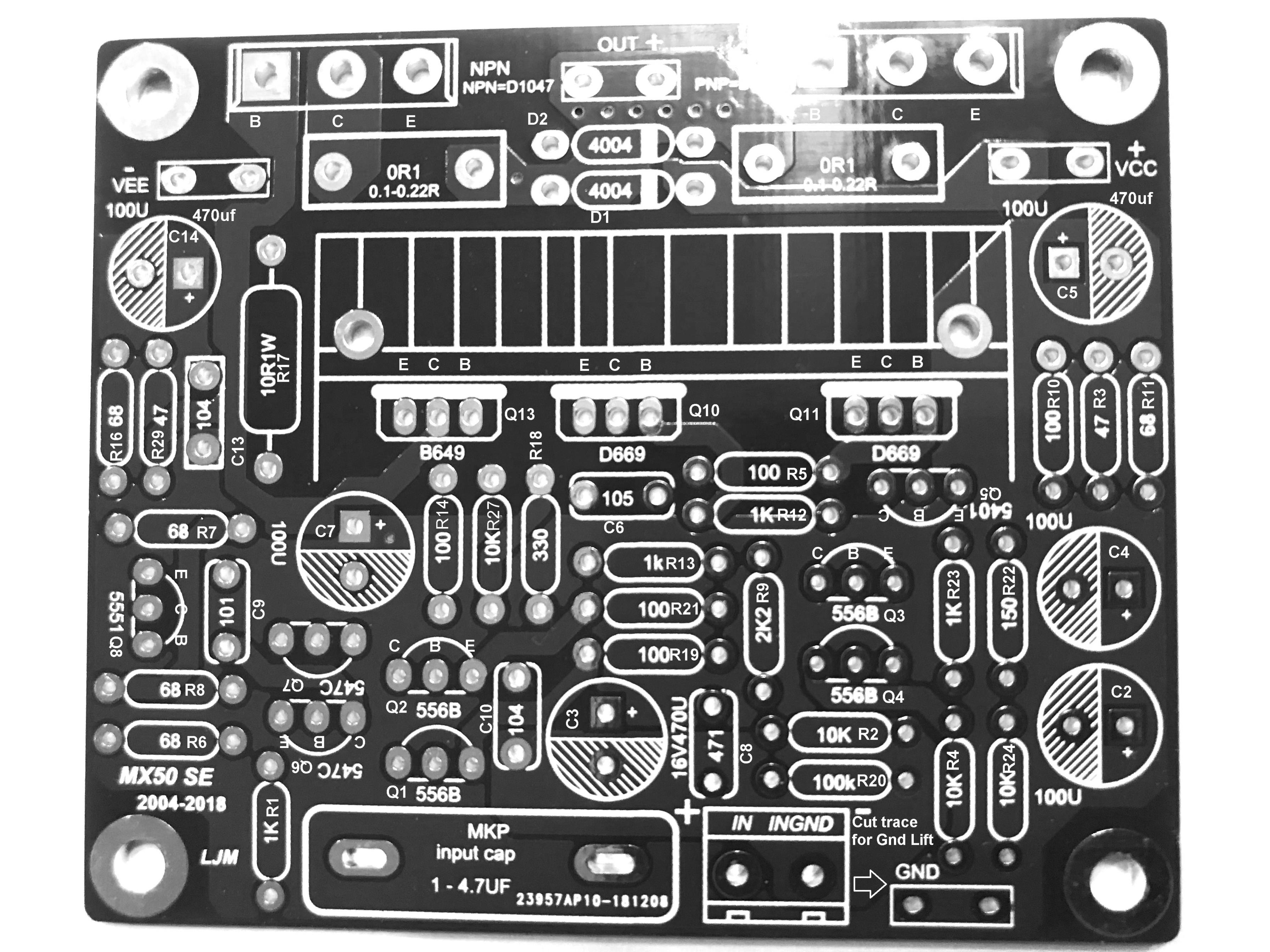

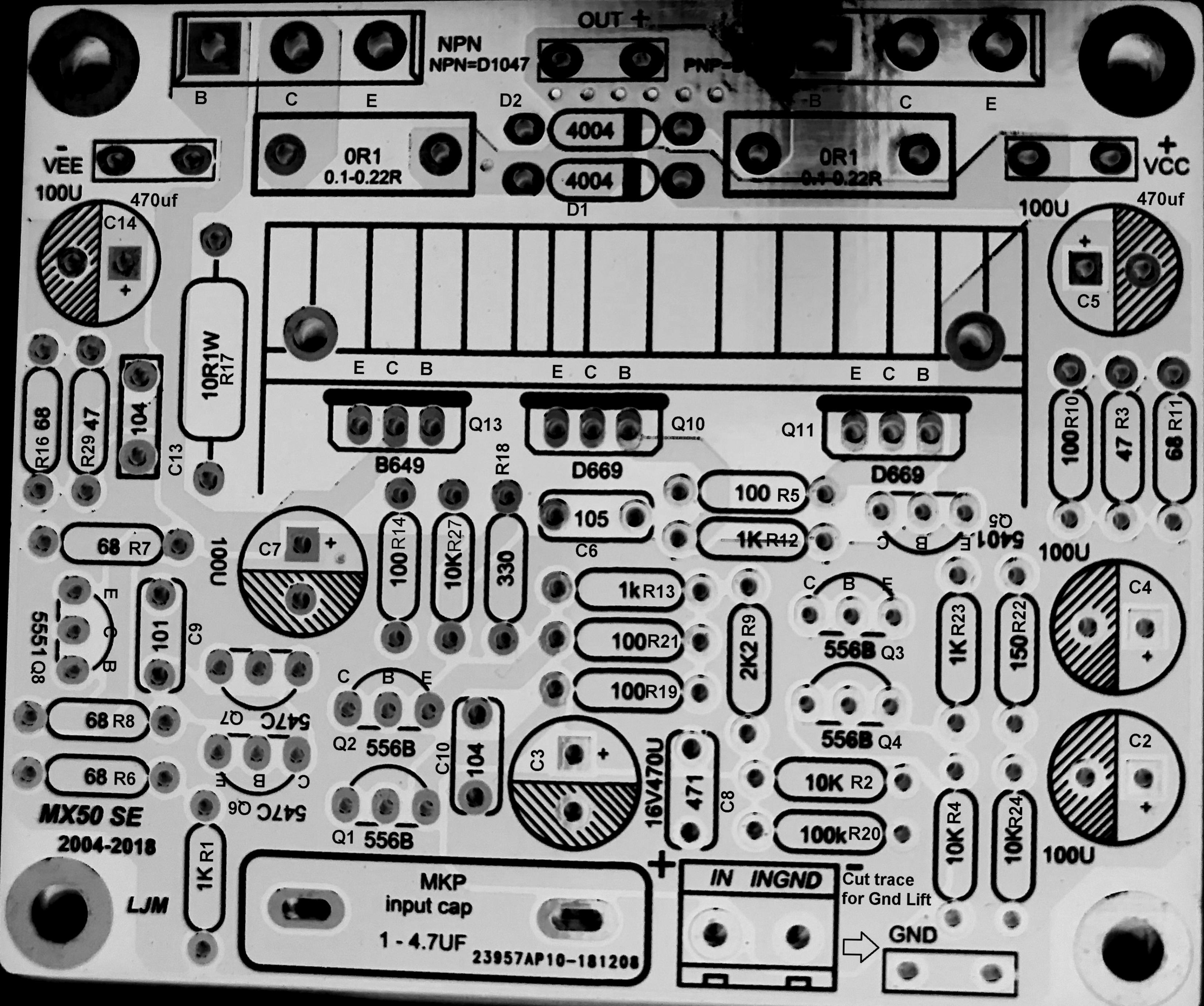

I have attached pics of my amp board so you can compare.
Incredibly low distortion, thanks for sharing. You have a different print layout, it must be a later or earlier version, but which?

@miallen, the bias problem/running hot issue is fixed, it was the Q7 669 that had to be replaced. Amp running normally now, no hiss or hum or DC offset. Re, SMPS - if these are suitable for power amps or not, I suggest it depends on the SMPS - but it is indeed very odd I have 50 hz on the rails - that is definitely worth investigating. I shall check if there is less distortion and noise when running on the bench supply.

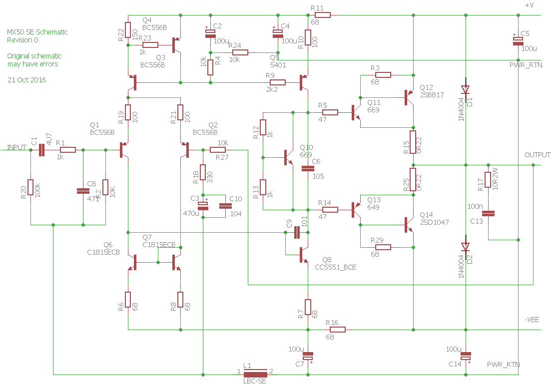

Final schematics
Request the buildes of this amp to publish the schematic "as built"...

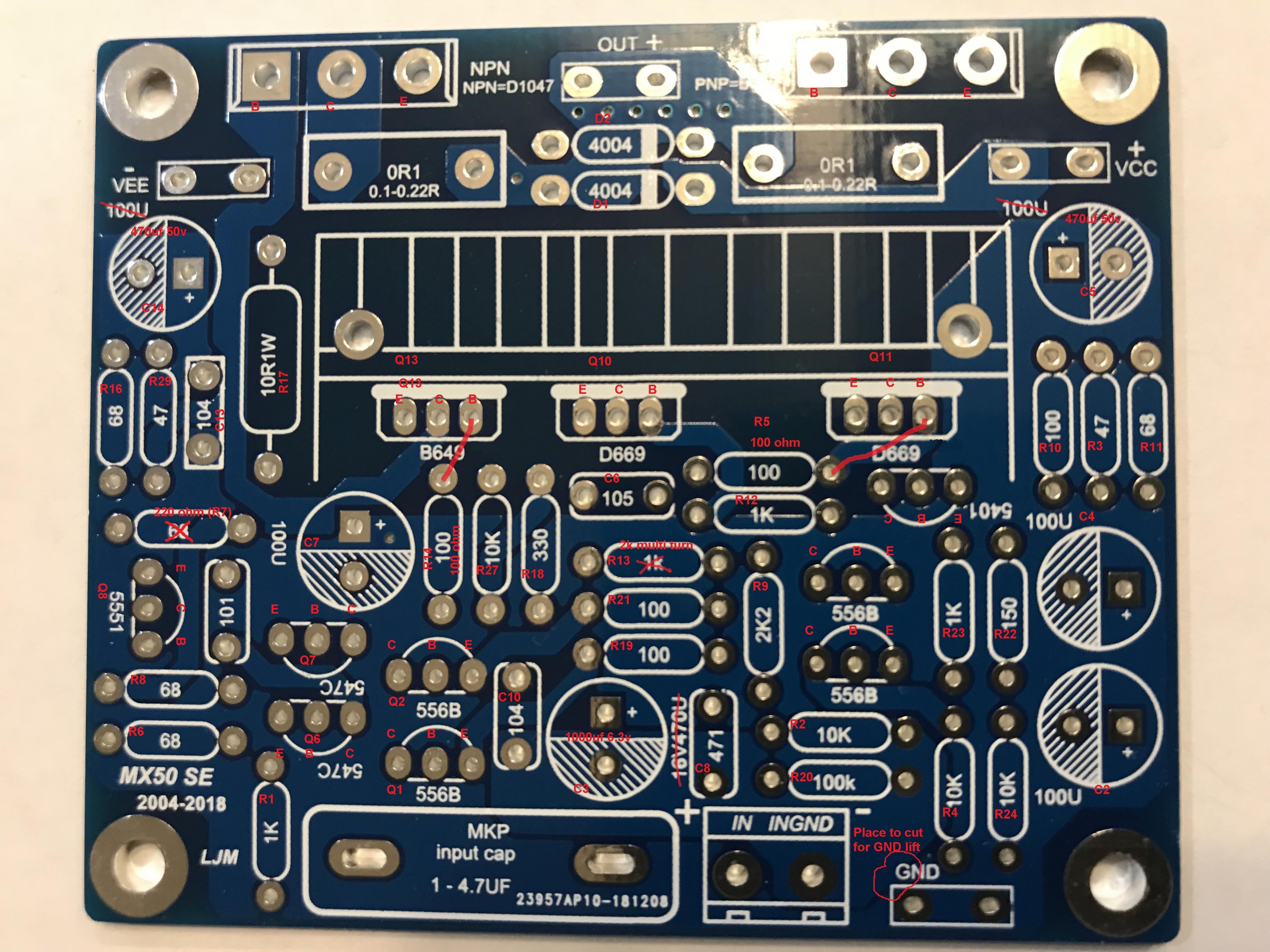

Component location on MX50SE board
Hello all... I used the schematic that slowhands uploaded to this thread...
MX50SE LJM 2015
and labeled the board with component locations.
I just got the boards last week and purchased a set of 2sa1186 and 2sc2343 from Digi-Key.
One question is on the schematic it shows R3 and R29 as 68 ohm but my board shows them at 47 ohm. Should I leave them at 47?
Thanks all for all the info on these boards..
Hope it helps someone.

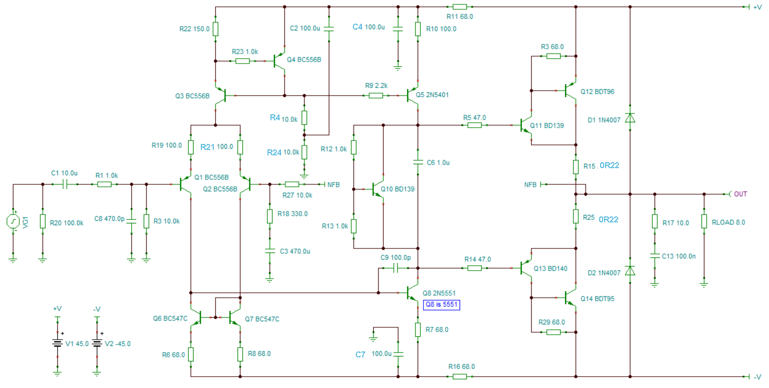

MX50SE actual schematic
Here's the actual schematic for the MX50SE - I reverse engineered this from a board I bought about 10 months ago.
As this was drawn for Spice you can ignore the voltage source at the input, and the resistor (RLOAD).
My spice software changes 0.22 ohm to 220 milliohm hence the odd value.
Technically it's correct of course.
