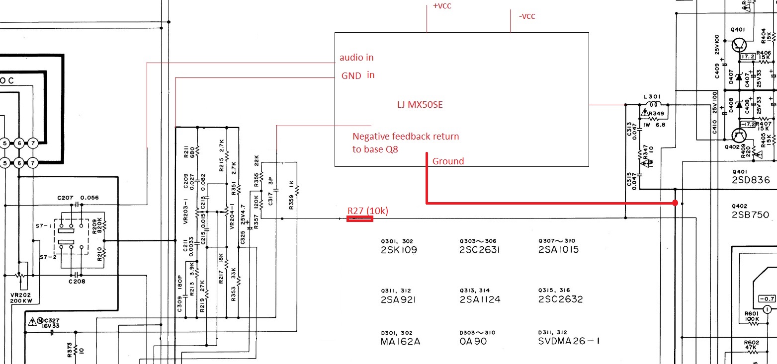

Hello Ian,
This amp is from a friend and the caps have already been replaced (I checked values and polarity just to be sure but that's all fine).
I did exactly that, I removed everything after the volume control and took my signal and ground input from there. For now tone controls aren't connected so ignore R27 (it is still in its original place on the mx50 board.
Adding the tone controls doesn't change the stability of the amplifier from what I can see, it simply adds gain and amplifies the hum I'm already seeing without them. To recap, the only things connected to the original su-v4 circuit are signal in, signal ground in, ground in, + and - supply rails and output.

OK, that's not a problem then. I read it as you were keeping the tone control arrangement located in the SUV4 amplifier feedback loop. That definitely would require a careful match to the amplifier because of how the loop affects the amplifier's Nyquist stability.
A preamp with tone, volume, balance etc. controls located before the amplifier can be considered as another device, provided it's signal grounding remains isolated from the chassis except for one ground point only and ground itself remains intact from input through to the power amplifier output. That condition is for safety and to avoid forming signal ground loops which impose mains (50Hz) hum on the signal. 100Hz hum is generated in the power supply and could even be caused by old caps or more likely, incorrect separation of star earthing for the amplifier and/or preamp power supplies.

Well that was the goal actually, I tried it and it definitely works. The only thing is that as I have some hum it gets really loud with the tone controls inserted (those add about 20db of gain). But for now I left them out again to concentrate on finding the origin of the hum.
Before the power amp there are the loudness, high filter, low filter, balance and volume (I must add that activating the low cut filter changes the hum to a higher frequency). Ground works its way from chassis at the input rca all the way to the input of the power amp, the output has takes its ground connection from the power supply ground between the two filter caps and then directly to chassis next to the heat sink. As you can see on the schematic there really is just one power supply, the unregulated part feeding the outputs is then being regulated and fed to the riaa circuit and IC303. As I said caps are new.
Connecting signal ground in to the power amplifier ground makes things a lot worse. I find this not really surprising unless I understood you wrong, you did mean to connect the "gnd in" next to the signal input on the mx50 board, to the power amplifier ground (in the case between the two filter caps) ? Also the mx50 has 2 ground terminals, signal in ground and a ground terminal for the rest of the circuit, filtering and zobel network. They are connected through an inductor.

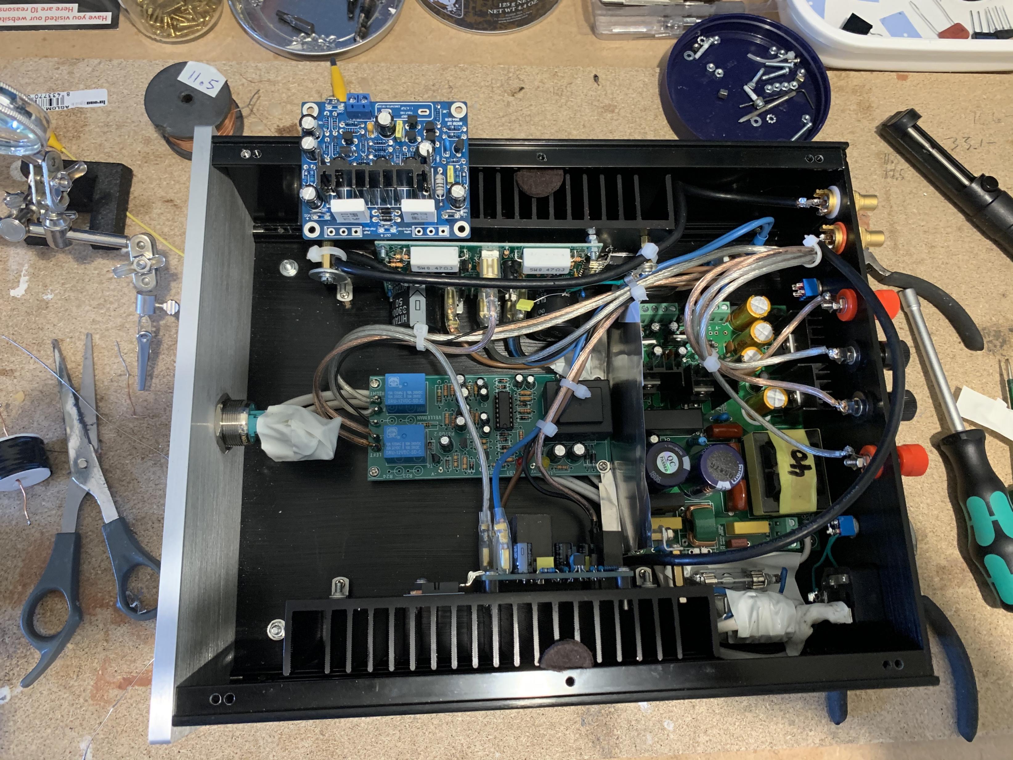

Folks, re. bias: following assembly of two of these I notice one runs quite bit hotter that the other, also when idling. Anyone experienced of thermal runaway of these amps?

Have you checked for oscillation?
Also - I think that 4uH is a bit high for the output inductor. I would use 2uH or 2.2uH and also reduce the resistor to 4 ohms or so.
Is it running hot with or without a load connected?
What are the voltages across Base / Emitter on both output transistors?
Are these voltages the same on both amps?
Also - I edited my post - did you see my comment about the output inductor?
Self recommends about 2.2uH for most of his amps. (10 turns on a 25mm former)

Can you post a picture of the modules you have?

That's a nice chassis - you've done a good job there.
I had those same Velleman modules (they were based on a 90's Elektor design - "70 to 100 watt amplifier")
I thought the Velleman modules sounded better than the MX50 lol
I note you are using an SMPS - I wonder if this is causing the MX50 to run warm?
My MX50s are cold when idle.
Have you checked the PSU line for noise?
Maybe you need some additional PSU decoupling close to the boards.

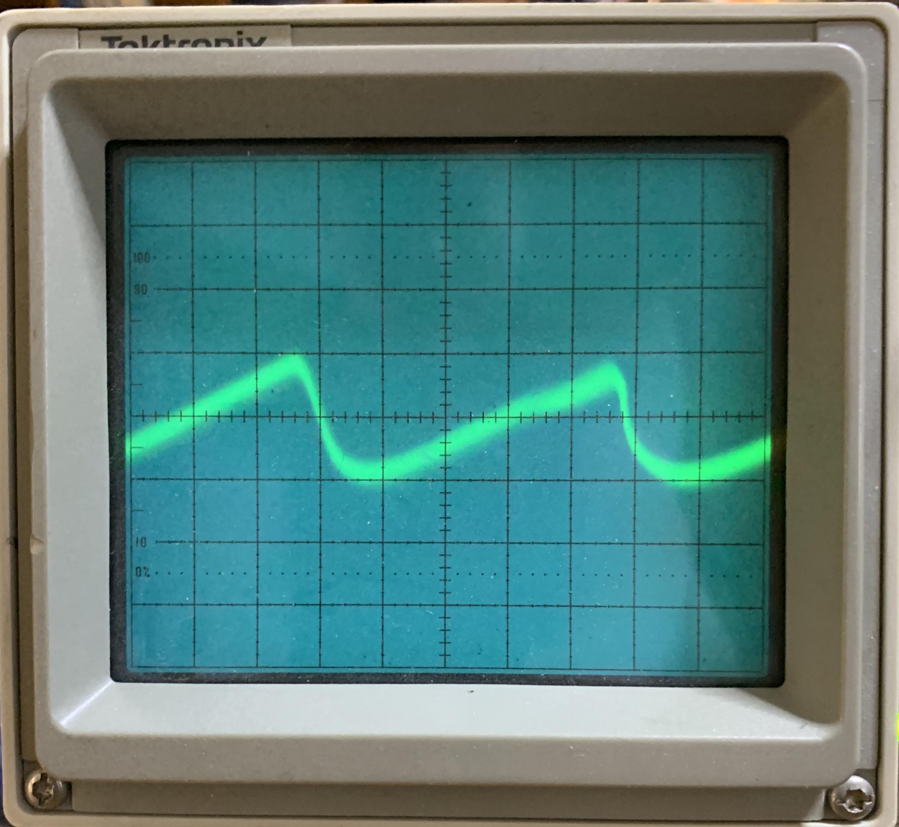

Thanks! - Here is a photo of one of the rails, 200 mv PP 50hz, not much SMPS HF - should be OK? At full load voltage drops 3v with music peaks...
But I have the reason for one of them running hot - bias current results in 35 mv over the 0.22 ohm, while the other has only 3 mv. I used a Q7 669 from my stock rather than the one supplied with the kit - maybe the reason... so change transistor (tricky with this PCB) or adjust bias..

There could be some HF superimposed in that ripple. (the waveform looks a little noisy, unless it's your scope).
Ideally you need to run it through a high pass filter and then if there's any HF ripple.
The 50Hz ripple is low enough though.
I would also replace / fit the correct transistor as that could be causing you issues too.
Yup, changing the Q7 669 to the one with the same number from the kit helped, odd. Bias now ok. Not sure what to do about the HF on the rails, maybe some 100 nF to earth. I am not totally impressed with distortion on this amp, runs around 0.02%, rising to 0.1% at high frequency.
