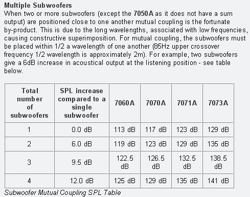

from "Loudspeaker and Headphones Handbook",
author John Borwick:
" The acoustic impedance acting on a single source is changed by other sources being in close proximity. ....So, at low frequencies, the radiation resistance of each source is doubled, and the power output of each, assuming that U remains constant in spite of the increased loading, is also doubled. The total power output from both sources, as compared with a single source, is quadrupled...."
In practice, Genelec says:

I was messing around with winISD to see what SPL it predicts for two drivers versus one. They show 6db(at any frequency, I guess they dont take into account distance between drivers). But when I played with the parameter box and doubled or halved Sd the results were exactly the opposite. Double in Sd caused a 6db DECREASE in maxSPL and halving Sd caused a 6db INCREASE in SPL.
Now I think that is kinda flawed due to the fact that changing Sd will change nearly every other parameter. The transfer function, however, doesnt change with a different Sd imput, but the max SPL does....
I also did a sim to see how many drivers it would take(mutually coupled) to achieve over 120db @1w 1m
3000 Tumults apparently....
WinISD also does some funky stuff when you use closed box and try to simulate infinite baffle. As the box keeps getting bigger and bigger, SPL and transfer function begin to decrease
