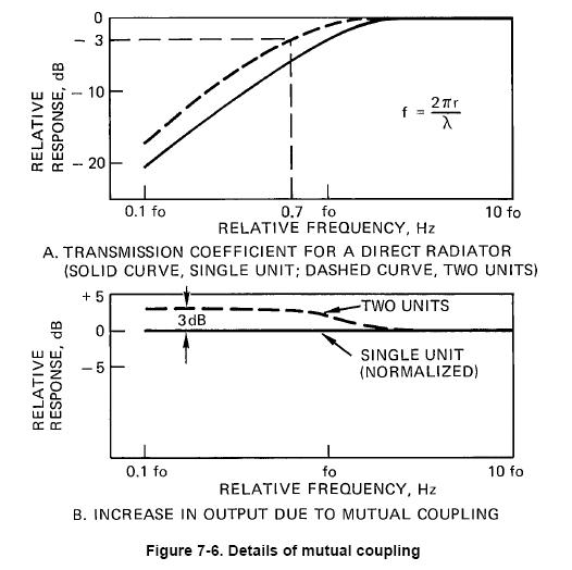

Was reading this again because I want to build a sealed subwoofer using mutual coupling to give a boost in the right area (when they start rolling off). I've never found an equation that tells you how to know this. I do believe the effect starts at 1/2 wavelength and you get a full +3 db at less than 1/4 wave spacing.
BTW the right way to look at this is that the extra efficiency is always there but just somewhat "covered up" by the drivers being out of phase until they are sufficiently close.
About 4' of 5' apart seems about right to boost below about 50 hz
Was reading .... I've never found an equation that tells you how to know this......

thanks I'll have to look at that. It seems obvious that say you have four sealed subs. You want to set the distance between them so that any two are within a 1/4 wave distance of the -3 db point, and then all four are within a 1/4 wave distance of the -6 decibel point. My own tests with dual sealed subs have produced really good sound quality that is very adaptable to room gain.
Tapering off of the coupling effect
This works because the speakers aren't very efficient to begin with.
For those wondering about the conservation of energy.
As you get more and more woofers, the coupling effect tapers off.
So you might get +3dB free efficiency for the first pair, then +2.5dB, then +2dB and so on as you keep doubling woofers.
One obvious reason for this is that the multiple woofers take up more space and are thus farther away and can't couple as well.
But even if you could create a big bass tunnel to try and couple all the drivers close, the acoustic pressure each cone exerted on another would eventually restrict cone motion. A bit like the cramming multiple speakers into a small box analogy. The more impedance matched a woofer is to the air to begin with, the more pronounced the effect.
Let's say one woofer increase the air pressure by a pascal from ambient (about 12 grams of resistive force to an 18"), another woofer nearby can easily keep increasing the pressure to two pascals and the motors can easily handle the 24 grams of force. (There is probably far more resistance created by cone inertia, suspension losses and by the woofer box air than the air it radiates into) It loads down the cone of the other speaker and increases the work done on the air by the speaker. A bass speaker can just as easily move with two pennies on it as with one, but eventually the back pressure applied to the cone will restrict its motion in the case of multiple 18" firing into a car cabin.

The simple answer as to why there is a +3db increase in efficiency is IMO the extra magnets. Extra magnets increase efficiency (to a point of course).
The reason it only works within 1/4 wave distance is simply that as the two sources get farther apart they are out of phase. There can actually still be a coupling effect at farther distance at certain angles.
What you're describing in your post is more what would happen in a small space at insane volume levels, where there is too much kinetic energy in the air. Mutual coupling diminishes mostly because of electrical reasons that some people here understand better than me.
Having a stronger magnet (along with lighter, lower resistance coil wire) does improve efficiency, as does having a lighter cone, fewer suspension/spider losses and also an amplifier with a lower input impedance.
But this is not the main reason related to multiple speakers and air coupling. First you have to understand that most of the energy cost of the speaker is in moving itself e.g. you'd use only slightly less power if you used your speaker in the vacuum of space. (Assuming an infinite baffle because compressing air in an enclosure accounts for a high energy cost too compared to work done on the outside air).
Now understand that to double the air pressure a speaker has to move about twice as much (for small signal levels not engine cylinder or bicycle pump level pressures). This requires 4 x the amplifier power because the cone velocity is twice and the resistive forces are also around twice and power is force x velocity.
Two speakers in close proximity can also double the air pressure compared to one. And this only uses twice as much power as one to create 4 x the sound energy. Of course, the back pressure on the cones is now twice that of on one speaker, because one speaker created a pressure wave that tries to push back on the cone of the other speaker, and the voice coil of the other speaker has to push the cone against the original air AND the pressure wave from this speaker. (You can see that the sound waves from a woofer will be able to set the cone of a close by un-powered woofer in motion out of phase)
Again, the extra amplifier power used to push against this pressure wave is negligible as most of the energy is spent moving the speaker itself. Say I want to move a pile of apples to the top of a hill. It's a bit like comparing the energy I use to run up and down a hill carrying 2 apples at a time vs carrying one apple. I only use slightly more energy carrying two apples at a time but I get twice as many apples to the top. In this case the apples are air atoms and I am the big heavy speaker cone.

Two acoustical reasons:
One rason why mutual coupling has diminishing returns for more and more speakers is because as you stated, the waves can become out of phase.
The other reason is that sound energy radiates under the inverse square law so as the speakers are moved apart, one speaker with its sound wave no longer exerts as much back pressure on the other speaker. If you moved the speakers to be one wavelength apart, they would be back in phase but the added distance would reduce the transmitted back pressure each speaker sends each other. The combination of phase plus distance forms this decaying roller coaster type graph of mutual coupling's effective distance.
One electrical reason is that like an electric motor, a loudspeaker is most efficient at converting power into sound when there is a certain amount of load on the cone. As you keep doubling up speakers (maybe you confined them in the sidewalls of an open ended tube to reduce inverse square law effects, and you time delayed the drivers closest to the end of the tube to reduce out of phase effects), the load on each cone increases. There comes a point when it is hard for the speaker cone to move.
This varies from speaker to speaker. In most cases, the load on the cone on the side of the air we hear is almost always too little but it could be too much if you tried to build a really high compression horn and load it with a guitar speaker with a tiny coil.

It sounds like you're thinking about it more as a physical movement of the air, like the way that a turbine or piston moves air. Sure there is fluid dynamics involved but its not really what's going on with mutual coupling. I used to think so but have changed my mind.
Mutual coupling is very predictable with distance and angles, and its clearly a matter of being in phase or not. If it was about the efficiency of moving air then you would still have some effect for sounds that aren't within 1/2 wave. Further it would vary greatly with total volume but coupling doesn't.

Well technically it will be a +6dB although you'll have to get exactly in the right spot as the wavelength is just over an inch at this frequency. The coupling is from the pressure of one wave adding to the pressure of the other wave as they collide at the same time.Alright, I'm certainly not an expert and not sure that I care enough to seriously debate this. But consider this. Two 8" drivers playing a 12 khz sine wave spaced 4 feet apart. If you stand exactly equidistant between them there will be a +3 db bump. Now why is there this narrow area of coupling? The drivers are completely beaming at this point and far apart, so the sound waves from each driver aren't affecting the other one. So the effect isn't from the interaction of the drivers with each other. Its inherent to the sound from the drivers themselves being in or out phase.
In other regions there will be a cancellation because the pressure of one wave will enter the partially evacuated air of the other wave, creating normal atmospheric pressure. The average energy increase is +3dB just from there being two sources of sound energy even though they aren't loading each other significantly.

A simpler reason though for mutual coupling is that the ratio of air pressurised to mechanical and electrical losses improves with multiple speakers. 1 speaker moving twice as far has 4 x the losses and 2 x the sound pressure. 2 speakers have twice the losses of one and 2 x the sound pressure.

Mutual coupling is not free output nor is it some mysterious unknown factor or unused performance capitalized, so much. It is two drivers acting as one and beaming as if double the size. this creates a 3db increase focused between them as a lobe rather than them combing. The energy from from two drivers in total does not change. It is the very same as a line array but in the simplest form. Another example would be that the same motor and magnet ...and power input...on a 15" speaker will generally have more output than a corresponding 12" despite all things being equal... but the 12" beams at a higher frequency.
