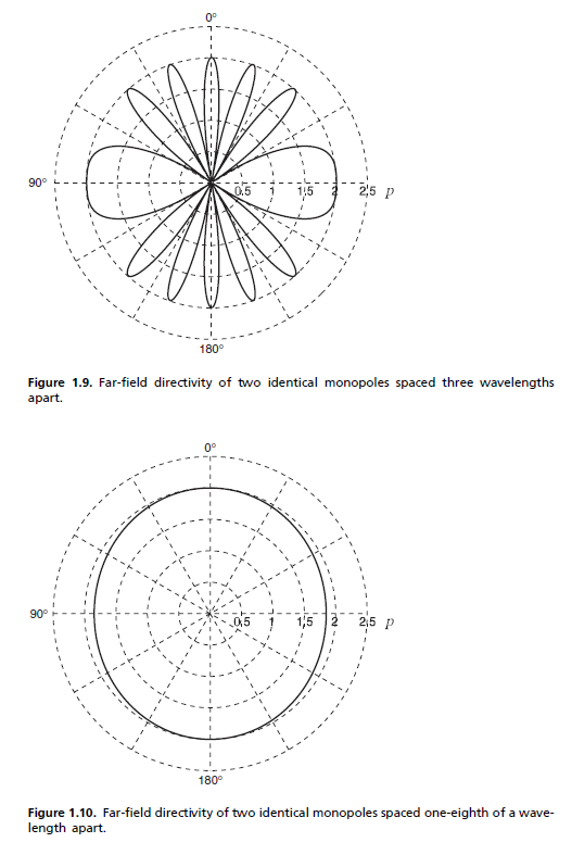

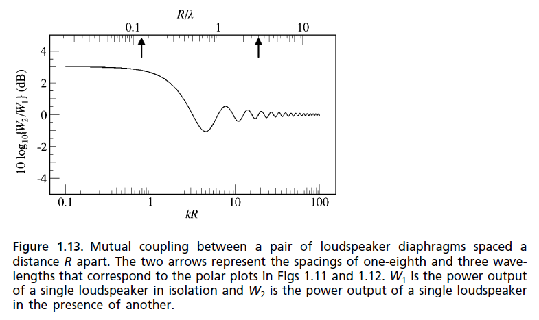

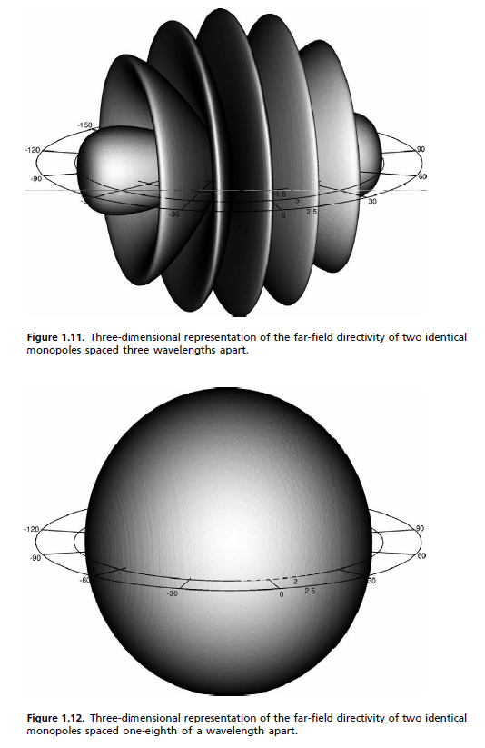

The attached figures show what others have described with words.
Attachment #1: Power gain for one source due to mutual coupling from another identical source. Upper X-axis scale shows ratio of spacing to wavelength.
Attachment #2: 2D polar response for 1/8 wavelength and 3 wavelength spacings.
Attachment #3: 3D polar response for 1/8 wavelength and 3 wavelength spacings.
In ideal free space (ie no room) when two identical sources are placed near each other:
- on-axis SPL will increase +6dB at all frequencies (compared to a single source).
- total radiated acoustic power increases +6dB at low frequencies transitioning to +3dB as wavelength gets small relative to the spacing, (compared to a single source).
The figures were taken from Section 1.4 in the “Loudspeaker and Headphone Handbook” which contains an excellent description and analysis of mutual coupling between sources including the effects on radiation impedance “seen” be the individual sources. In fact, the entire first chapter is a good introduction to basic acoustics relevant to loudspeakers as sources.
