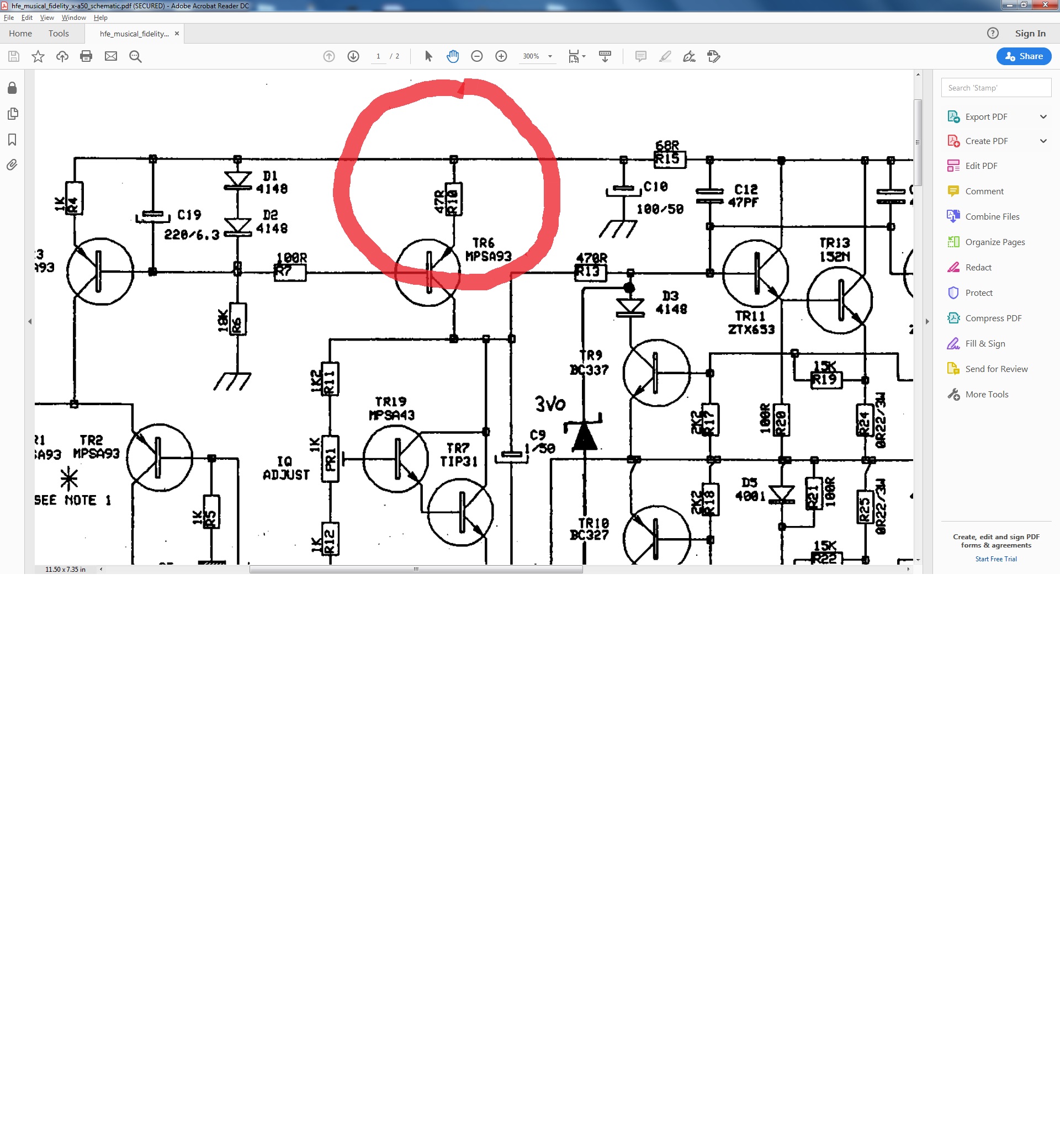

I suspect TR6, can you get one to replace
I will have to search my "stock" lol. Lots of old circuit boards.
If I dont find one I can always use the one from the other amp!?!
maybe try this, you take out TR15 and TR16(it is save to do that) and then replace TR16 to TR6, TR15 to TR8
I actually have spare ZTX653 and ZTX753 brand new as I had to replace the driver transistors (if thats what they are)
Should I still remove them or just replace the MPSA93 with ZTX753 and MPSA43 with ZTX653?
You can use spare ZTX653 and ZTX753 and no need remove transistors on PCB.
Yes, MPSA93 with ZTX753 and MPSA43 with ZTX653

TR6 and TR8 was very hot!!
The resistor R10(47 ohm) control TR6 and TR8 running current(21mA) and it is quite high for the transistors needed.
TR6 and TR8 running half current 10mA is sufficient for them to perform same sounding of the original amp, the temperature will be lower, safe and more stable.
To do that, replace R10 by a 68 ohm resistor.

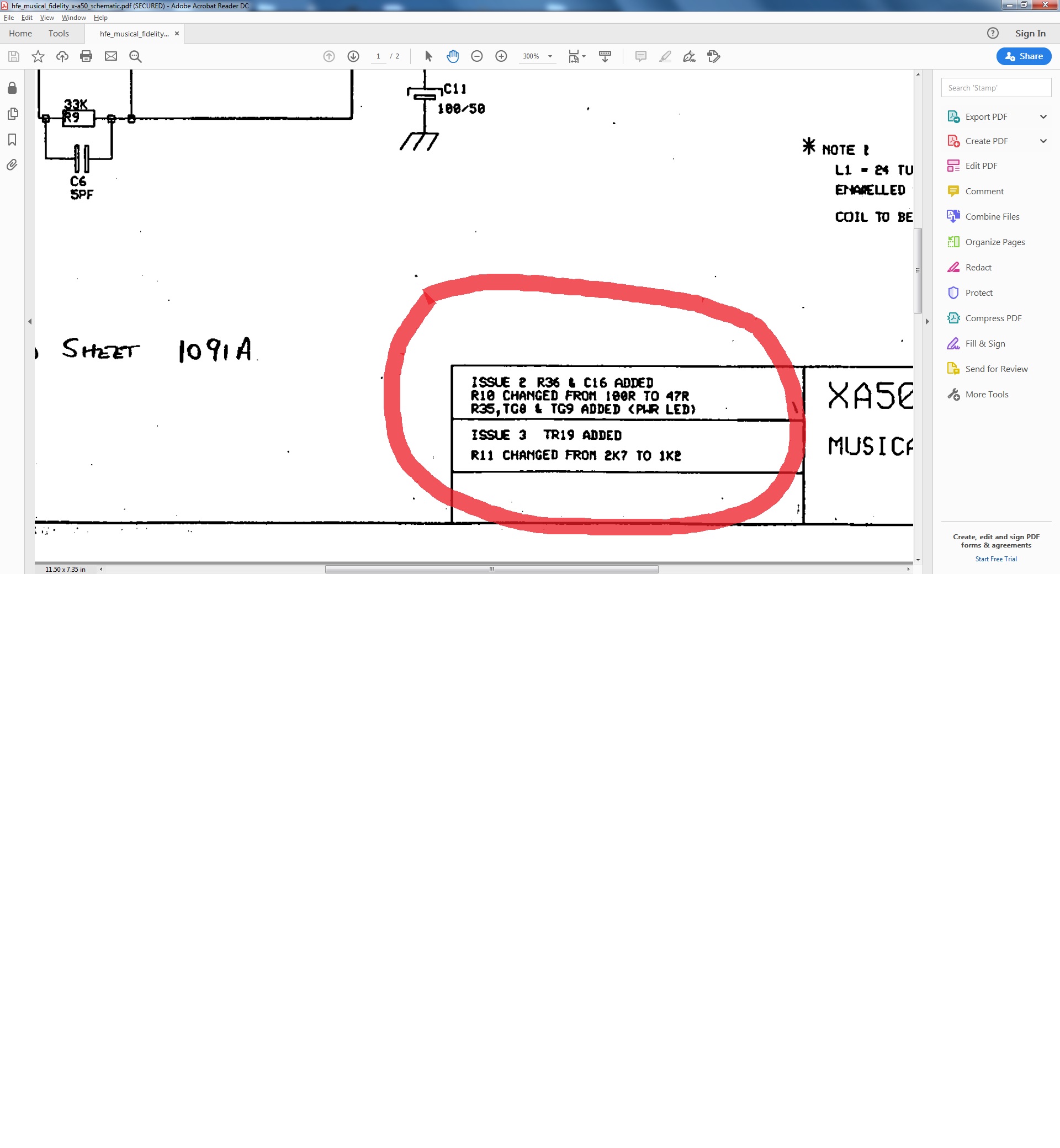

R10 is stated as 4R7 which is 4.7 ohms, but it measured 47 ohms! How did you know that!?!?

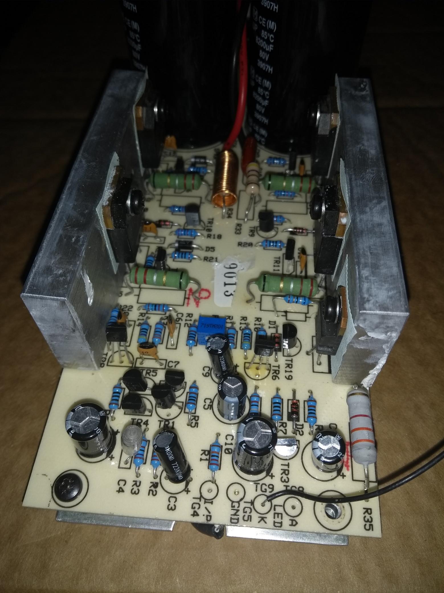

OK so I replaced it and it still gets hot much not as much as before and not as quick. Tested the DC... it went from 5MV to around 15MV and stayed around there.
I also measured the bias R24, this was around 2MV
I also noticed if I keep my finger on TR8 the DC would drop to 2-3MV.

The schematic showed R10 47R (you can check in #54)
With 10mA current is also a little high for these transistors(in normal amp design, they are only run at 3mA to 5mA), so that they are still hot, but you would not want to shift too much from factory design, so that let it run in 10mA.
When these transistors heating up, the circuit voltages will shift until the transistors temperature stable, after that you set the bias and it is ok for your amp.

I haven't adjusted the bias but can you recommend a good MA for R24 please. Its 2MA currently.

20mA for each power transistors is ok, so 4.4mv on R24
