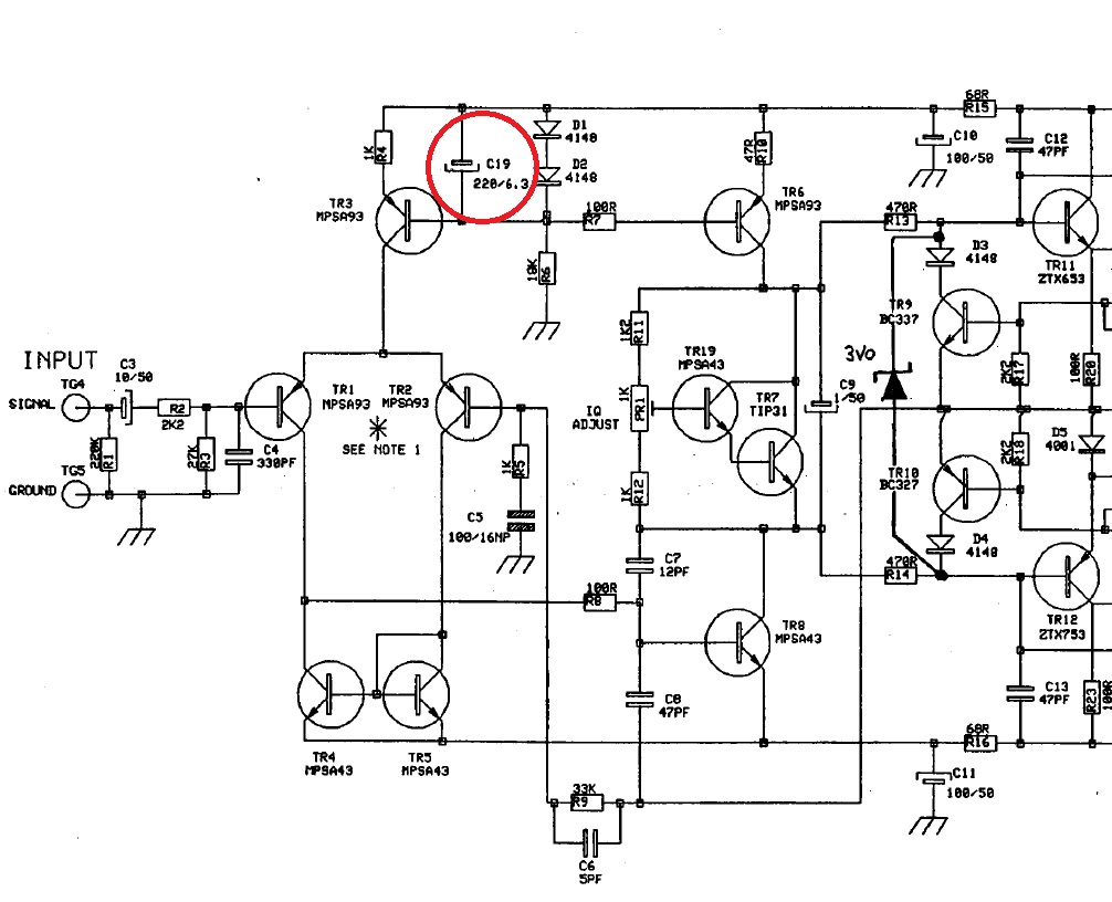

Do you mean a later version of XA-50? I don't think there ever was an easily identifiable, improved version but clearly, there was an ongoing number of modifications with at least some shown on the published copy of the original schematic. 'Problem is, how to know what the final state was at the end of production.
For some reason I didn’t take any photos with it opened up but it closely matches the schematic. Mine has “issue 4” on the PCB which is later than the shared schematic but the only difference is the zener diode “mod” isn’t there but that is drawn on the diagram so perhaps a non-factory mod.

I am also in the process of restaurating an old pair of X-A50 of mine. Bought them around 1999, used them for 1-2 years, when they started making extremely loud thumps when being switched on. When on, they worked fine. But I stopped using them to not risk my speakers.
A friend of mine thought it would likely be caused by faulty capacitors and changed all of them, but no, wasn't fixed. Then they slept in my basement until another friend of mine triggered the electronics interest in me again recently (I had done mostly digital stuff until then, that's why I did not dare doing anything on the X-A50s before myself). I now thought, why not and pulled them out there weird hosuings and started measuring with my 40 year old Hameg scope.
At first I was not very successful, until I blew the output stage of one of them as a result of a dumb mistake. Step by step I replaced transistors and finally after replacing TR8, the amp was working again, and without the switch-on thump!
I then only replaced TR8 on the other X-A50 and the thump was gone too! The 2nd TR8 which I removed only showed hFE of 20 on a device tester. Never would have thought that they could go bad this strangely. But searching the net I found it is not uncommon. This happenign after only a short period of using the amps is still surprising to me.

Hi, I am still in the process of rebuilding into a "real" case. All parts mostly ready now to be "married", X-A50 boards on heatsinks, protection boards, cap multiplier power supplies (I know, the amp should have proper PSRR, but simulating in Spice showed the ground noise to be sooo much lower with them compared to simple PSs, that I need to try) etc.
The other day, I stumbled upon a "gain structure" discussion. I checked and indeed the original gain of this amp seems to be overly high for my system. If I am not mistaken gain is defined by the ration of R9/R5, meaning it is over 30x.
I tried setting a higher value for R5 in Spice, which makes it easy to get the gain into the range of 10x, which would be much better, I think.
What I was wondering is if this changes the overall feedback. And if that was the case, I could get the same ratio with higher resistor values too. In Spice, the THD distribution and height does not change in a noticeable way when lowering the gain this way.
