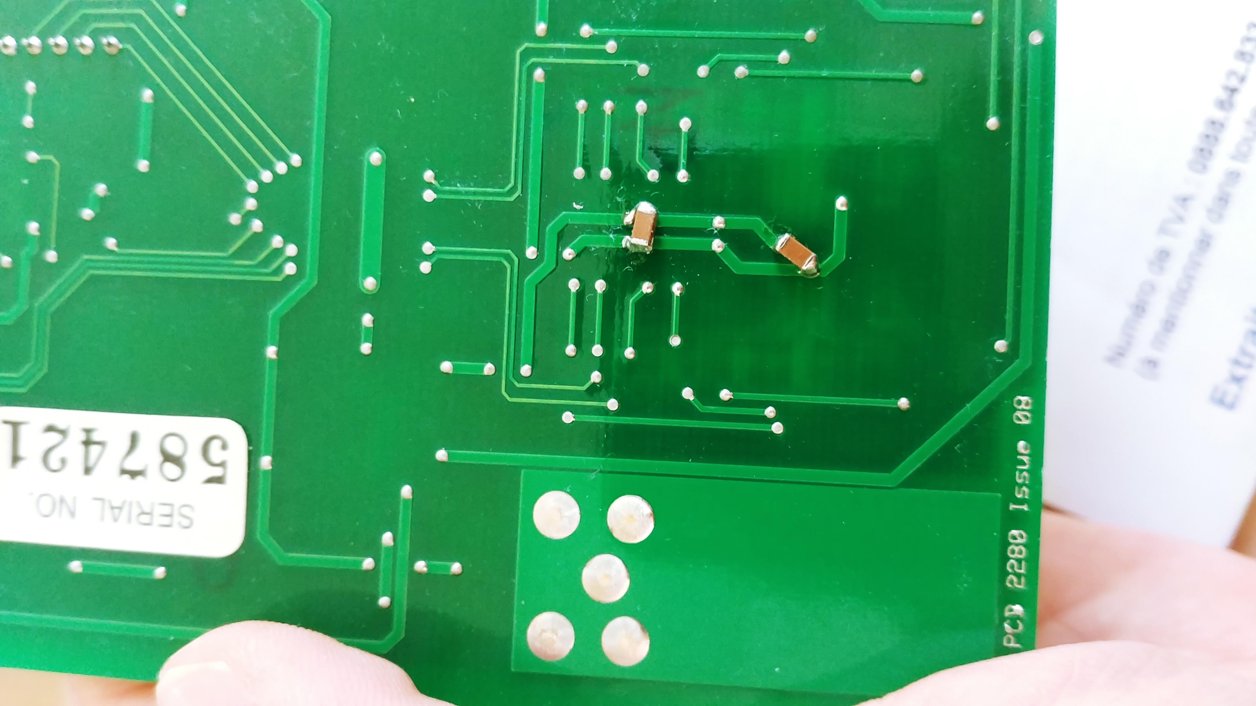

Investigated about power supply of thé i/v stage and power supply rails for op amps are long.
So added 4.7uF mlcc 35V capacitors near power supply of each opamp. Also added a electrolytic capacitor 100uF.
Since my preamp already removes DC from input signal, I just bypassed output electrolytic capacitors.
Nb: The vdac uses switching capacitor voltage convertor to provide positive and négative rails for thé i/v stage. No regulators except RC filters far from thé i/v stage opamps. I doubt that replacing thé stock regulators will affect a lot sound quality
