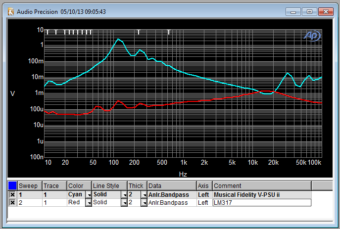

Will, I have found something which might be interesting for you. V-PSU II which you have is SMPS unit, and is much different from previous V-PSU which has toroidal transformer. As mentioned, it seems that the newer version is very noisy. Attached is the noise comparison between the V-PSU II and the ordinary LM-317 regulator, both under 100 Ohm non-inductive resistive and 100 uF capacitive load. These measurements are not mine. The vertical axis represents noise voltage multiplied by 100. It looks like that V-PSU II touches the 30mV ripple peak at around 120Hz.

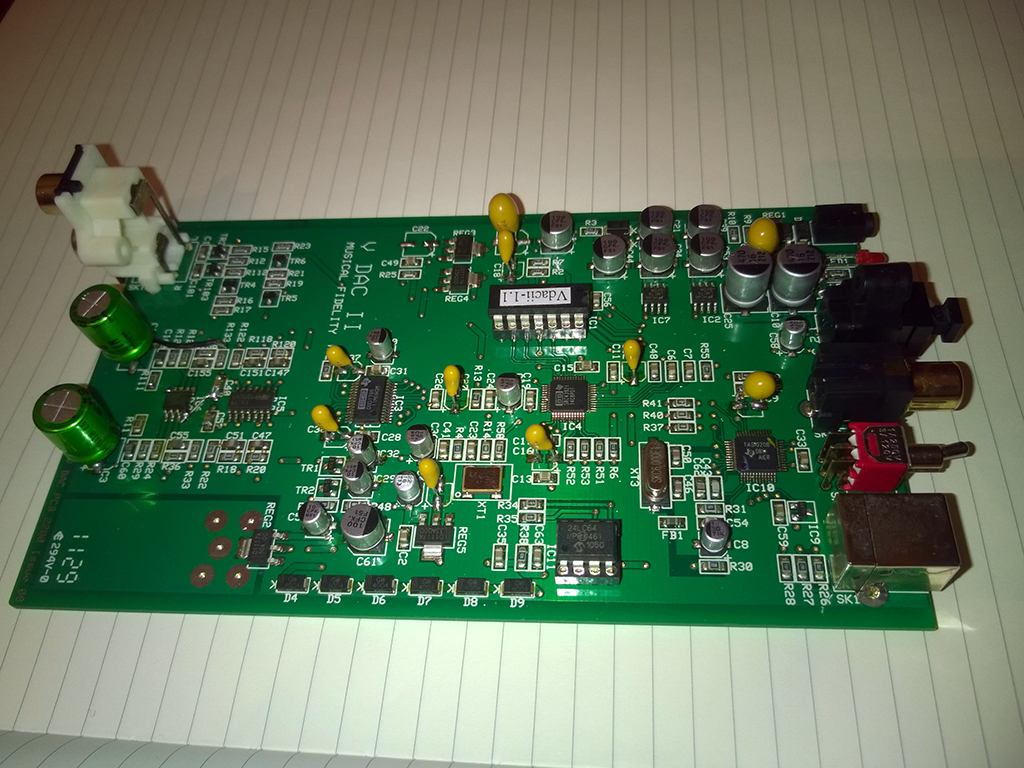

Update on MF V-Dac 2 modd.
I'm back. My computer got devastated by a bott and had to start over. Got a new Mac Mini to replace my aged Mac Power PC G4. Anyhow I am darned pleased with my mod of my V-Dac 2. It sounds so sweet. Quite, smooth, dynamic. The stage is more refined. It's wider with more separation of instruments. Lots more detail and presence. It's a real pleasure to listen to my music now. Very worth while effort.
I forgot to photograph the opamp install before I soldered in the caps but the enclosed pics might be of some help to anyone else attempting this mod. I know I could not have done the mod without the pics provided by Will. 🙂
Will thank you for your help!
Best to you,Marvin

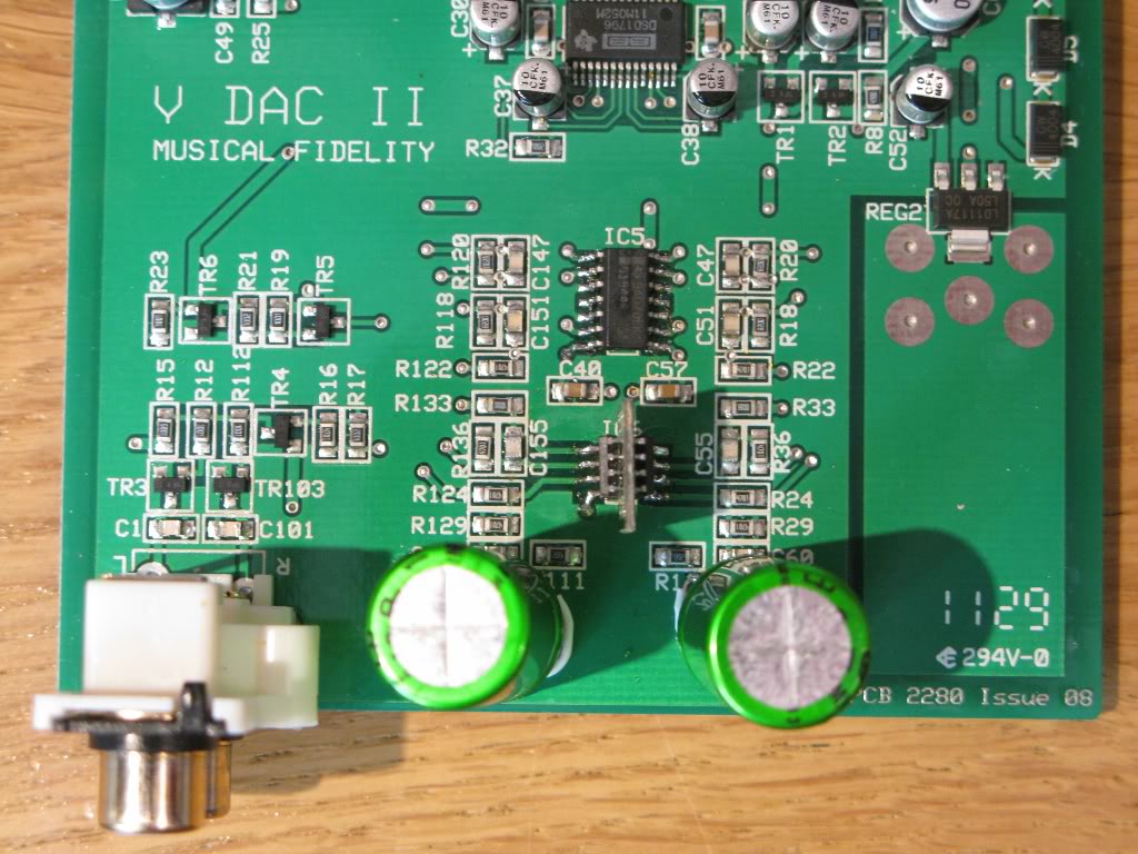

The output op amp in V-DAC is already bypassed: namely, C40 and C57 are ceramic capacitors connected between the supply pins and supply rails, which renders the third, in-between, bypass cap pretty much superfluous. In addition, for the purpose of bypassing I would suggest multilayer ceramic caps, instead of disc type.
Finally, I have also discovered that the supply voltages for op amps are not symmetrical: the DMM measures +10,5 vs. -13,5V on rails.
You're right about the bypass caps - so no additional caps under the board are required. I missed that in my original haste to mod. Thanks for the chart showing PS noise in the V-PSUii: That's a shame - MF must have cost engineered it (I feel another project coming on...). Nevertheless, it does improve the sound of the V-DACii. Speaking of which, what do you think of the sound of the VDACii with the mods? I'm now using OP1662 on other DIY projects - it's superb in my opinion, but does need hours of burn-in to sound its best. I'm wondering how the V-DACii + mods, compares with the new budget DACs? Schiit Bifrost and DACiT get great reviews for audio - it's mighty tempting to invest, but the modded V-DACii sounds superb with nothing to compare it against...

Only now it has come to my attention that there are no local capacitors surrounding the op amps in the analogue stage and that the 10uF electrolytics following the voltage regulators are pretty distant (reusing wiland1's photo as illustration). I added 2 10uF capacitors across C40 (Vcc- to ground) and C57 (Vcc+ to ground). The choice of 10uF is conventional wisdom for bypassing op amps and there is improvement in dynamics. But since one double and one quad op amp are fed from there, would more capacity, say 22uF or up to 100uF be more effective?
Here is what I did in 2012:
Choosing quality over quantity will pay off for C40 and C57.
Polyester film caps like WIMA MKS2 between 2.2µF and 4.7µF can be applied easily.
This V-DAC setup - still with its original OpAmps - was superior to a Yulong Sabre D18.
