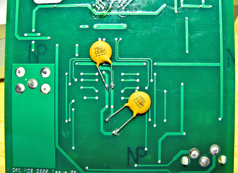

I think i've answered my own question: i went back to the OPA1642, but used 2 x OPA1641 chips instead on a Browndog. Then the solution to the bass: 0.1uF decoupling caps across the supply pins - really sorted the bass and balances the presentation generally.
So, if you're interested in upgrading the V-DAC2 opamps, i recommend the 4-channel OPA1644 and the 2-channel OPA1642, with 0.1uF decoupling caps on the supply pins of each one - sound is more transparent than stock, but maintains that musicality.

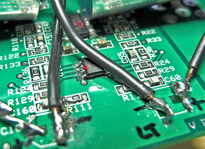

Only trouble is that i think those new OPA's are not totally happy - still slightly bass shy and harsh treble now (oscillating). As you can tell, i'm not a pro so cannot answer your questions. Here's a couple of photos:
And one of the underside with the dead-bugged PP Panasonic caps on the supply pins

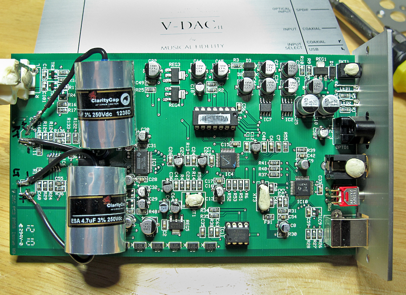

I'll try and take a photo of the whole board from above so you can check it out.

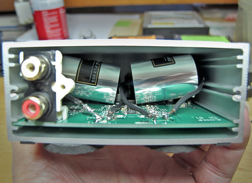

I've got some 4.7uF PP Claritycaps on order now - the VDac Mod thread on the forum suggested this would be a better option than a big Elec Cap. I wonder if that is the reason my bass is not right? I had heard that a big EC is a good solution for signal path DC blocking - it's the small value ones which veil the sound...

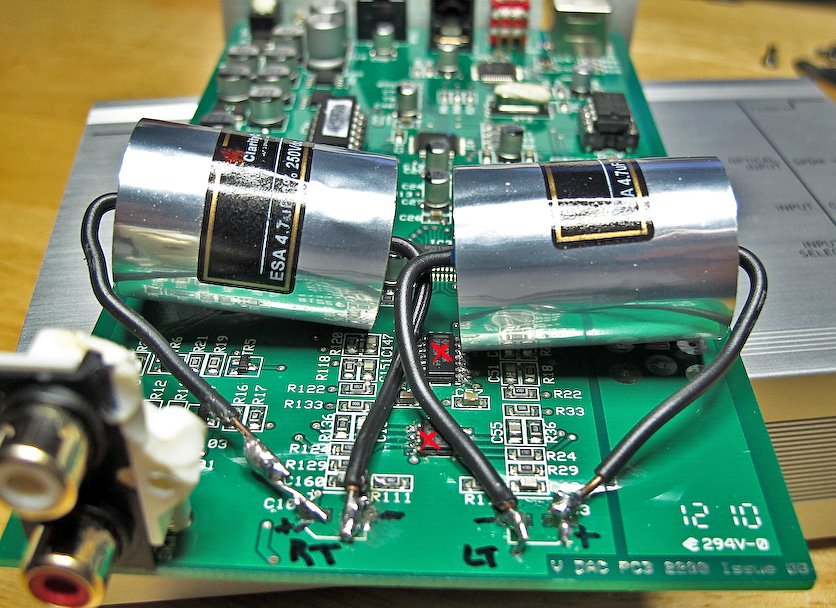

Here are 3 pics of the board for folks to look at - the three photos effectively stitch together. I've just replaced the 2 x 470uF green Nichicon ES Electrolytics with 2 x 4.7uF Claritycap PP caps from Falconacoustics - they're big and only just fit - and it sounds fabulous. Really clean, natural, balanced sound now, with lots of space around insruments. And it's still running in! So the advice about using PP caps in the signal path appears to be very true - if you can make them fit :).
Hi Marvin - I cannot remember for sure, so i'll take the cover off and have a look this evening just to be sure - i'll post up another photo for you. What you describe sounds exactly right - i used the biggest ClarityCaps i could get in there :)
Since the post, i also experimented with the output Opamp and i am pretty sure i ended up with the OPA1662, which sounds beautiful, but let me check.

Hi Will, thank you for your response. I would really appreciate the photo as a reference. This morning I ordered from Mouser the OPA1642 and 1644, one each. From PartsConnection I ordered ClarityCap ESA 4.7uf/250v, 2 each.
I have searched all over the WEB and it seems few people have modded their V-DAC 2. So I was really pleased to find your post. I'm not a tech or EE, I just copy from others; so far so good. After I finish with the opamps I'm going to find a way to change the RCA connectors. It seems a bracket would need to be attached to the board were they are are now. There's room to do it. We'll see.

Hi Marvin - I can't tell you what a difference it made to the sound. running an ipod classic through this modded VDAC2 is really stunning. Forgive the state of the board in the pics - it's had a lot of opamps on and off! you can see that the ClarityCaps are tight in the case, but so long as their wires are well anchored by solder on the board (and you will need to drill holes in the board for them), they do not need a bracket - they hover just above the PCB and although they touch the sides of the case, I've never suffered any vibration related issues in the music.
As for Opamps, well this is where I came out: The OPA1654 and OPA1662 are definitely better sounding than the 1644/1642 - you'll have to order them! The 1662 is very musical and detailed. The 1664 was not available when I ordered, so I went for the 1654 and am not disappointed. It's cousin the 1652 is a terrific sounding opamp - slightly warmer than 1662, so I guess I just like the sound of the 1654/1662 combo. The 1642/1644 are fine, but they do not present the music so clearly or naturally by comparison.
Take care when you take out the old opamps - after 3 changes, the solder pads were in a really bad way, so you can see I had to solder a little jumper wire! Best of luck and would love to know what you think.

Hi Marvin, to answer your questions:
1. In theory, you can just solder to the pads. In practise, those new caps are big and have heavy guage wire, so i suggest that they need better anchoring to the pcb. I drilled a hole next to the pad so that the cap wire had a tight fit, and then made a solder connection from the wire to the pad across the the top of the board - not very neat, but does the job. You may find a neater solution!
2. Exactly correct - between the supply pins. I really like the Panasonic poly caps you see in one of the photos, because they are a slim pillow shape and fit really snuggly against the underside of the board. This means you can change opamps without moving the capacitor. However, you can also solder a cap above the opamp, soldered directly to each supply pin leg of the chip, to achieve exactly the same effect - some folks do that as well. This is the Mouser part number of the caps:
667-ECW-F2104JAQ - these were recommended by a fellow diyer on here :)

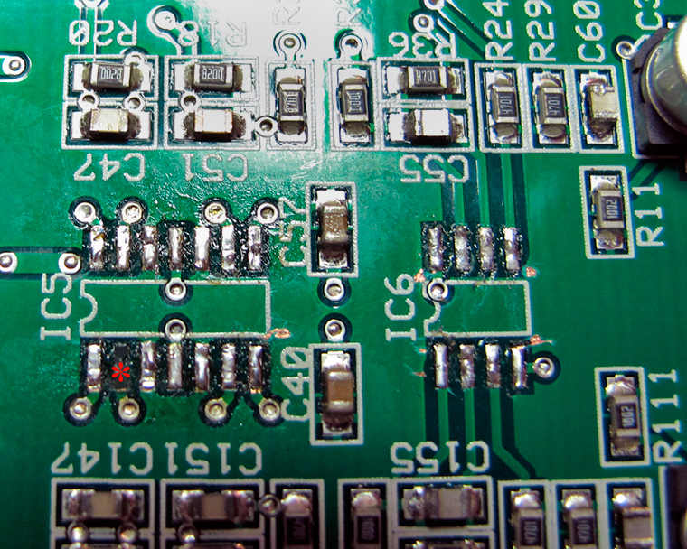

Hi Will. I screwed up and lifted a solder pad on IC5, I think that would be pin #2. Repairing it is a more than a little over my head unless you will advise me.
The pic shows which pin. I know I have to make a jumper but thats it.

Those pads lift so easily - i'm working with a 12W soldering iron for this kind of work and I found it relatively challenging. However, don't panic - it might not be so clean looking, but the solution for that pad is to solder the 1654 opamp onto all the other pads on IC5 as normal and then for that missing pad, simply pull the solder across from the leg of the opamp onto that little round pin just below it. If you want to, you can also gently scratch the green lacquer from the track leading up to the missing pad to expose the metal, then paint the exposed metal with a flux pen (cheap to buy and really useful), and then you'll find the solder sticks really well to that little track. But you should be fine just soldering across to the round pin - watch the heat - do it quickly. I really recommend the flux pen for this kind of job - helps solder key onto metal surfaces and you won't want to be without it once you've used it once. I also use a low melting point solder - the Cardas quad eutectic solder from Hificollective is superb for IC's, since it has a low melting point and flows very easily (and great value for a reel as well) - I use it all the time now. Keep going! Will
