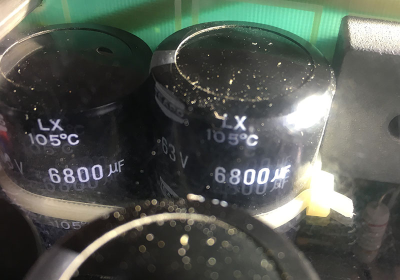

Hi.
Have had an issue with a different amp, so has pulled the P150 into the audio system.
Has been running sweet, but have just read this thread and better check the caps. The P150 was bought new way back around 1990 by us.
Took the rear panel off the amp and could see the caps on that side. A small minor bulge on the caps, could just see them on the other side and no more than that:
So, are these caps ok, and if they should be replaced, by the same or different caps? Any details available?

Hi maf_au,
Test the bulge to see if the metal is flat underneath. If you can feel a flat surface by pressing in the bubble in the plastic you are okay. However, these amps can get pretty hot and it might be a good idea to buy replacements. When you do, look for ones rated at 125 °C, otherwise go with 105 °C capacitors. Look for high ripple current and the longer life when you do. The Digikey web site makes this information easy to find.
If you do feel the metal is bulged out, stop using the amplifier immediately. Wait for replacements to come in and install them before switching it on again. If you have ever seen a large capacitor vent, you'll understand why I am giving you this advice.
Best, Chris

Thnks Chris, will have a look again and buy the caps anyway.
Should these be the specs of the caps: 10,000uF, 25V, 125°C or 105°C

Hi maf_au,
If you can get those capacitors in the high temperature rating, go for the 125 °C rating. Sorry about the expense, but the heat from these amps can make short work of the normal 85 °C capacitors. Your amplifier is a special case due to the heat build-up inside.

LOL. Had a better look at the caps in the P150:
Big mistake before: not 10,000uF and not 25v and not 25x35mm!
They are actually 6800uF, 63v, 105C and 30x50mm
Haven't been able to find any higher temp caps than the original 105C
Also in the P150 amp, there are a bunch of 10 small caps, should they be replaced also?
10uF 16v, 100uF 63v, 470uF 16v
