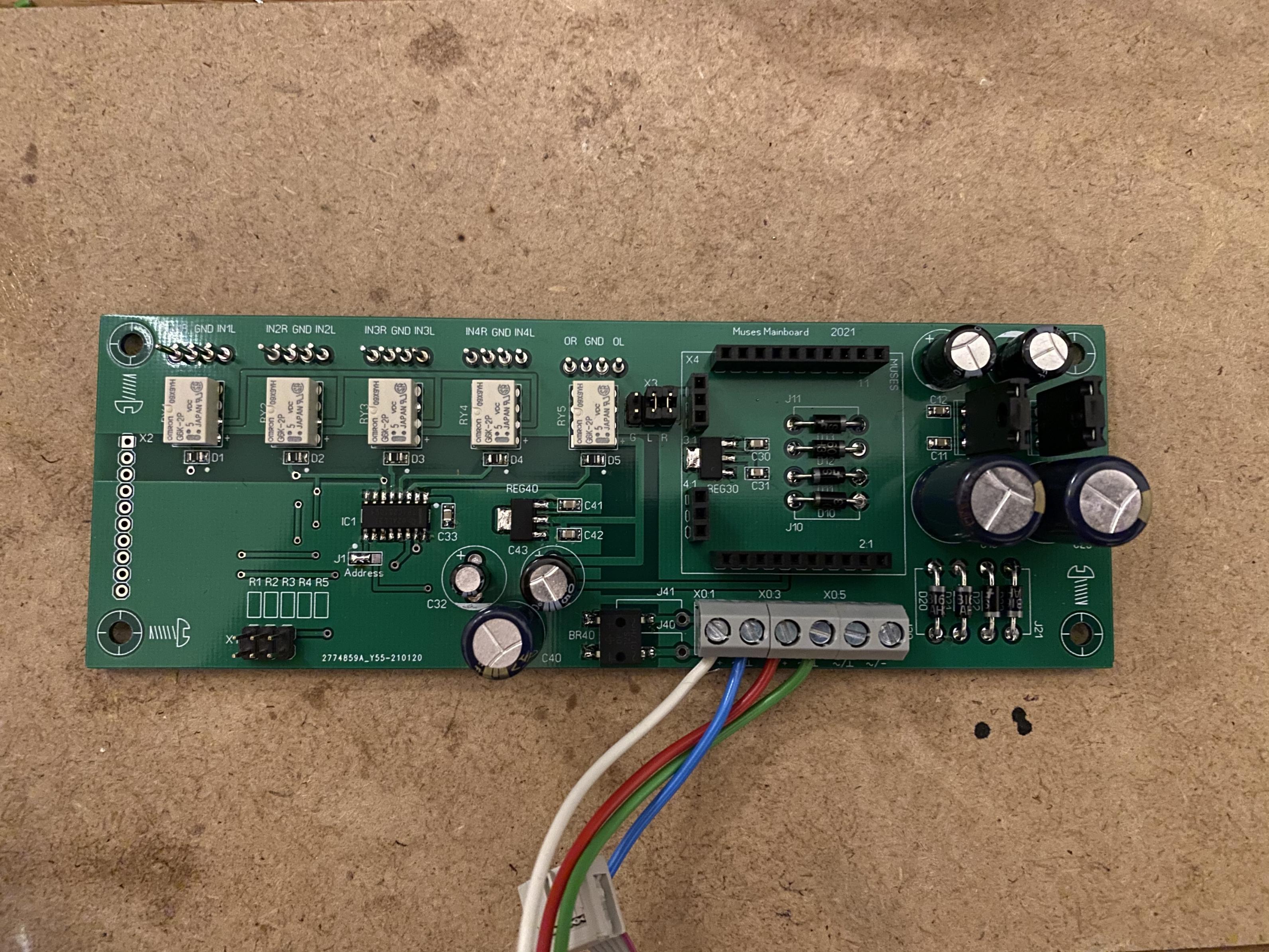

Found a decent PSU and doing some initial tests.
approx +-14Vdc in. However R1=100ohm on the controller board get extremely hot. (actually so hot the solder smelted) Also the 5v LDO gets hot. https://no.mouser.com/ProductDetail...f//tDZEZckA==&countrycode=NO¤cycode=NOK
R1, is 1/10watt resistor it seems.... Too small?
I do not get 5V out of it. (0.7V) Approx 1.2V enter the LDO.
D1 and D2 are https://no.mouser.com/ProductDetail...8aNy7/u4kVw==&countrycode=NO¤cycode=NOK
Been tracing "everything" according to schematics. Unable to find what is wrong. Dont think I have reversed D1 and D2...

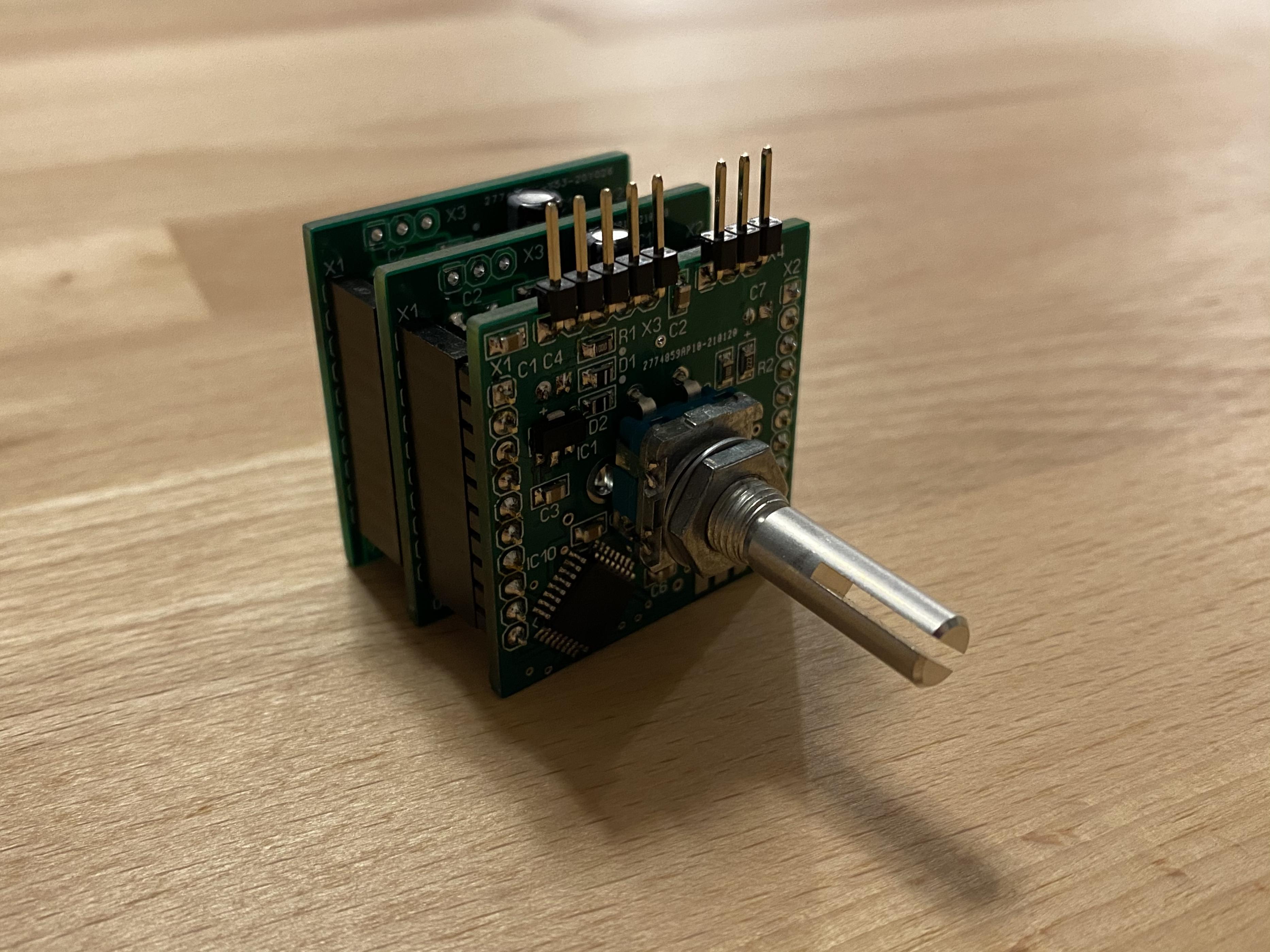

And I also equipped a prototype...
Next steps:
- some firmware tests and improvements
- testing the mainboard include stacked muses and controller
- documentation
I think, I need 1-2 weeks to finish the project and can offer a group buy 😉

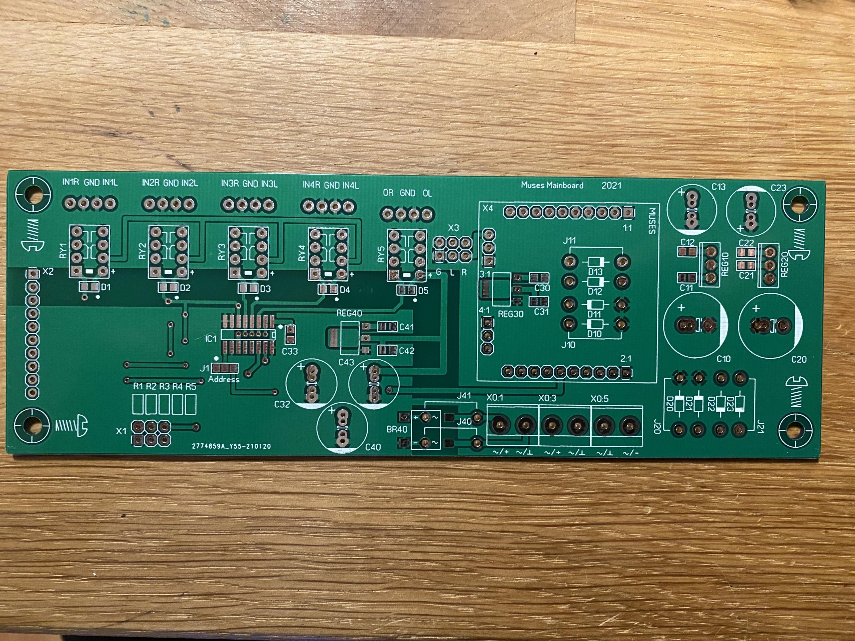

Today I assembled the balanced prototype
