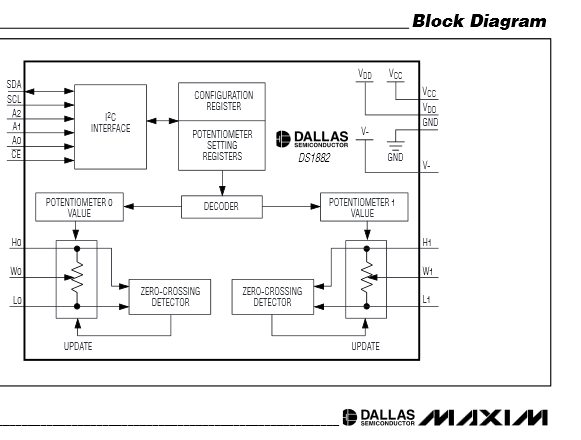

Are the two DS parts with integral opamps..?? i see them on the 1882, but how about the 1666..??
The 1666 is supposedly just switches and resistor arrays. At the time i played with it i built two versions - one with a 555 and a second with a micro and an optical encoder. I think it also needed a mute circuit as it made strange noises on power-down.
Have you wondered why serious reviewers take weeks to review one component?
This is more akin to reviewing a capacitor, rather than an entire component.
As for the habits of serious reviewers - from i hear they sometimes take months and even years for an in-depth review
DS1882 is resistors and logic; no opamps.
That's one reason wayne (and others) like it; use whatever you want to drive and buffer it.
Its a pair of 45K pots. See attached block diagram.
mlloyd1
Looks like the Muses!

The DS1882 has one disadvantage: it only can handle input voltages up to +/-7V, whilst the the MUSES accepts up to +/-18V.
Others like the DS1666 have even lower limits.
Therefore I wonder why companies like ARC use(d) them in their Reference preamps.
Depending on its implemention there could be a problem with its overload margin (that's always the basic advantage of every passive attenuator).
But of course chips like the DS1882 are cheap and easily available.
One advantage of every electronic attenuator should be mentioned here: they have extremly short signal paths and no contacts inside. Paired with improved technology now make them serious competitors to the best mechanic solutions....

a more practical advantage to me for the MUSE part is those two extra pots that are used to set gain of an active stage. if one doesn't use them as such (i.e. just use the main pots as attenuators), are the extra pots flexible enough to be used in other ways; for example to help with balance control adjustments ?
don't get me wrong, i think the MUSE part is great.
i just think the Maxim part is also .
