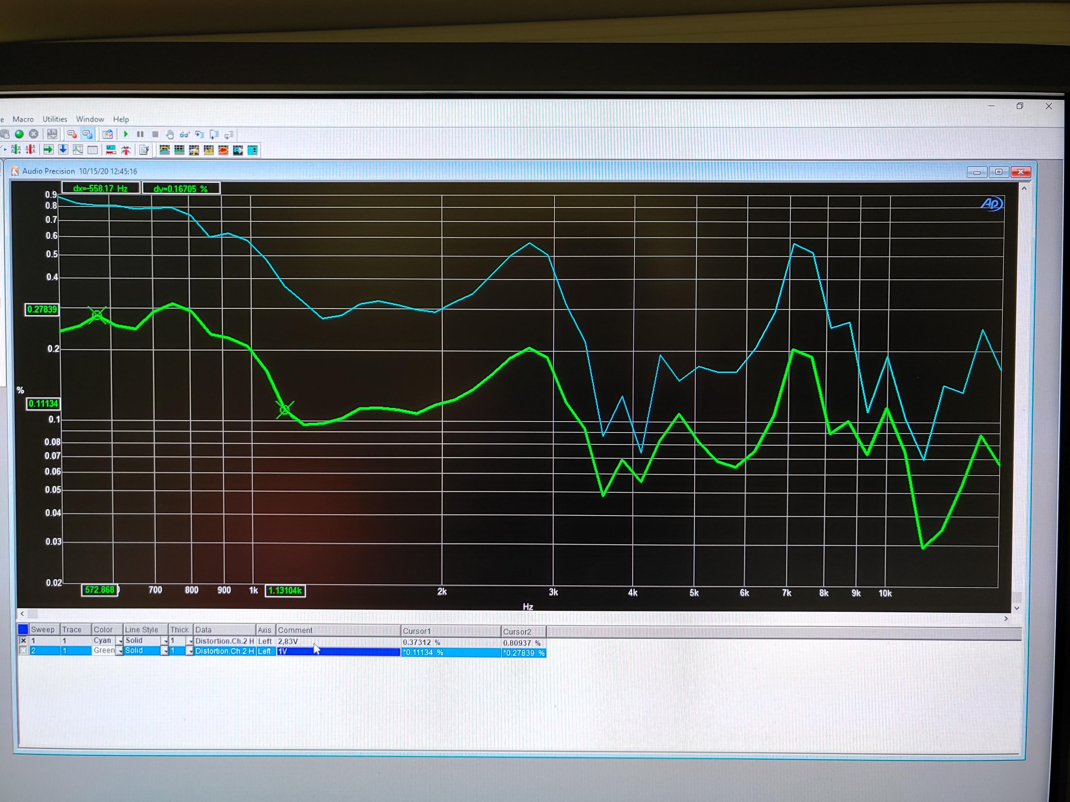

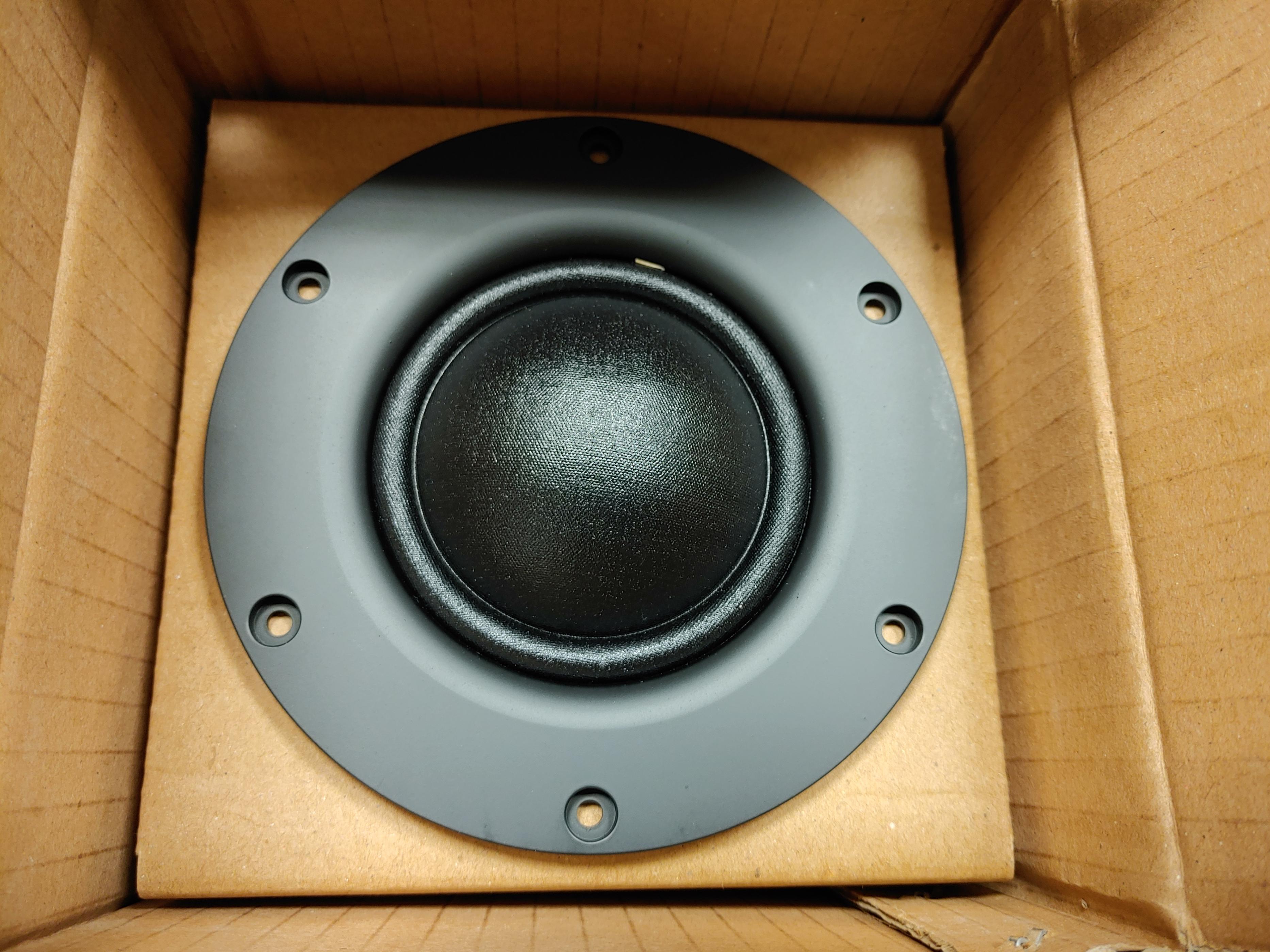

I just received my pair.
Very sensitive as stated in the data sheet. I just quickly put one driver on a piece of basotect and measured distortion. (I want to build a 4way speaker plus subwoofer with minimal distortion.)
For 2,8V I got 0,3% THD on 1,1khz. With a bump on 2,8kHz reaching 0,55% distortion. (this is already really loud)
For 1V its about its in the range of 0,1% for 1,1kHz. With a bump on 2,8kHz reaching 0,2% distortion.
I think with a real baffle (not the naked driver on basotect) you would get more level on 1kHz and also the sweetspot of low distortion would be shifted a little bit down in frequency.

Curious about those distortion measurements - are those actual 3rd party measurements? There was an article in VoiceCoil on these and distortion was much higher in their measurements.
MD60N-6 was the driver disappointment release of the last 2 years for me - struggling to see a role for it 🙁
Here is the image
I love large midrange domes and the Satori MD60N-6 looked promising at first with its extended FR an mid 90s dB efficiency. I'm quite sure these drivers were designed by SB specifically for their own needs and ended up being released as a trial to test the waters. Their performance based on a few credible sources was sub par with excess THD across the FR being an issue, but that doesn't necessarily mean they'll sound bad if its mainly the even order harmonics that are high.
