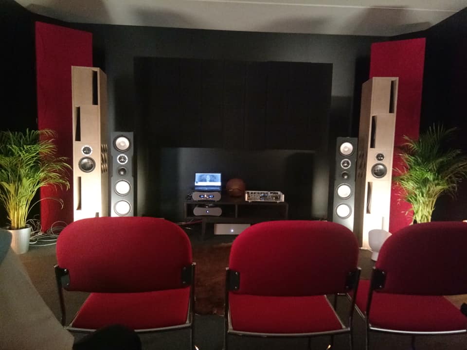

Hi Jonasz. No those are not ones I saw. I also saw it on YouTube but it’s a three way with what appears to be 4 woofers in maybe bandpass enclosures with mid and tweeter only facing forward and it uses not yet released for sale carbon fibre cone material. Thx

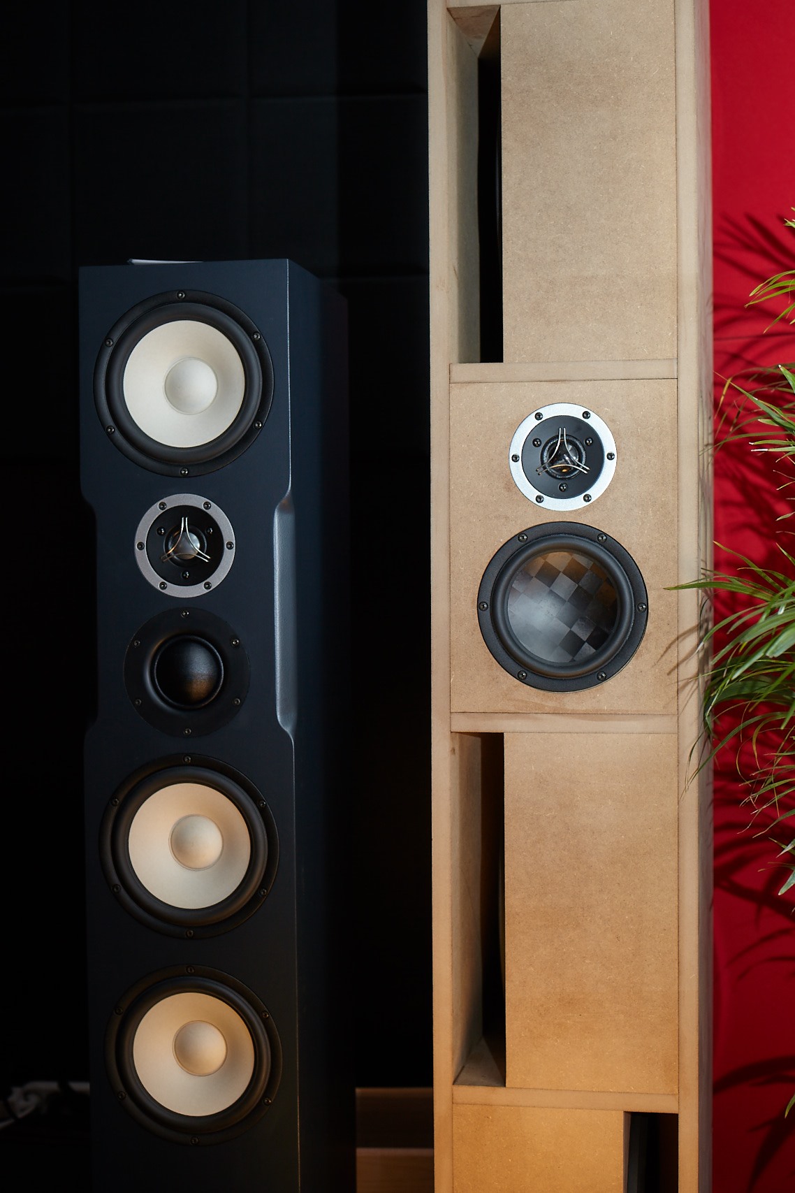

That is the one with four ripole dipole basses and the new Textreme midbass and tweeter. I believe it was a design by SB’s own Ulrik. Got very good reviews but I don’t know if it will ever be a kit.

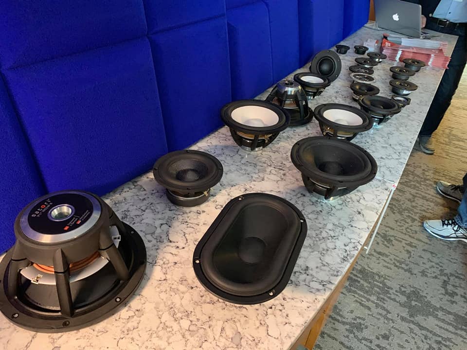

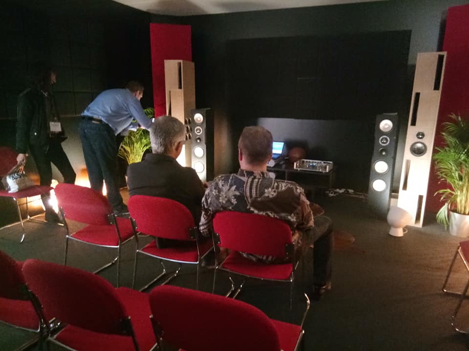

Three photos of the two floor standers and one with the mid dome on the table. Hope this helps.
Interested to see how the Satori dome stacks up against the Morel EM1308 and the new Tex woofers fit in the lineup.

Hi All, the photos are from the phison audio room who were sharing with SB Audio.
Sonny is developing the speakers, both the tall speakers and the tomb stone.
I am interested in the taller speaker and he is telling me that the drivers are very new and "we have to wait 2 month before any production is running".

@snax; we have no plans to make it available as a kit, though maybe later we will share some details. There's not much to it, actually. It is a 3-way speaker. There are four SB34NRX75-16 woofers per side (slot loaded open baffle) connected in parallel - the high Qts makes this driver ideal for OB. The mid and tweeter are the new MW16TX-4 and TW29TXN-4. This section is aperiodic (i.e. the entire back of the midrange enclosure is a large flow resistor). A passive network crosses over the mid and tweeter (the crossover point is relatively high at about 3.3 kHz). The lower crossing and woofer EQ is done with a miniDSP (2x4HD) - crossover point is 200 Hz.

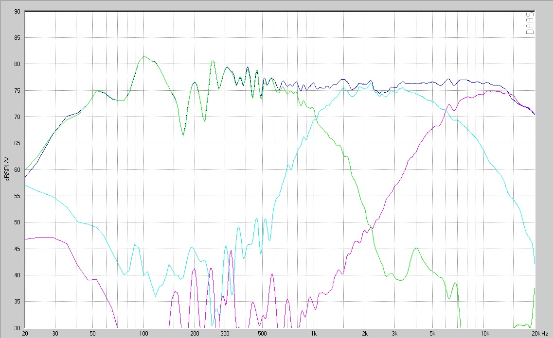

@Ugg10; we have never compared it in listening to any similar drivers. This is more of a filler driver than a broadband midrange driver. However, in the demo speakers, it covers the range from 1-6 kHz (see response curve below - measured 20° off-axis in our listening room at a distance of 1.5 meters, input voltage was about 0.7 V). It is quite smooth and very detailed - and a little bit forward sounding.

That's an awfully big flange for a filler driver. The 6kHz xover above is going to have severely sub optimal off axis performance. I'd want to cross something of that size at ~600-2.5kHz.
Most 2" domes can handle 800Hz xovers. I was expecting this to comfortably handle 600Hz.

@5th element; this may not be the right driver for your application. Anyway, if you think about it, the flange is actually not that big (relative to the voice coil diameter, which is 61 mm on this driver, the flange is smaller than your typical 100-104 mm flange on a 26-29 mm tweeter). I understand what you mean, of course, but there is a reason for the flange being this big (it is 130 mm in diameter, by the way). By experience, the bolt circle diameter needs to be at least 14 mm larger than the baffle cut-out diameter for the driver. In this case, it is 18 mm larger, so we could have shrunk a few millimeters, but that is all (see my reply to Pida below). It is not that it cannot handle lower frequencies but it starts to roll off at about 800 Hz, so I wouldn't use it below this frequency. I do not consider it to be a problem to use it up to 6 kHz, though I wouldn't use it higher than that either, as it would have too much of a negative impact on power response. At 6 kHz it is 2 dB down 30° off-axis, which is also the case for a 6 inch midwoofer at 3 kHz - and many excellent (passive) 2-way speakers with 6 inch drivers are crossed over at about 3 kHz. The MD60N-6 (that is the model name) has a very smooth/clean dispersion characteristic well beyond 6 kHz.
