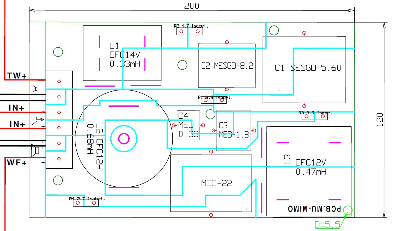

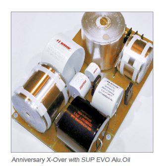

Based on the pcb I come to the conclusion that Mundorf's description of the crossover is fully correct. First order with notches and without any parallel components.

Hi Dissi,
Looks good but I think there is a difference from the board picture you are using and what I used. On the tweeter HP section, the cap immediately after the 6.8 Ohm resistor appears to be 6.8 uF in pictures I've seen of delivered crossovers as well as the diagram I am using, which comes from p. 14 here: http://www.mundorf.com/PDF/Mundorf_MA30_Catalog.pdf
I do not however have any justification for avoiding parallel components. I always thought it was parts in series with the drivers that were to be avoided. What an interesting shtick.

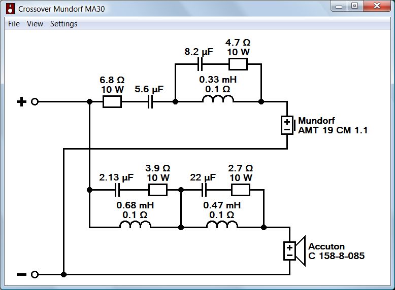

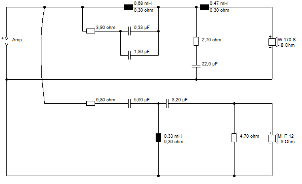

Awful pile of spaghetti to untangle there... 🙁
There's something wrong looking about the 4.7R and 91dB tweeter level here, but I think I've mostly cracked it. Took me an hour!
Near 4kHz tank notch on third order bass filter. 3rd order tweeter too. The Accuton bass is about 0.6mH Le, the Mundorf is something like 8 ohms flat impedance and FR. Gotta be positive polarity on a 2kHz crossover.
Maybe just me, but I find something disturbing about the photo. 😱

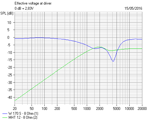

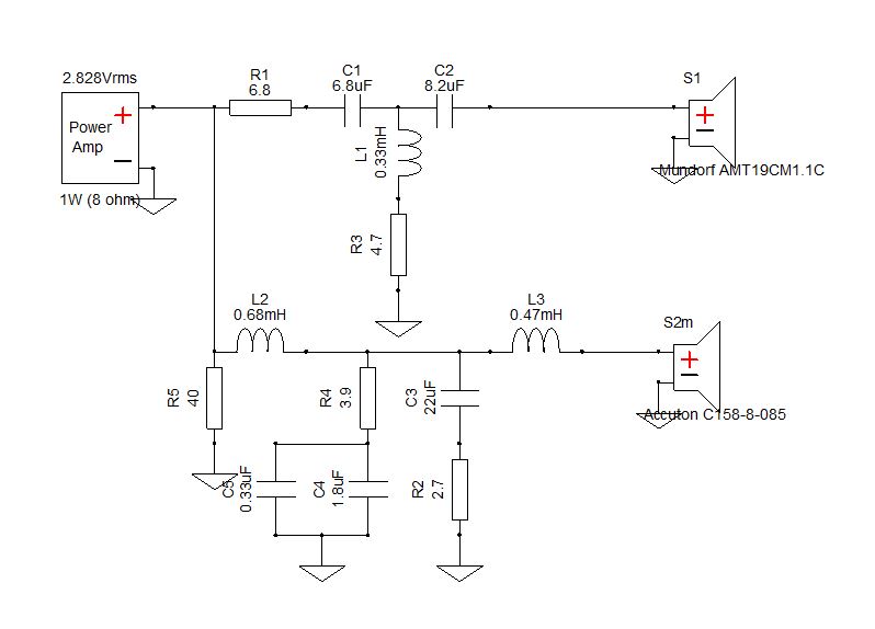

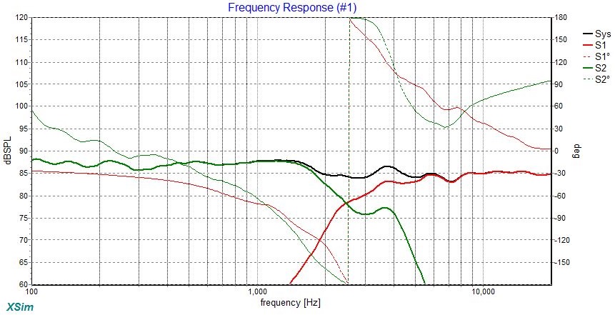

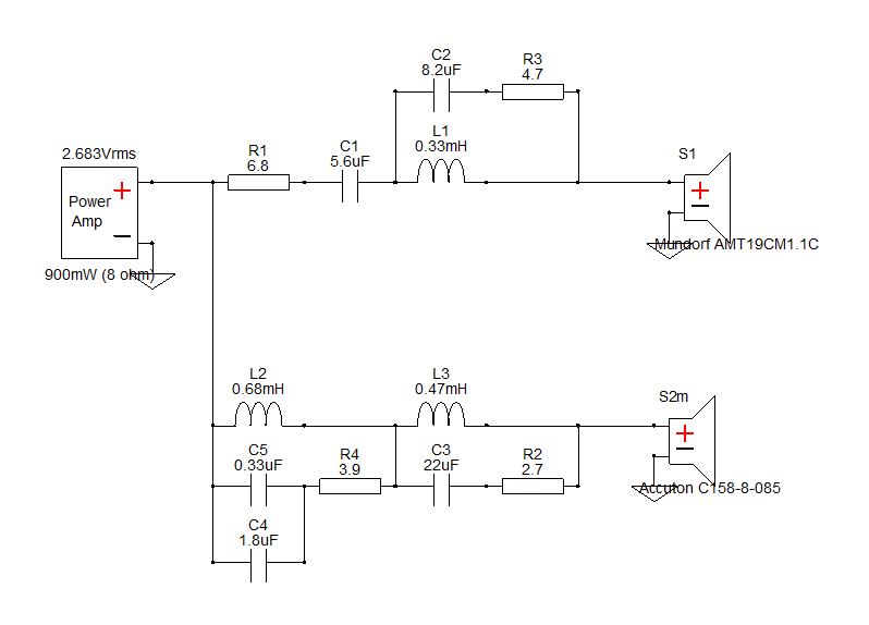

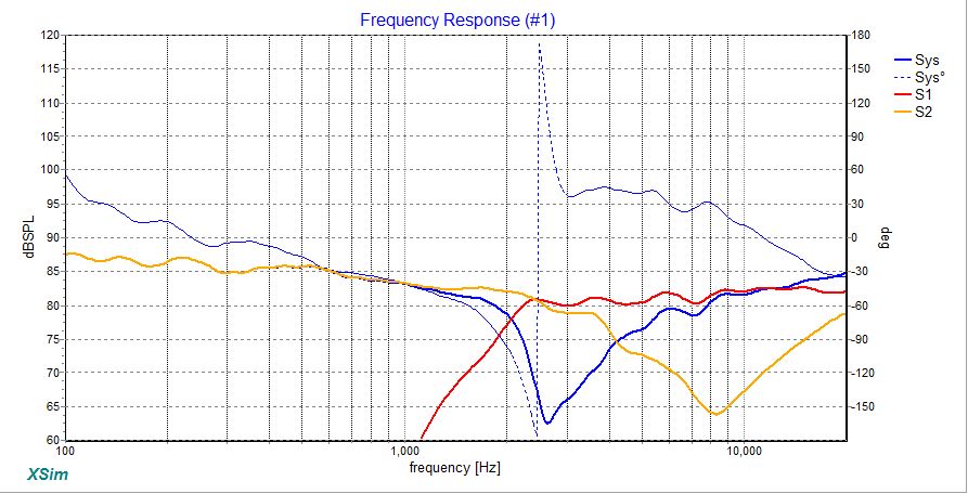

Well, OK fine then. Since no one else feels it's wrong to reverse engineer it and post with values, allow me to contribute what I had come up with for my blog post. 🙂
I took the FRD and impedance data for the drivers, used SPL copy, then used OmniMic to phase restore the generated driver FRD plots. Imported the driver ZMA and FRD into XSim before attempting to reverse engineer the board drawing I had in front of me.
Using that information, and guessing that the phase matching would be pretty close to ideal I came up with this schematic. This design yields perfect phase matching with -0.04" adjustments to the woofer distance (meaning woofer is 0.04" closer than tweeter), along with nearly ideal FR and quite usable impedance. R5 is my own invention though, I was playing around with damping the impedance peak. Please ignore it.
attachment.php
Please note the value of C1! There are at least two versions of the board drawing in the wild (and the Internet is quite wild) which use different values of C1 and possibly different layouts. All the pictures (not drawings) of the assembled crossover show C1 as being 6.8uF, so that's the board I am working off of. I am not responsible for the other one working out or not.
It's definitely possible that I made a mistake, but as I mention, the results say this is a nearly ideal crossover, so either I have found an alternate crossover by jumbling up all the same parts, or this is the actual design.
I'm even going to be so nice as to post a zip of the XSim file.
It is of course possible I just invented a new crossover in which case you can name your first twins after me.

Using a 5.6 uF cap at C1 is a modest change, but enough to disrupt the phase alignment and deepen the response at the crossover point just a smidge. Honestly don't think most would be able to hear the difference if that is the only change. If the rest of my analysis is correct then I would say 6.8uF should be the better choice.
Best,
Erik
Guys, please take a look at the Mundorf docs again. I think the schematic in post 23 is spot on. The schematics in posts 27 and 28 differ quite a bit from the PCB shown in the Mundorf docs.
I think it would be helpful to see post 23 simulated. Since I have posted the XSim, anyone who wishes to and has access to Windows should be able to quite easily. It's beyond my level of interest though.
The only things I really had to guess at was the ground location. Once I select those, the schematic came together pretty easily.
It would be pretty remarkable if post 23 had as good an outcome as the one I posted. Makes me wonder what the point is.
In any event, this is all just for fun. We shouldn't get too involved in this analysis, it's not as if we are launching the Hubble and must be sure the mirror is ground correctly. 🙂
Perhaps some one will send me a real board to trace. 🙂

Just to make it easier, here's the FR with phase and individual drivers plotted. I'd be quite happy with a crossover like this. May not be right, but would be interesting to see if the convolutions needed to avoid paths to ground add anything, or if in fact we can just move the end points around and get the same results. 🙂
OK, I'm being completely OCD here. I used Dissi's schematic and the driver FR's are just not believable. The important part is the yellow line. Notice how poorly the individual driver responses match up compared to my original schematic. Now we have the smallest AMT tweeter crossing over around 2 kHz (not likely!) and the woofer at around 3-4kHz.
What are the chances that I would come up with such a neatly tuned crossover if I was so off?
attachment.php
I have posted the XSim schematic I used to reinterpret Dissi's hypothesis in case I blundered. Dissi makes a fine simulation tool as well, so I look forward to his contributions. 🙂
I would probably ignore the system/phase matching issues as they are based on my original hypothesis that the driver acoustic distance was near zero. The woofer FR is the real key I think. It's god-awful. Did my simulation miss something?

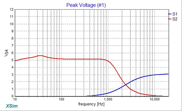

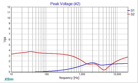

Finally, let's compare transfer functions for each hypothesis. First, the one I presented (voltage increased for clarity):
attachment.php
Looks absolutely mundane, boring, typical. Exactly what I might expect from a 2-way speaker system. Chances of me getting this so good while having completely wrong schematic: 1 to 1,000,000. Not impossible. I can imagine in some situations the same parts could be turned around and used in more than one way, but wow.
Now we compare Dissi's Hypothesis from post 23:
attachment.php
Nough said. Anyone who wants to gripe, please present the FR and phase plots to back it up. 😀 😀 😀
Best,
Erik

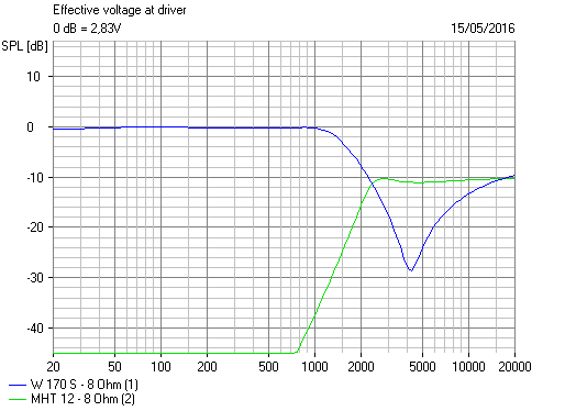

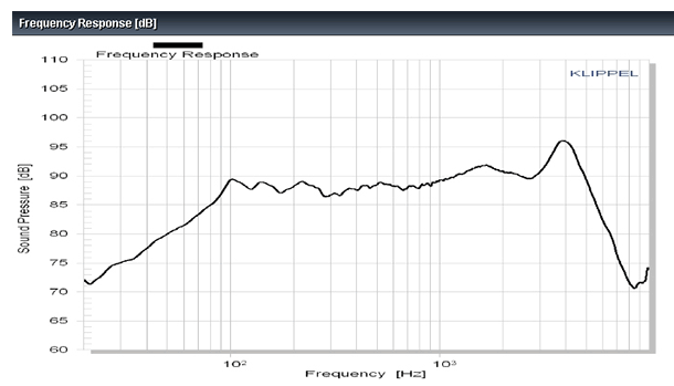

This is all a pain IMO.
Dissi has interpreted the crossover correctly IMO. Some variation on 5.6uF or 6.8uF.
This is the unfiltered accuton woofer response, hence the 4kHz notch. The tweeter is flat.
549269d1463281456-mundorf-accuton-kit-theory-accuton-c158-8-085-6.25-ceramic-cone-midbass.png
But it all makes little sense to me. Polarity seems wrong for one thing. But one of those transient perfect speakers, I suppose.
