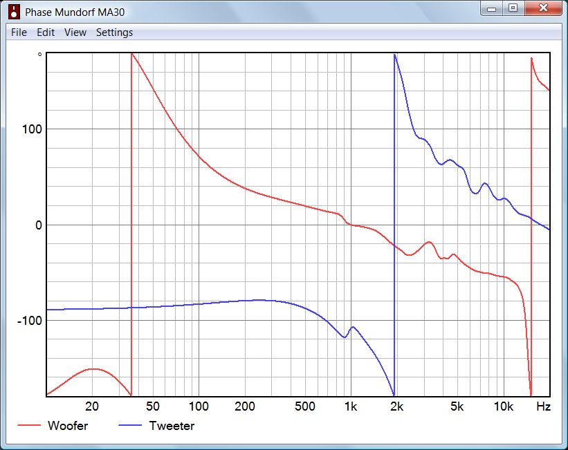

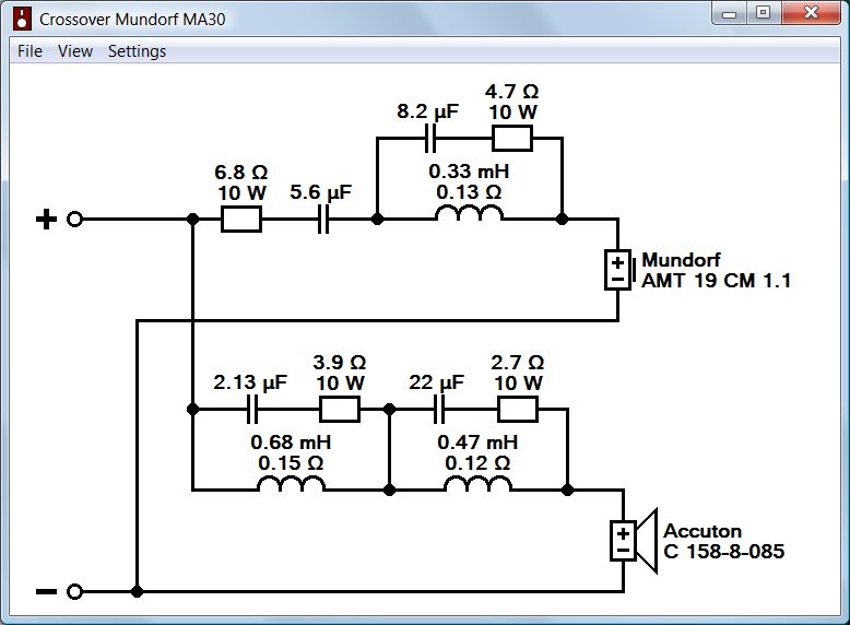

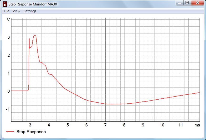

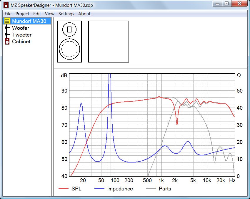

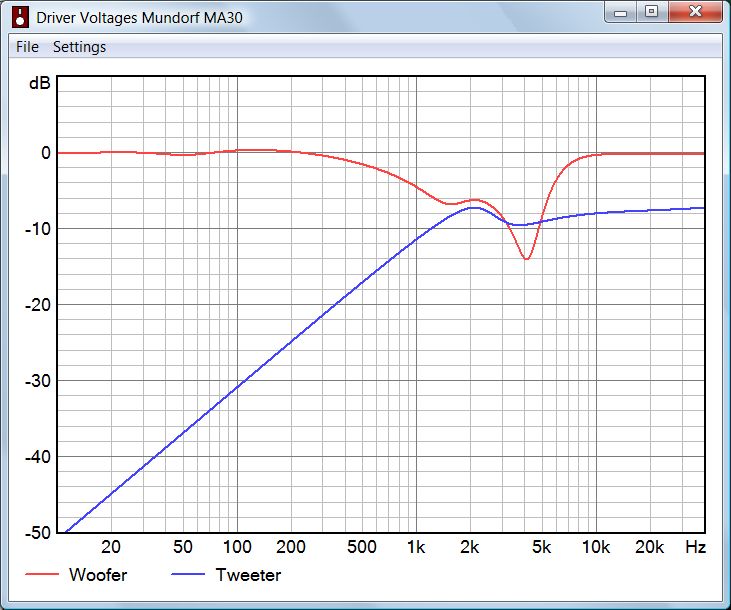

Attached are my results based on manufacturer datasheets. Note that the simulation isn't really capable to predict the influence of the protruding woofer mounting ring on the frequency response. However, acoustic centers should be more or less correct. 🙂
