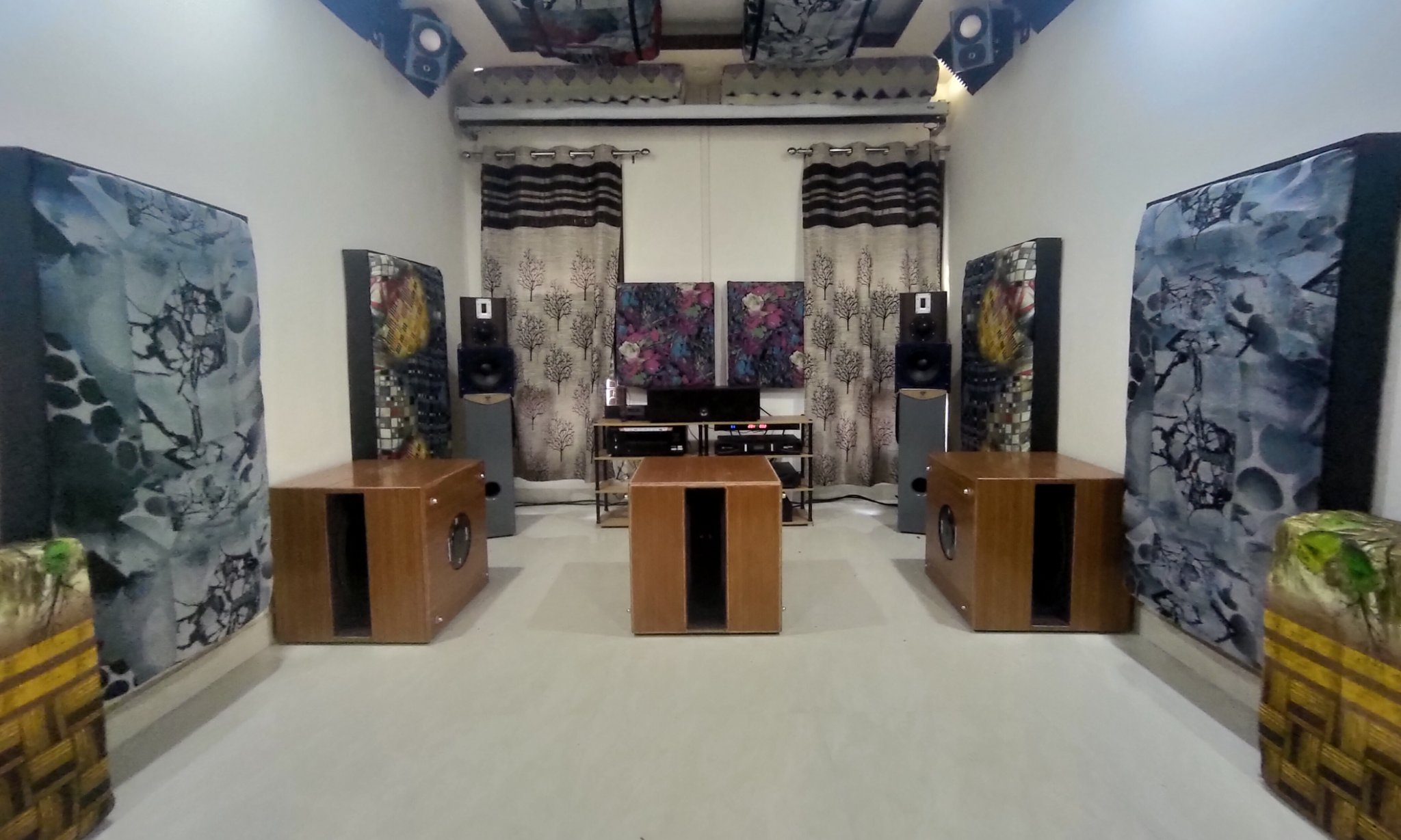

I use my subwoofers a bit differently depending on the content.
For music, I run four subs in stereo bass mode. Placement is manual for smoothest response. No active delays.
For movies, I go all in with six subs non-stereo. Here DSP handles all the delays for smoothest and constructive interference.
I’ve found that setting the crossover around 60Hz hits the sweet spot subjectively.
One of the subwoofers is placed behind the setup, so it’s not visible in the picture.
