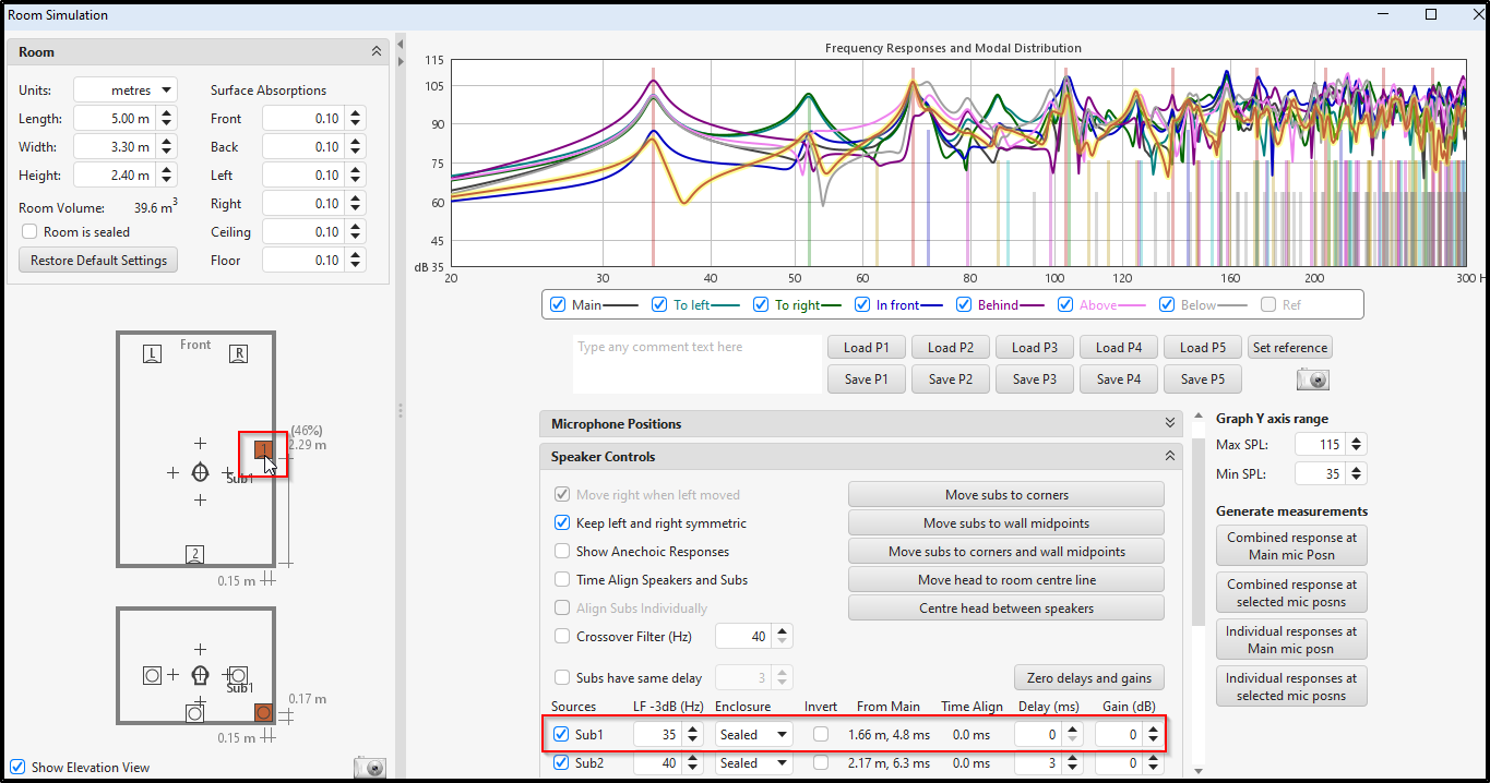

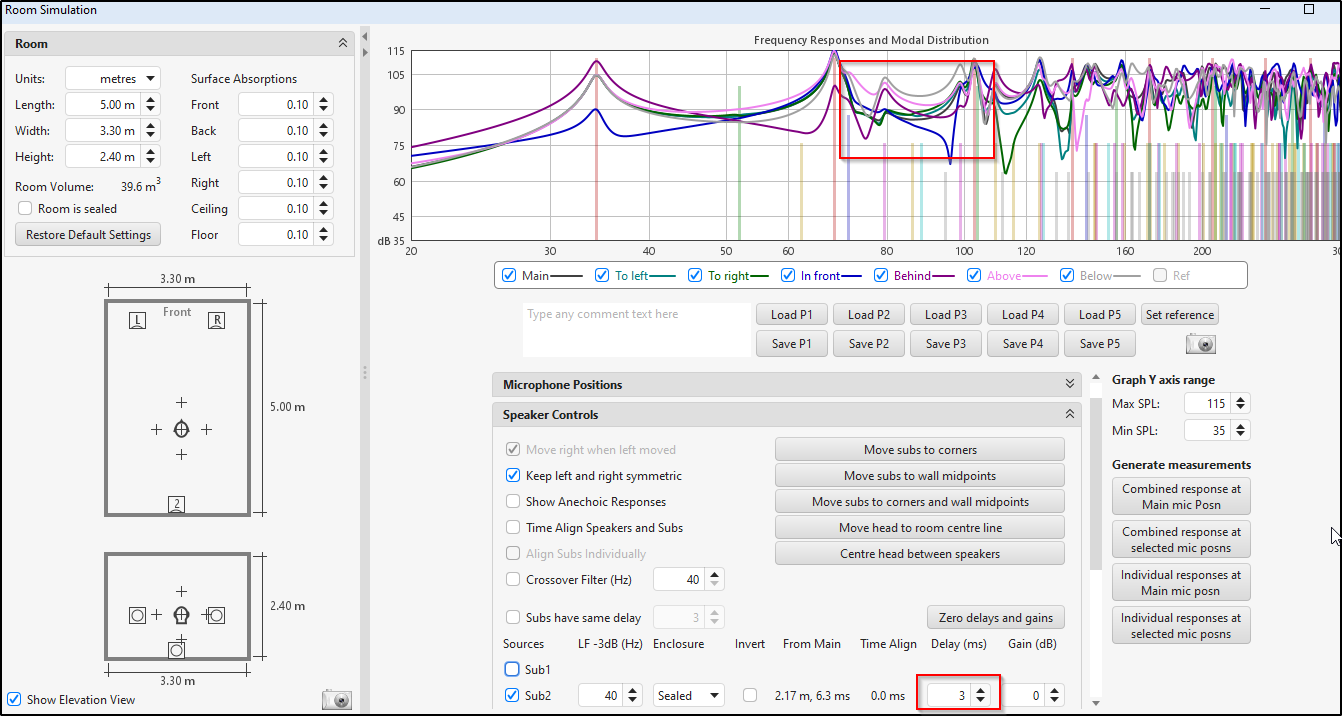

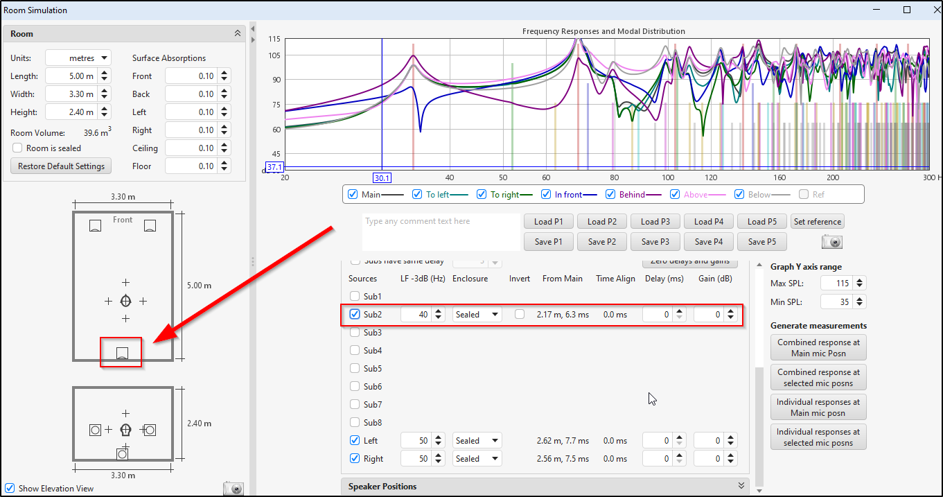

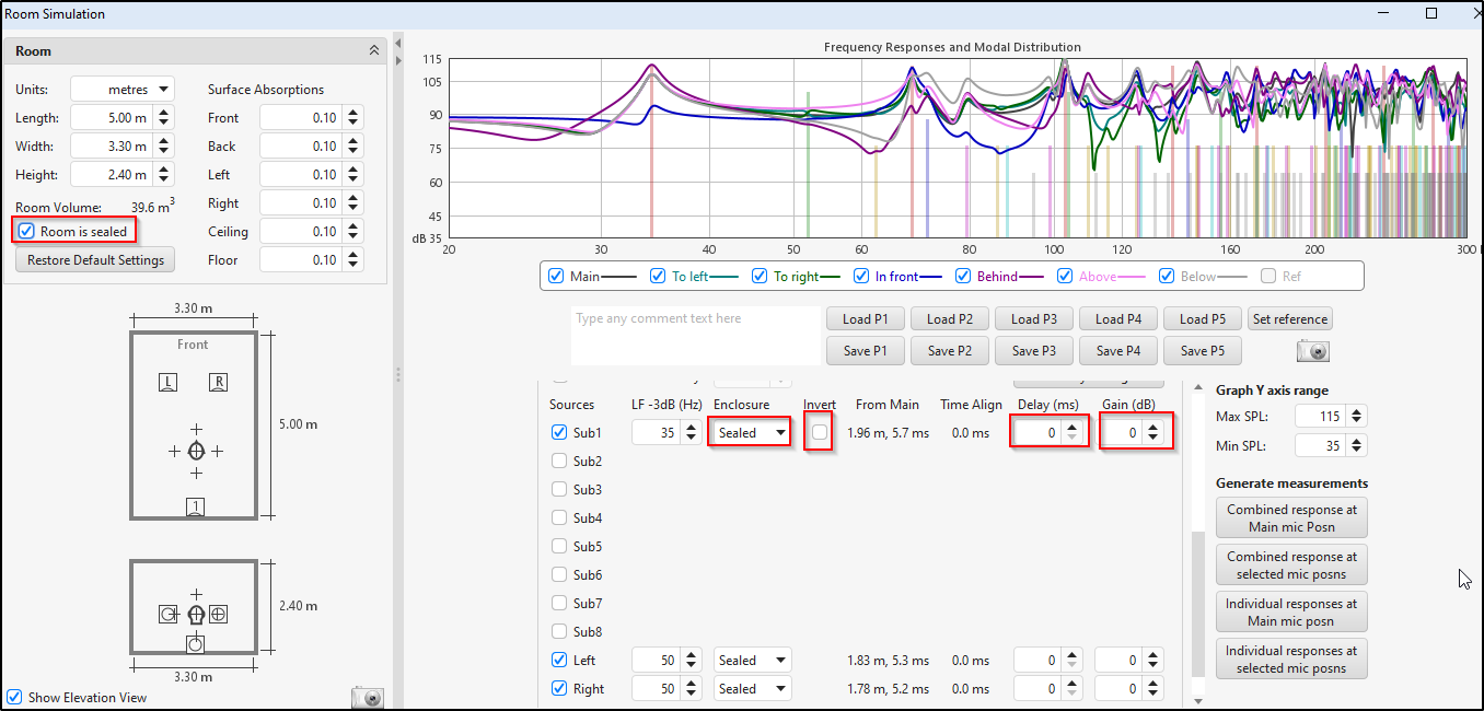

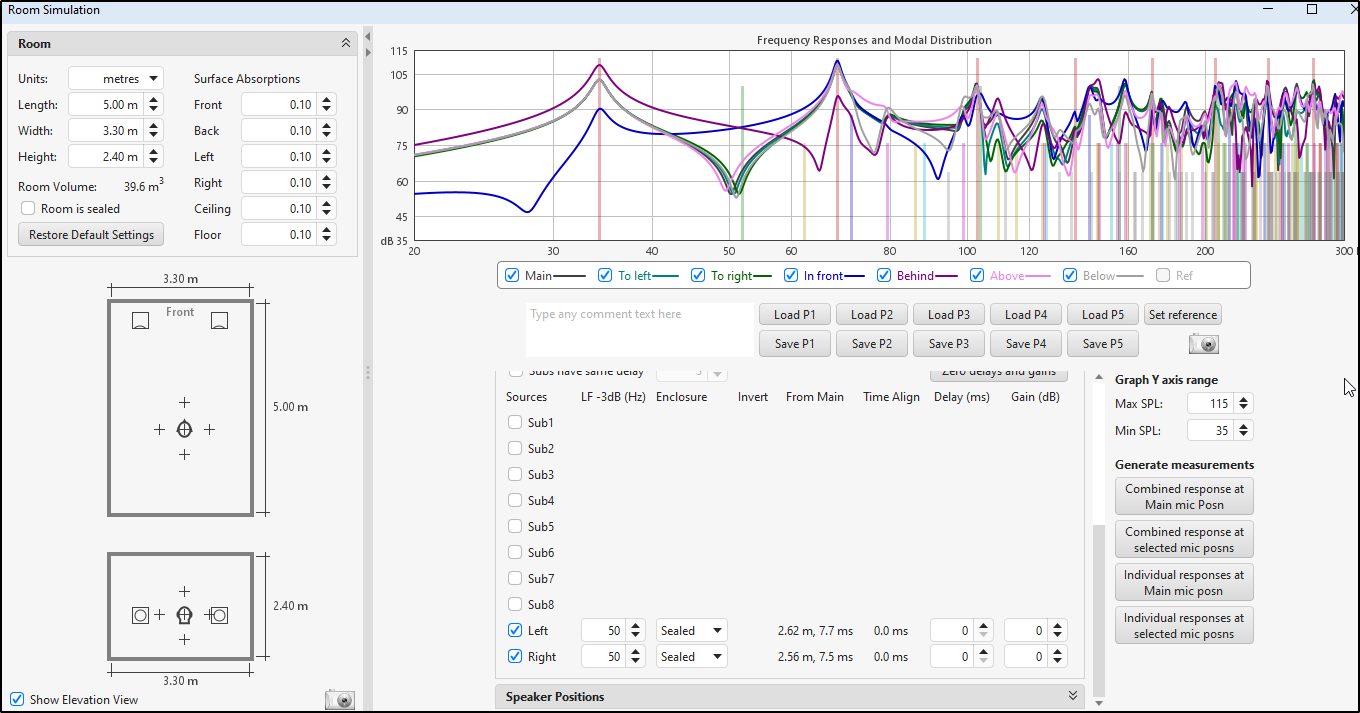

For those that dont know, REW has a nice Room Simulation tab. I guess 8 subwoofer + Main Left and Main Right is sufficient to most.
I dont know how accurate it is, but it is really easy to try ideas and theory from the couch 🙂
For example my room. I like to keep my mains rather close to backwall:
Only mains:
Adding one sub at backwall at midpoint (huge dip at 50 hz is gone)
Adding 3 ms delay (delay added is the same as if plateamp had phase turning knob - Took me some time to realize that):
Adding third sub:
As a general trend it is going to be OK. But there is a serious error in REWs room simulator that I have commented on before. That is it uses global damping and real mode shapes in the model which is not accurate when one has, for example, one wall much more damped than another. In this case the damping is strongly modal and the modes become mathematically complex (ie. have imaginary parts,) and a global damping assumption could be very wrong. If I hadn't of gotten so old, I at one time planned to create software that would allow for a small room with random wall impedances just to see how different the two approaches results are. Just not in the cards these days.
