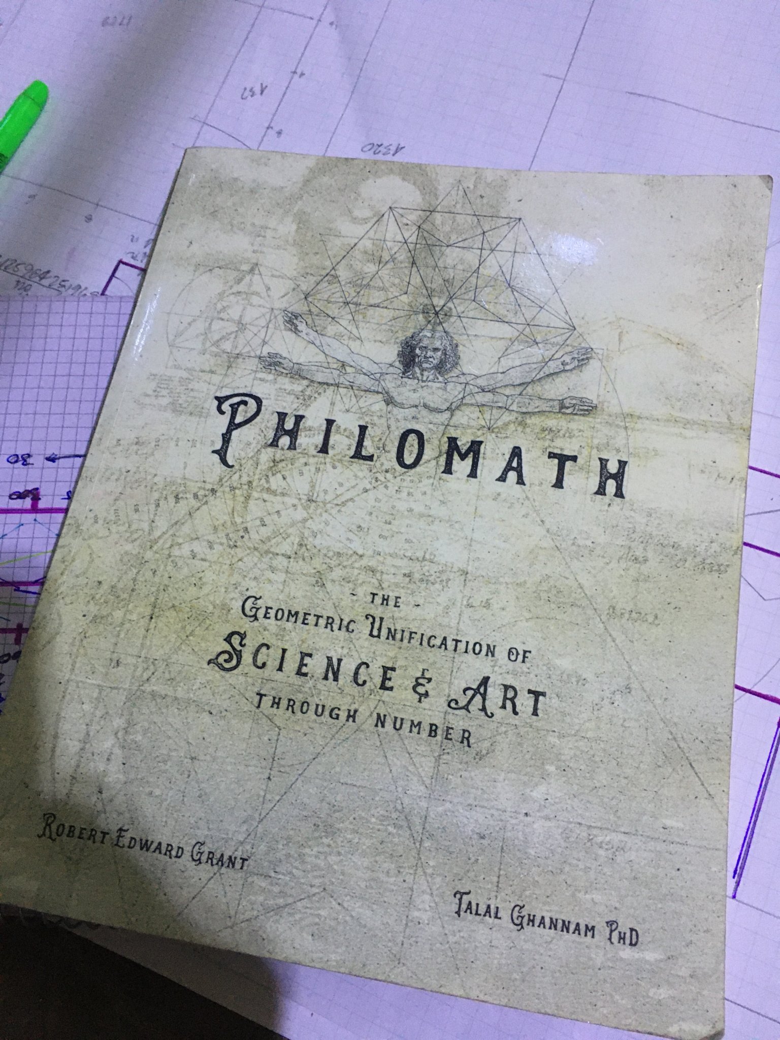

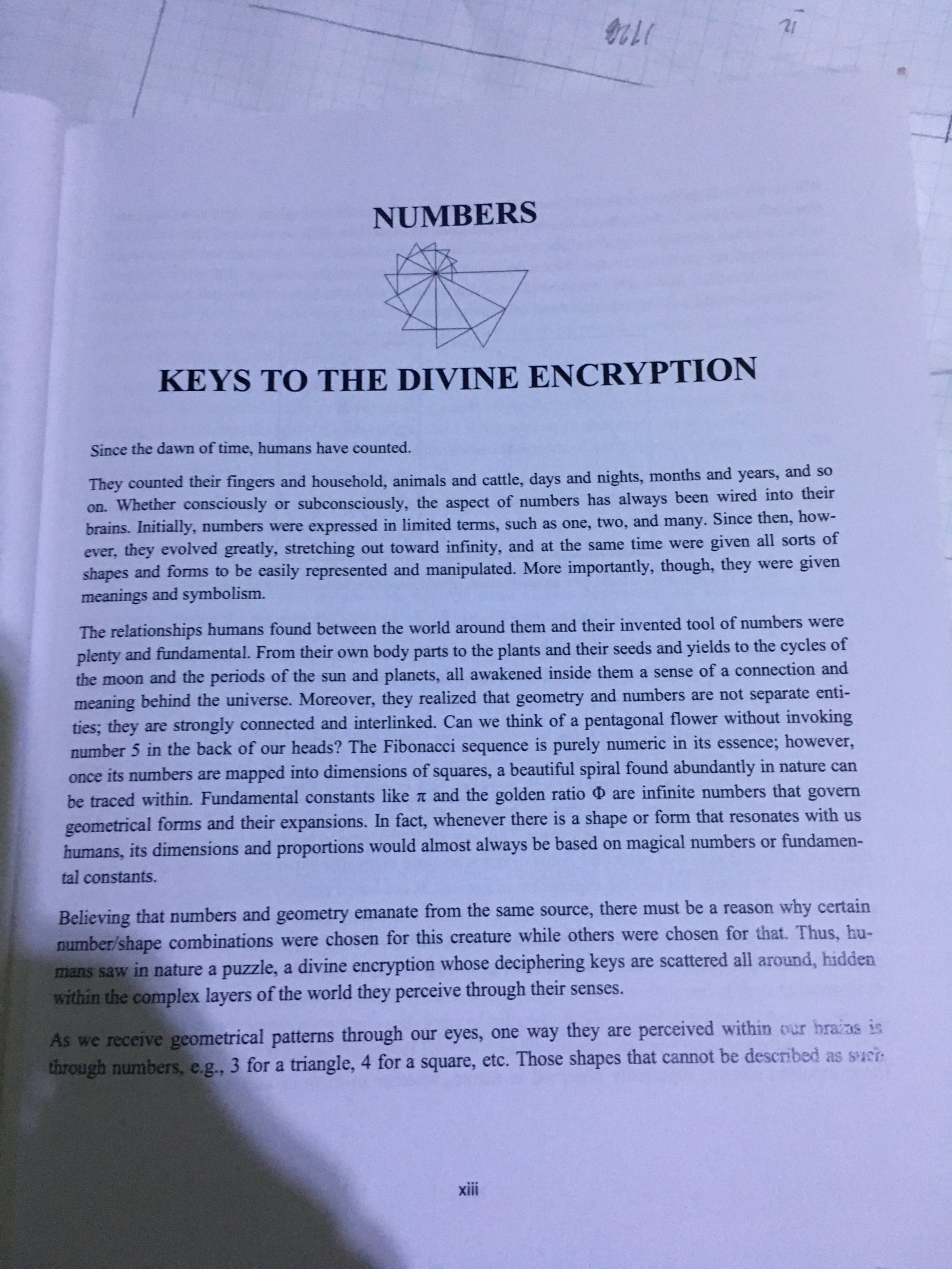

That’s all this book is about endlessly… references to everything we find in building a subwoofer as in the acoustical shapes (rectangles ) and lengths / quarter wave parts and also the frequencies and out of band equivalent freqs …
this stuff is weird, but for some reason I can’t find any of it that doesn’t actually work already? In fact it’s kind of like reading a book about how to do we’re all already doing(Minus the sawdust and the reference to speakers.
