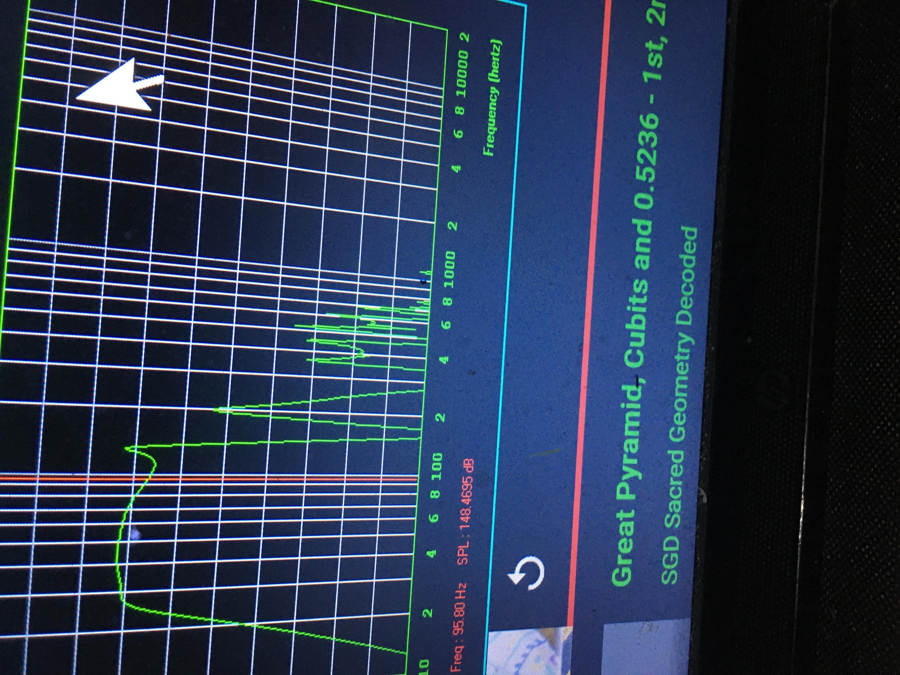

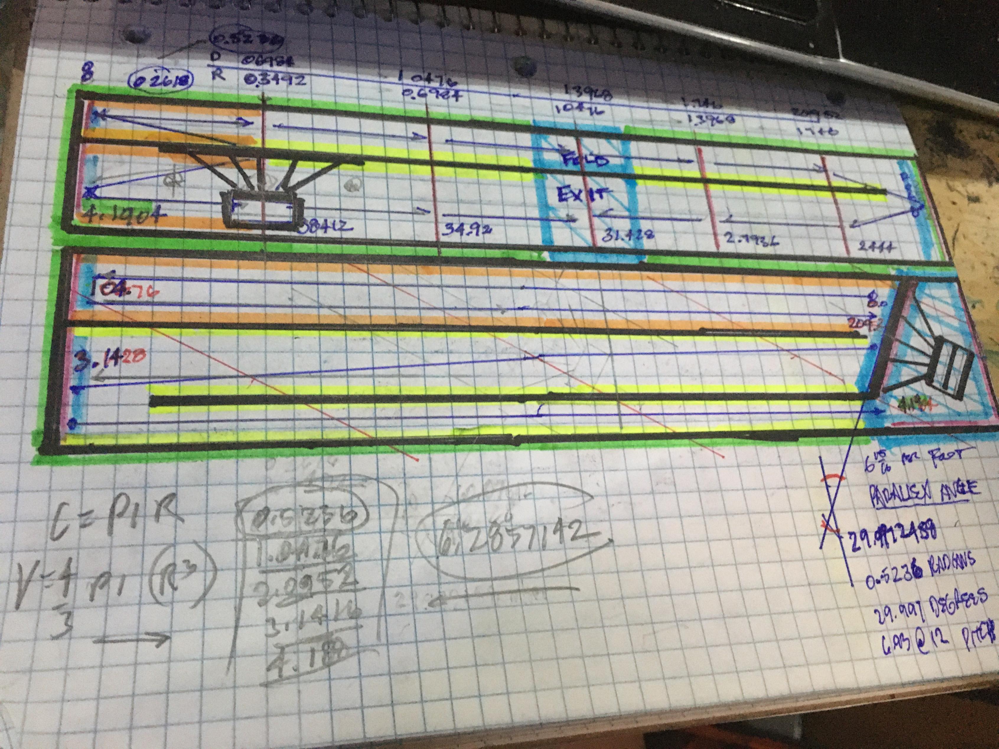

What do you think of a 6/8th order cabinet which has ‘perfectly’ aligned the harmonics 1/4 and 3/4 of a (4/4 total so to speak , frequency ) and with driver entry from two closed ends creating the 0.349 (TL version of a fulcrum point or 1/3 the qw pipe length) but with a folding such that it’s 90 cm in three segments off the front output and one off the motor side . combining the driver positions (30 inn90 and then two 90cm segments between .a Joint exit of the two (1/4 and 3/4 long (360 cm total and exit at 270) pipes before one more section of that 30 cm offset in the solo 90 cm motor side pipe.
if that’s all as it hopefully sounds. In the sim it’s quite intersingky ‘in synch’ ?? I’ve got -990 dB in the outskirts of 860,8600hz and anything between peaks that ends defining the ‘perfect circle’ I guess?
I’ve got a pattern in this (it’s simmed in horn response and not a very complicated one either) and it follows our own solar system and even more? As million Miles (placer or Simijsr) are hz. ? what the heck? So I looked deeper and deeper and it doesn’t seem to wanna disappoint. I found the trails of what would be just about anything in the absolute version of ? Physics as it would be naturally? It even pints your flawed planets and almost shines what it why if you combine the sim with a search thruogh a nasa or planetary model. This then gets you searching trigonometry to find angles as numbers or either in math or metric system / standard system. it might already sound silly , but this all stsrted from trying to clean up a TL with a TL… I failed. 😀😀
But I don’t know if it was so bad? hopefully this makes sense as typed? ? I don’t wanna pig up you’re post here but I wanted to ask you what the heck this is? (I can give you all the info and the complete sim if interested ).

Honestly the whole area of 29.972458,30,31.428,33.33,34.3(as cm). It’s this oasis of opportunity that shifts around a variety of very good, to wow! I’m gonna jump in to Dr G’s BP4-8 paper and see if I can get a clue or a better way to describe what I’m trying too . it’s the horn response that’s allowing the View of things in ways not likely ever before? Little details expose opportunities? It ones that wouldn’t exist or be considered? I couldn’t be the judge if that, but I can throw you a sim to play with. You’re better at descriptions too 🙂
There are two patents on similar designs, one by Bose but 3/4, 1/4 and another much earlier one with 1/3, 2/3. Look them up for a more in depth description. The Bose "wave cannon" was of this design. Not a market success.
Yeah, it seems as soon as you join the exits of a would be ‘bose wave cannon’ and offset the driver entries you arrive at an entirely different scenario and acoustic center inside. 0-30cm, then 90 cm from each closed end driver and then a fold, with 0-90 twice more between those. The exit is at 270cm/90cm of the 360 total. the driver entry’s serperated by 150 cm (half of 300cm) and the entire simulation and ultimately resulting 0/90/90/90(270total) and 0/90cm total design which is (if placed on a unit circle and radians) working the (substitute ‘30’ for 33.33cm or 31.43cm or .029.972458cm and add one last interval as a combined ‘series’ exit.
The SPL response and pressure phase plots are ridiculously ‘perfect’ if not a continuous repetition of circles (phase rotating) that only pauses for a hemisphere (180) on a location and subsequently others (hard to see at these freqs without working through it manually ) of (86400 seconds in a day(hz as 860,and 8600…) which is also the mean orbital radius of Saturn (log scale kms )minus the suns own radius. And the diameter of the sun 864000 kms which is its self the metric equivalent of 22/7. Which is 6.96xxx Miles in radius and 13.92 miles in diameter (big bang number as years) and includes the 11 year /22 year /33 year 44 year season or magnetic equinox cycle of the own equatorial twist. (Polar too in a weird dual motion?) .
Work this sounds kinda silly. Further investigation reveals how rmserious(real) this is . And even leap year as 365.25 days and the 1440/1461 cycle (1433 in a speaker duct as described) is part of the biggest earth cycle 25920 which is the axis tilt swap (precession of the equinox cycle Season’s flip hemispheres and suddenly we are looking at global warning in further complexity of a cycle outside of the earth bound spins but trapped in the solar spins and individuals as a whole. Jupiter and Saturn rule this area in ways that complicate everything, but the big bug picture is oddly represented right here in this little speaker ducting model and odd as it sounds , it only needs a more qualified person or credentialed and well known respected person in the industry to take a peak.
Yes sir. The Bose was a deterrent for a long time for that reason. but it also pointed out flaws that would later represent necessary changes in length and phase (pressure ) it seems? Reflection as sharp Imediate folding at hexagon like math(6 in 360 or 240, intervals? 90 / with offset driver entry points on each end at 30 and 330 from 0 and 360? working the c = 2pi r with quarter wave as ‘r’ or similar which plays out in the circle model? Math of a sphere in a rectangle so to speak ?
Parts of .2619, 349, .5238, .785, 1.0472, and 2.09, 3.14, 4.188(volume of a sphere as ‘r’ =1). But that equation is 5.236 if ‘r’ is 90(11/7)
4/3 pi r^3 = V of a sphere. But that 4.188 (r=1) and (0.5238)/0.2619 or 5.238/2.618 (r= 360,270,(90)or (30) or (150 or 15)in pi numbers (22/7) is 5.5/7, 11/7,22/7,33/7,44/7) And the rectangle as a cube is .5236 hypotenuse. And there’s 4 affective rectangles here or hexagon triangle shaped parts as cone arcs ? 90,180,270,360 in length . From 0. On either end . 2.0944 is the center of this . And 4.188 is the ends? v= 1.333(3.143) (1cm ) ^3 is 4.188cm3. And that’s part of the sim too. CSA in cm2 is critical . and TS parameters will dictate the choices used? Seems there’s a few 12 abd 18” drivers that fall into this ambiguous area and work well? 18ds115-4 by B&C . But also a cheap Chinese car audio driver . An odd unicorn I guess? It’s not perfect , but it models well prior to any ‘real world’ changes in inductance, etc (reality vs sim ). Still not too shabby for a lab rat or experimenting with numbers or qw anomalies? whatever weird science is officially? 😀
Something like that is working here? I’m probably screwing up the explanation as it’s not my strongest quality🙂 tying or math as words? only angles or hypotenuses, arcs on cone vs edge on hexagon . And offset 30 degree hexagon is then pressure nodes for a system if 240 in 360? I wish I was a Platonic solid or a greek mathematician right about now?? Points on the exterior or nodes as a wooden cube on a lathe turned down to a circle… but that is when I noticed a bowl as a waveguide shape that needed to expand . and nodes went with that . But pipe was easier in the brain. And in reality it served a purpose to?
Regardless of any particular similarities in the sphere/trigo/ rectangle/ radians /circumference maths in the enclosure another very interesting thing I noted was the ability to add a variety of pipe sections or conical flare pieces to the vent opening via cap screws and threaded inserts . Since it’s so ‘in phase’ so to speak it’s tolerant (simulation) to a great variety of those to use depending on wants /needs? I’m kind of assuming that hints at room behavior being consistent , not a gigantic burst of harmonic junk typical of a tapped horn vent or randomly folded TL/taped/ compounded, etc?
Not sure why that's the case, because Bose is usually successful with their products. I suspect that it had a lot to do with its form factor.
The Paraflex designs follow a similar concept, but they fold the whole thing up into a box that's likely quite easier to store, stack and transport. I'm particularly intrigued by the "Type A" ones, as they promise a wider bandwidth and better suppression of out-of-band "noise". At least on paper. Hopefully later this year I get to try out an actual build to see how they really perform.
